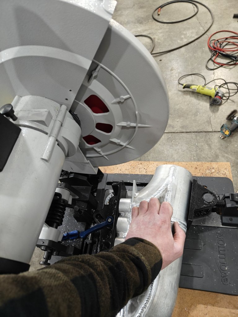

    It's less Tacoma and more mod
    So anyway time to hack it up

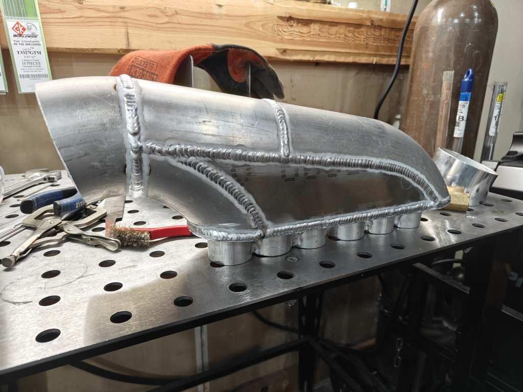

  3. Feb 17, 2025 at 7:57 PM
    Speedytech7
    Feb 20, 2014
    #123587
    58,236
    FCQM+VG Cheney, Washington
    It's a team effort, and mostly @2RZNoShi1's design. The drag truck gets fun goofy stuff because we don't have too many concerns about space constraints and things normal road going vehicles do

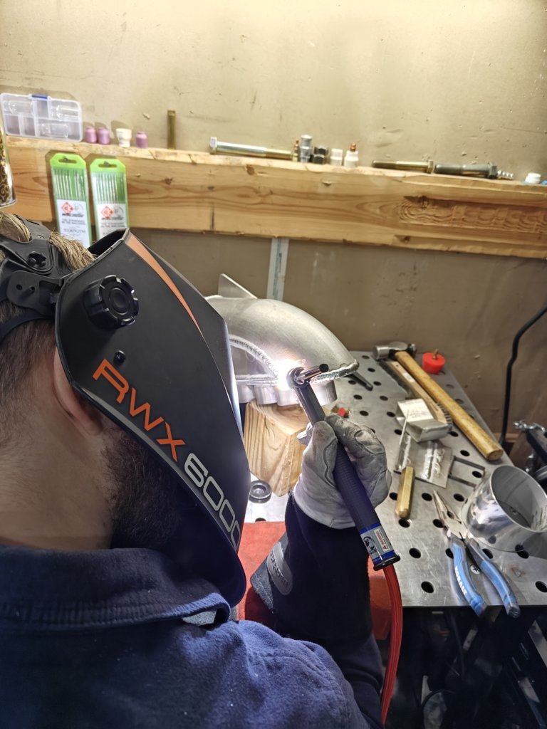

  4. Feb 17, 2025 at 8:07 PM
    Speedytech7
    Feb 20, 2014
    #123587
    58,236

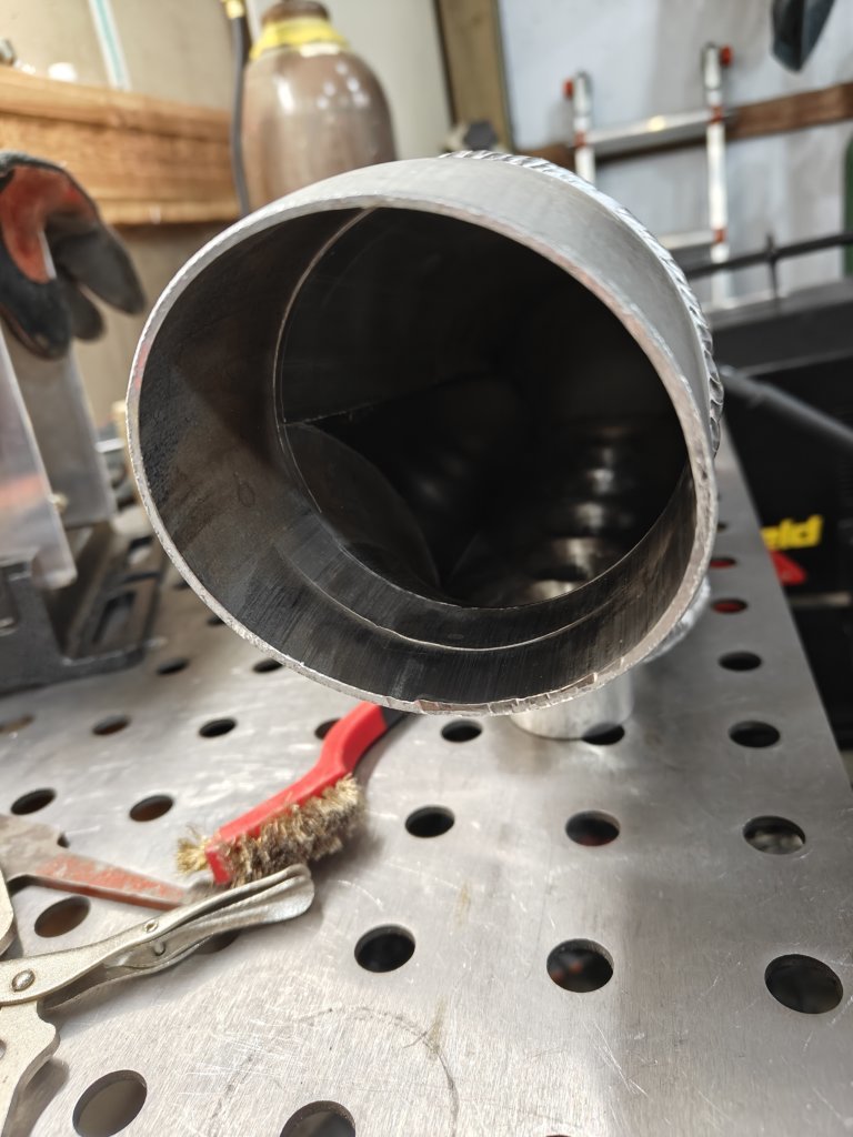

  6. Feb 17, 2025 at 8:49 PM
    Speedytech7
    Feb 20, 2014
    #123587
    58,236
    Final profile looks nice, just have to put in the throttle body flange. Using a 92mm e-throttle from a BMW 540i

  10. Feb 17, 2025 at 10:23 PM
    Running Board Man
    Running Board Man Well-Known Member
    Feb 19, 2017
    #211024
    8,802
    Porque e throttle?
  11. Feb 17, 2025 at 10:30 PM
    2RZNoShi1
    2RZNoShi1 Well-Known Member
    Sep 15, 2024
    #457068
    155
    Jayson
    91 SAS Pickup
    Turbo 2rz swap Haltech 750 3067 pulsar turbo 750cc injectors Solid axle swap 5.29 gears with 35's
    It will give us the ability to do some pretty solid traction control stuff using the throttle body, and we can set throttle limits if the track is less than optimal to change how the truck accelerates. Plus, it makes driving a large throttle body much easier, as you can deaden the response at lower demand so it's not so twitchy and jerky

    I'm probably going to run out of time to make mine, I may 3D print Nylon-X... but thats all I'll have time for I think.

    I wonder how that would hold up? Be neat to see a 3D printed intake but I've seen what the carbon ones do on acceleration, the vibrations and undulations are intense.

    I've been running a 3D Printed intake on the 2GR since I swapped it. it only took like 78 hours and 3kg of material to print lol
    It has endured.

    Why does your build lack all these important details? I want more information, not because I'd 3D print an intake (think boost would make them unhappy) but because I think runner design and priority is interesting.
