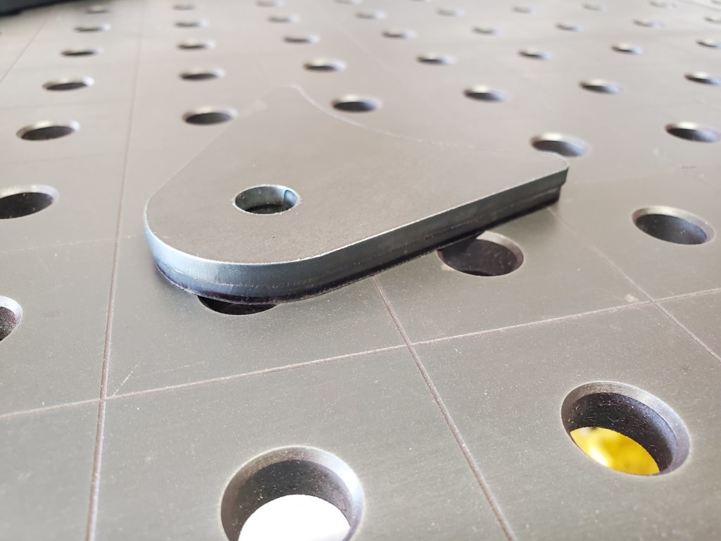

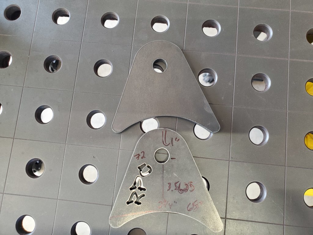

    From time to time, I do wonder if that flat pattern scanner is even worth it
    I get it nearly perfect on the first go around with just a phone picture
    The bottom one with the oblong hole was a customer provided part

    I actually forgot about those :rofl:
    You said you do CAD, I'd just draw it up if I were you and have the boss' kid do it - laser is way nicer plus no shipping

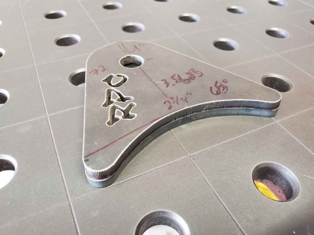

    That's smart, it's flat already and easy to pattern
    A buddy asked me yesterday if I ever take copy of it on the printer - I would think it'd be smarter to scan so all items are proportionate to each other
    The way I specifically made yesterday's part was by taking a picture of it in a specific orientation, then placing a canvas to trace in that same orientation -
    Reason being is that, I can just trace said item easily. Using the X axis as my "floor" though I can then draw the exact angle needed for each side - the left side was 72 degrees and the right side was 65 degrees with the hole being exactly 1" below the radius edge.
    So basically, trace item. Use known dimensions for obtaining specific proportions, and I'm left with something +99% accurate.
    In my case, the bottom left corner is the tiniest bit smaller than the actual piece. It's off by less than I can actually measure, but you can feel the difference with your finger. Way more accurate than it needs to be per the customer as these are motor bike parts he welds on.
    Took maybe 2-3 minutes to measure, then another 2-3 minutes drawing, and doing the CAM work all in one.
