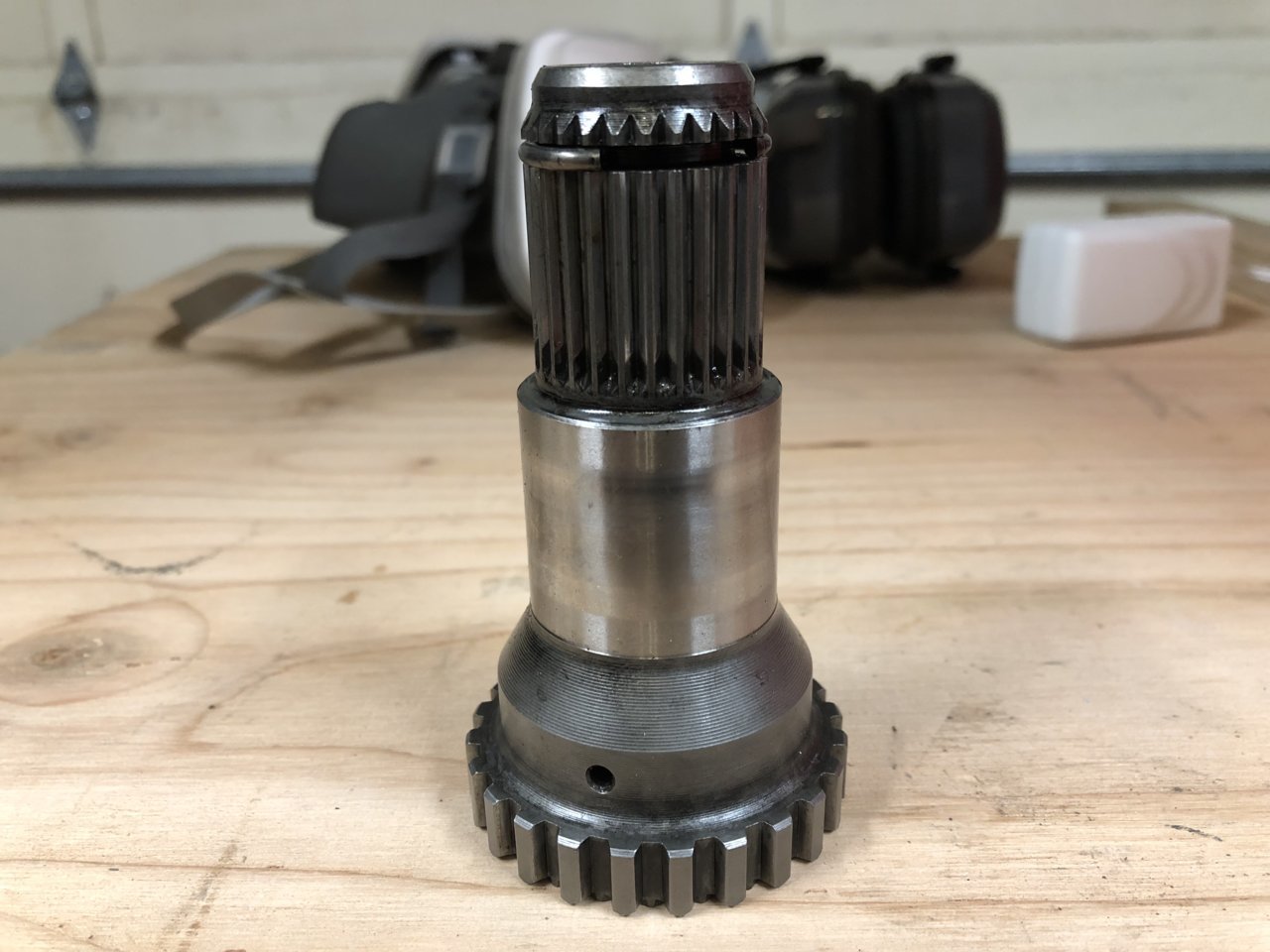

    That thing sucked to removed. I had to use a long socket extension and hammer to pound it out. Some people can do it without popping the clamshell open with pry bars - I say it’s impossible. I tried.

    I did eventually get it without opening the clamshell, but only after doing some damage in the name of learning.
    Coming through the diff with a prying/poking device and a hammer to push the stub out eventually worked for me. It took some time to find just the right screwdriver that would fit around the diff's center pin and contact the stub shaft without hitting the needle bearing. A small/slender pry bar might have been better. I've got a custom-bent screwdriver that I'm going to try next time.
    Splines and circlips give me trouble on CVs too, but I've gotten better at dealing with those. It seems to me that the key is to find the magic orientation where the circlip will slip out easily. I don't know of a secret to finding that orientation--just rotate, jiggle, pry, until it comes free. That's easier to do when everything's held in place in the vehicle.
