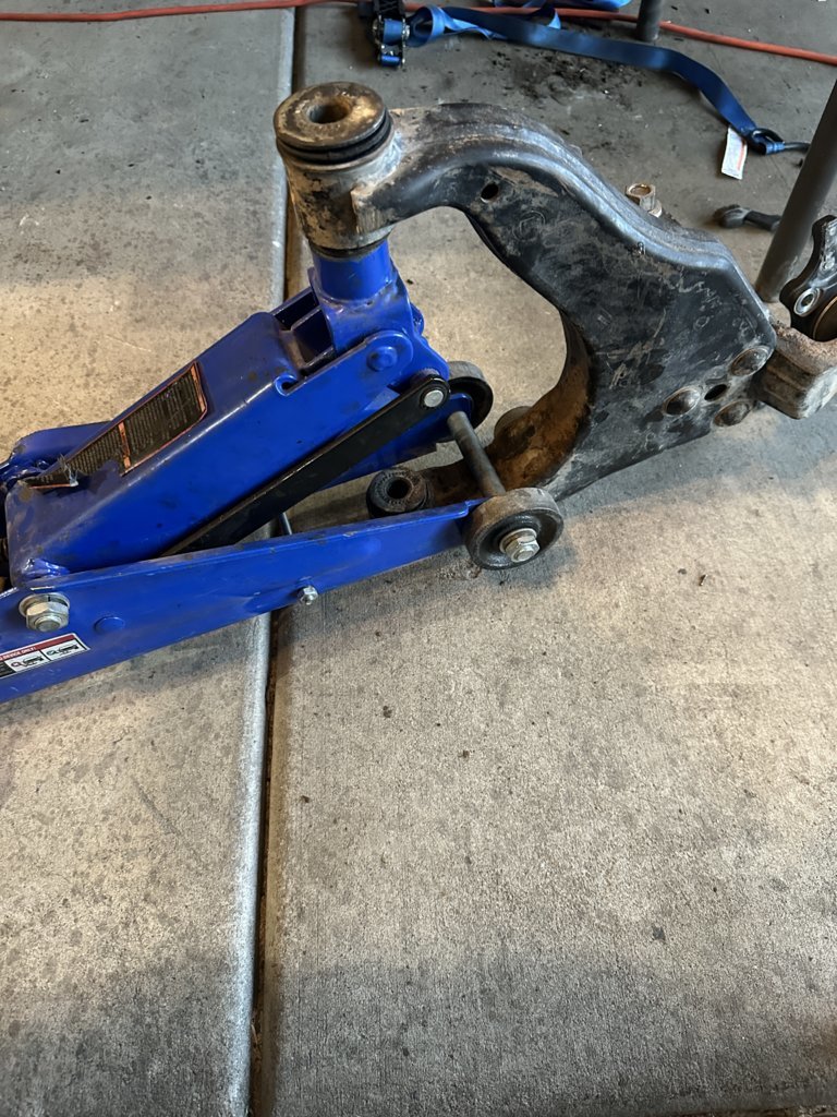

    My genius knows no bounds

    Honestly that looks like it could be better than the bottle jack.
    Just be careful to not tweak the arms. I don't know if anyone's ever actually had that happen, but I threw a ratchet strap around them to be extra safe.

    i can confirm that if theres enough rust the arm will bend before the bushing comes loose lol

    My genius may in fact have bounds
    Instead of the pressure going to the opposite bushing like a bottle jack, the trolley jack is pressing just on the arm at a single point from through jacks axle bolt. Wasn’t brave enough to keep jacking once it got real tight

    They don't come out easy. It's been a few years since I did mine, but I think heat helped.

    Use the factory bottle jack with an appropriately sized socket on each bushing. With heat, one of the bushings will pop out

    My factory bottle jack doesn’t work unfortunately
    I threw the torch on for a while as well, think it just needs more pressure than I’d like to use with how it sits on that jack

    I know I didn't have luck with the factory bottle jack. Maybe I just wasn't brave enough, but turning that screw felt like something was going to slip in a bad way. I used a hydraulic bottle jack.
