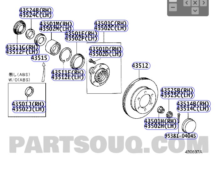

    Thinking about replacing a wheel bearing while I got the spindles out, had one replaced a few months ago and it is very noticeable how much rougher the old one is in comparison..
    Thinking of calling around for some shops that'll just press it out and in real quick while the spindles are out, do I need just the main bearing or do I need to get basically everything behind the hub shown in this diagram

    Good on you if you find a shop that does reliable press work. The one time I tried that I ended up buying new UCAs and redoing the work myself, only after being called an entitled millennial when I told the mechanic I was unhappy with the work and asked him to make it right.

    Damn I was thinking this would be a simple request for a shop

    We came to an agreement in which he refunded my money and I never set foot in his shop again.
    I'm not sure which shops here employ the skilled labor. The ones that looked most promising have all closed over the past few years. Even the well-regarded vintage Toyota specialist in town was a disappointment when I took my truck in there.

    It should be, as long as you find the shop that employs "skilled labor". If you do find that shop, keep a good relationship with them.
