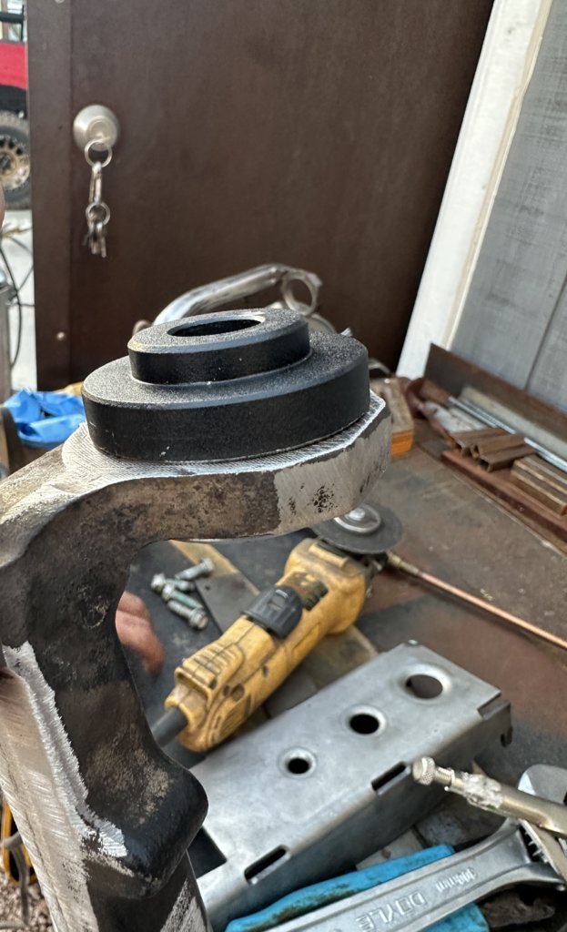

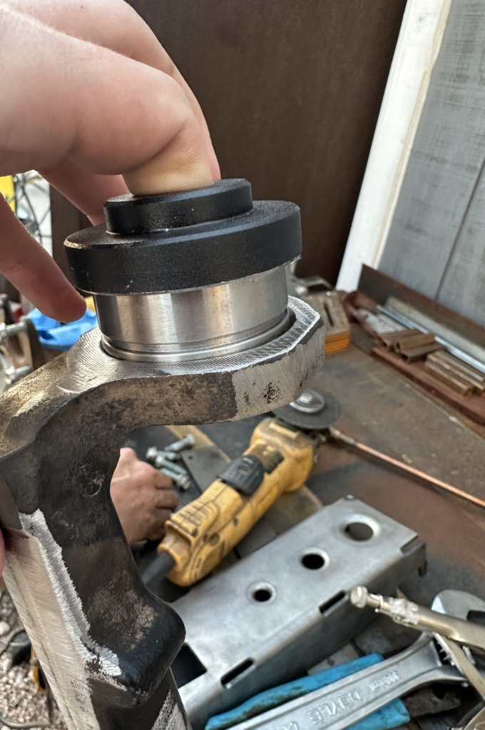

  6. Mar 25, 2025 at 6:48 PM
    time623
    time623 Well-Known Member
    Jun 26, 2015
    #158230
    3,666
    James
    AZ
    1995.5 White Tacoma 4x4
    If my uca ubj sleeve just drops in like this there’s no recourse other than getting a new spindle right?

  12. Mar 25, 2025 at 7:22 PM
    Speedytech7
    Feb 20, 2014
    #123587
    58,395
    FCQM+VG Cheney, Washington
    It's less Tacoma and more mod
    ADS 100% no contest, but that's a huge price differential too. For the price of a pair of locked triple bypasses I can barely have a set of smoothie ADS haha.
    TACOTU3 likes this.
  13. Mar 25, 2025 at 7:24 PM
    Speedytech7
    Feb 20, 2014
    #123587
    58,395
    If it's me... I'm probably welding the slug in to the arm. You can also do the old trick of staking the inside of the bore to create a raised section people used to do that for spun taper roller bearings all the time

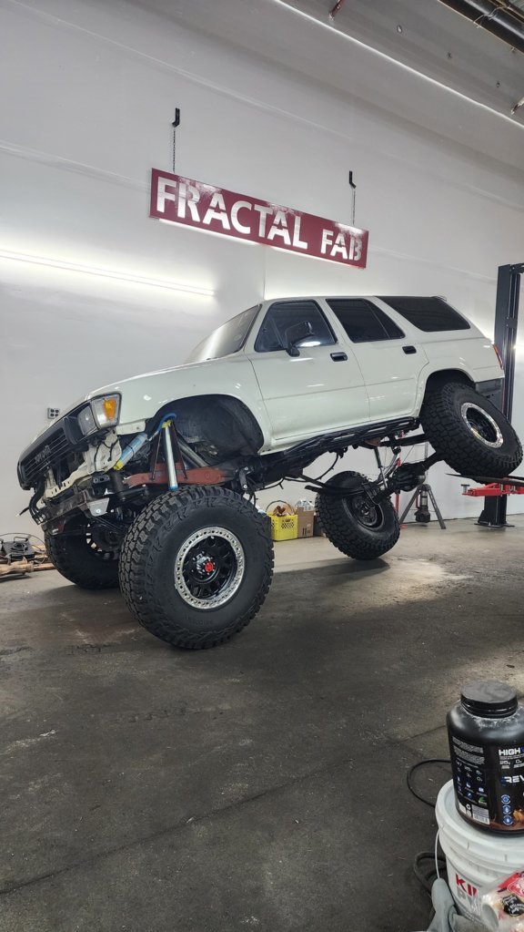

  14. Mar 25, 2025 at 7:27 PM
    Kwikvette
    Feb 27, 2019
    #284735
    82,384
    Fresno County
    4 run, 2 don't
    I don't normally care for 2nd Gen 4R's but man, this one's hawt
    The 63's in the rear really flex
    unstpible and TACOTU3 like this.

  17. Mar 25, 2025 at 7:33 PM
    Running Board Man
    Running Board Man Well-Known Member
    Feb 19, 2017
    #211024
    8,810
    I was a hotshot driver for another company for a brief period before I left after they refused to fix the trailer brakes or replace tires until they blew out... or have insurance
    Don't go with the cheapest quote
  18. Mar 25, 2025 at 7:34 PM
    time623
    Jun 26, 2015
    #158230
    3,666
    James
    AZ
    Are there real cons to welding them in?
    Other than not being able to switch to different ucas
  19. Mar 25, 2025 at 7:35 PM
    Running Board Man
    Feb 19, 2017
    #211024
    8,810
    If the taper is the same between the 2 different studs on the ucas you should be able to swap them no problem
  20. Mar 25, 2025 at 7:37 PM
    Speedytech7
    Feb 20, 2014
    #123587
    58,395
    Not really since they don't bear much load vertically. The only load that they bear vertically really is just the weight of the arm. If it's me I'm just putting a little welds on there though you're not trying to harden the forged steel you're just trying to keep the slug from being loose and the snap ring is really what's still keeping it from popping out entirely
