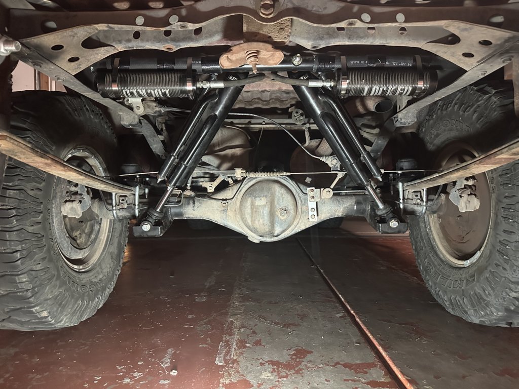

    Going to throw a bunch of weld on there anyway with the gussets
    Thats what we were mocking up when we noticed the slug wasn't press fit
    I mean even if I have to get a new spindle in the future, thats what I'd have to do anyway so might as well send it. Can't believe tacking it in never even crossed our minds standing there lmao
    That spindle has a nearly brand new wheel bearing in it already too

    I'd do ADS all around if my truck was my only project but I'm not made of money and I have lots of other frivolous BS to keep afloat so used King 14" adjustables in the rear and SAW fronts for me still haha. You bet your ass when I do the long travel in the front I'm going to get the ADS though, there are places to cheap out and when you're just cobbling together a mid-travel set up I think it's okay to buy just about anything and tune it to your liking. But if you're going out of your way to abuse things it's nice to know you've got a few parts that are really not going to let you down and having rebuilt a few sets of ads I can tell you they are way overbuilt and it's a pleasure.

    Also this is going to sound like really stupid advice but make sure you're not putting the slug in upside down. Most setups have the snap ring on the top. I don't know what specific arms you're using so I'm not sure if yours are that way I'm just saying to double check before you go welding things into stuff

    Yeah I think it is upsidown in the pictures, was just easier to drop it in on from that side for the pics
