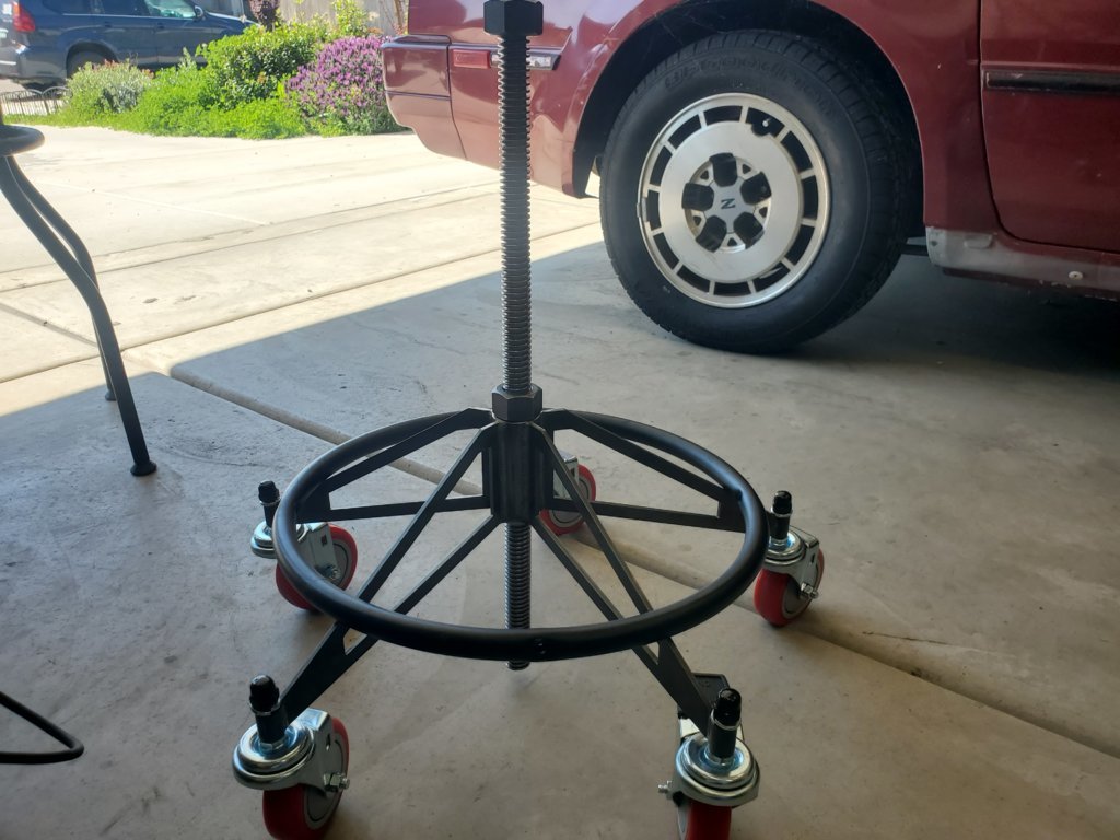

    One tool I can't believe I never purchased is any sort of tube roller
    Would be perfect for making a footrest for this thing

    also would add some weight down low for stability
    the hf pipe roller is decent with some tweaking, and someone sells tube dies for it as well… but sch40 would probably be fine for a stool lol

    The stool will be a lot lower than it is now, but you're right definitely don't want it top heavy
    Main reason for going 5 casters vs 4
    I used 1/8" for the backrest, legs are 3/16" and the casters are big at 4"
    The HF tool I was looking at is $250, so I've been looking at all the goodies Swag Offroad sells for it to see if it's worth buying for future stuff
    Can't find anyone near me that has one or even a Chinese variant of it :bananadead:

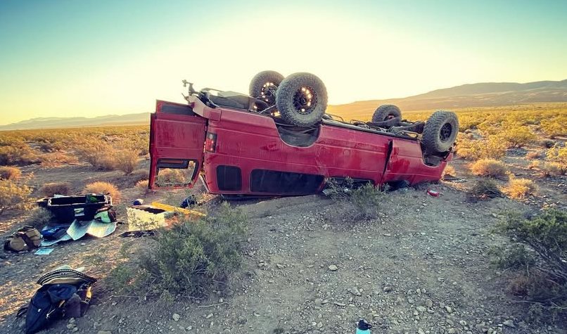

    A lot of it is for roll-over rigidity. As cars have gotten heavier, they need more structure there to support the vehicle if it goes belly up. A good visual indication of this is my old van is of an old design with great visibility, but when you have a 1000# engine sitting under the front seats, if you go belly up, now this A-pillars have a whole bunch of weight to hold, and we'll, they just aren't design for it. If you're lucky you might just get a headache from it. This is a similar van to mine and you can see how the roof just folds under the weight.
    I would love a steel hoop above/behind the seats to help with this one day.

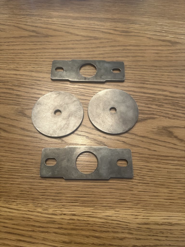

    @Kwikvette they made it!! I started to worry when I noticed they were sitting at the LA pit of despair for over 24 hours again, LOL!
    They are perfect man, thank you!!
