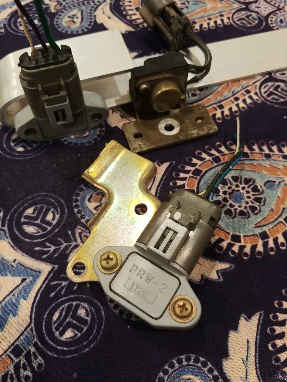

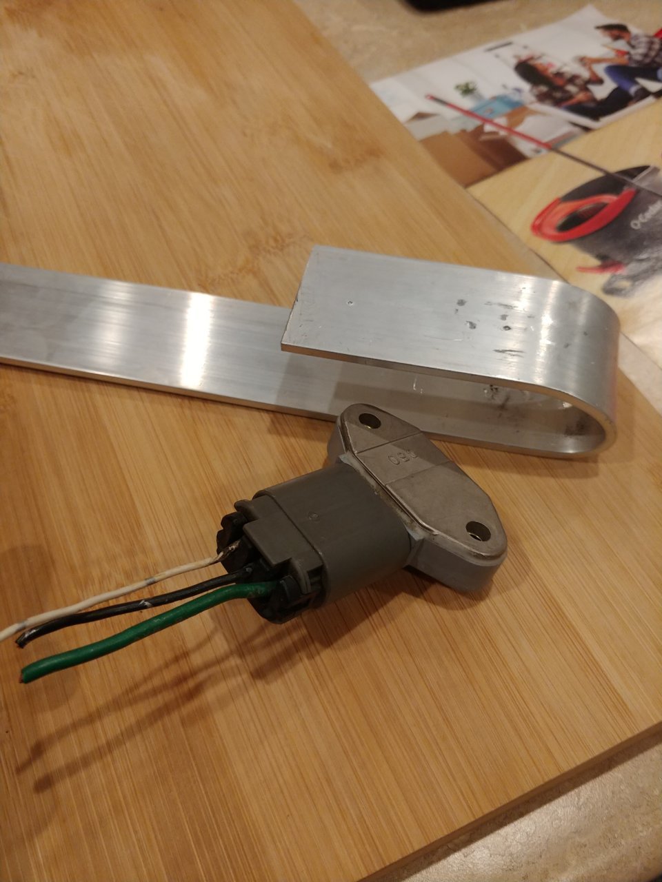

    That little grey guy is the high speed transistor array that fires the coil when the signal from the dizzy position sensor and ECU tell it to. It makes a decent chunk of heat and needs a bracket to hold it in place, so I'm making a bracket out of alum rather than the usual steel
    Space constraints are a bitch though so I needed a 180° bend

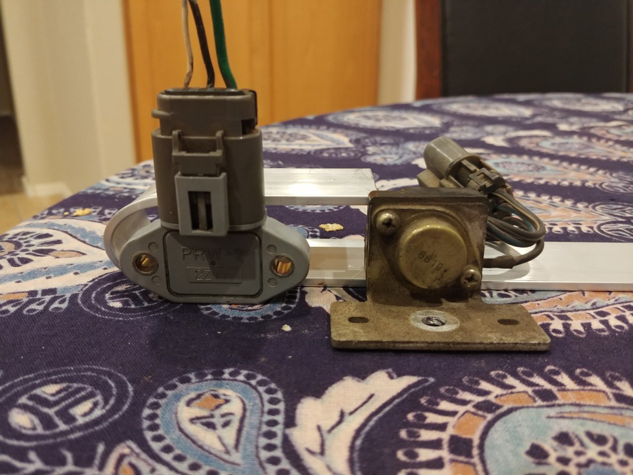

    It had one, but in the early 80s transistors were fine and dandy in radios and such but high speed transistors for high current hadn't come too far yet and the one my car came with is due for an upgrade. The upgraded part however has its plug integrated so space constraints are an issue if I reuse the old heatsink. I took a picture comparing the heights... You can see why I have to mount it to the underside of my nice 180° bracket now.

    The one here is from a Maxima, this is from the Pathfinder, same part tho
