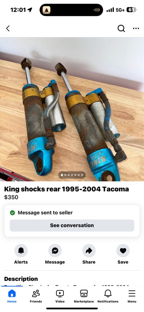

    How much lift are you running in the rear?
    Without knowing the shock's specs, it is impossible to know if you can use them or not. I am assuming that you asked if they were a good deal or not so you could run them on your truck, right?

    I have OME Dakars without the add a leaf. I also have a toolbox that stays back there with supplies/tools/etc. Not terribly heavy.
    Yes, correct. The guy said they’re for 96-04 taco. He got them in that condition from another guy but was never able to install them on his rig.

    The Dakars are designed for some lift right? Your just not sure how much they gave on your truck?
    If those Kings are 25001-153s, and they certainly look like they could be, they are for trucks at factory height. Zero lift. They will be too short on your truck.
    https://kingshocks.com/i-30503928-25001-153-1996-2004-toyota-tacoma-2-5-rear-shocks.html
    Look at the bottom of the details tab for the specs.

    $100-$120 for a seal kit and shock oil. Add labor for the rebuild itself. And that is if the shafts are still in good shape and the spherical bearings are good and you're happy with the shim stacks.

    Yes the dakars are what gives the lift, not the nitro charger shock. Ya I believe you’re right, I see the same thing on shock surplus now. Welp, thanks gentleman.

    I was going with $300 dollar rebuild, 200 for shocks, sell for 900, profit 400

    Or buy new ones for $1,072
    They're stock-length as mentioned earlier so, waste of money

    Someone would buy them, stock length or not
