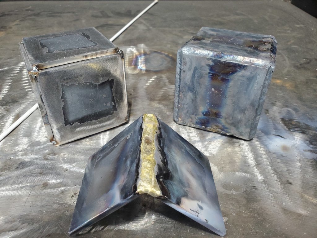

    You gotta catch them before the grinder does!
    I’ll take some pics this weekend :D
    Id say I’m about 70/30 passable vs WTF…

    @TACOTU3
    Just an FYI
    You do not have to use an angle grinder to prep surfaces for welding unless they're rusted, or you're needing to add a bevel.
    Mil lscale is something I've never bothered to remove (and never will) because welding burns right through it; just add a little more heat.
    Good example of hot rolled, no prep, and just running fast and hot -
    When you do use an angle grinder, stick to flap discs.
    Grinding wheels are only necessary when removing tons of material.
    TACOTU3 likes this.

    Thanks for the insight! YouTube university can only take me so far, otherwise I need to see it happen or live through some mistakes…

    @TACOTU3 If you've got a small press at home, you can do your own bend test for testing your welds.
    The simplest one would be a simple open root 1G test where you bevel two thicker pieces of steel, place a landing (a small flat and squared edge in lieu of a pointy edge for weld metal to deposit), create an even gap between both landings, and a strip behind it.
    You would run a root weld, which fuses and fills the void between the two parts, followed by hot passes which are passes the fuse the root weld to each side of the base metal, and cover passes to fuse it all up.
    A visual test is easy, but the real test is once you cut a section or two out and bend them. If they crack/break then it's an automatic fail.
    TACOTU3 likes this.

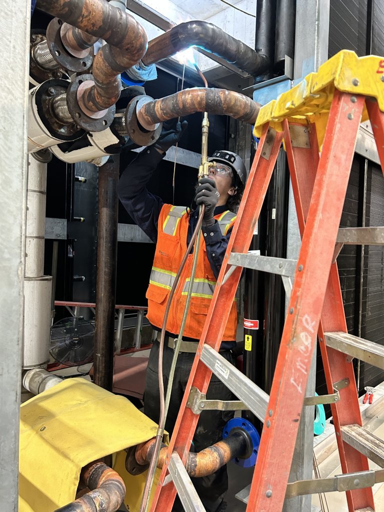

    Mmm brazing. Put my apprentice to the test today on some 3” braze joints
