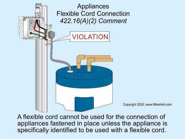

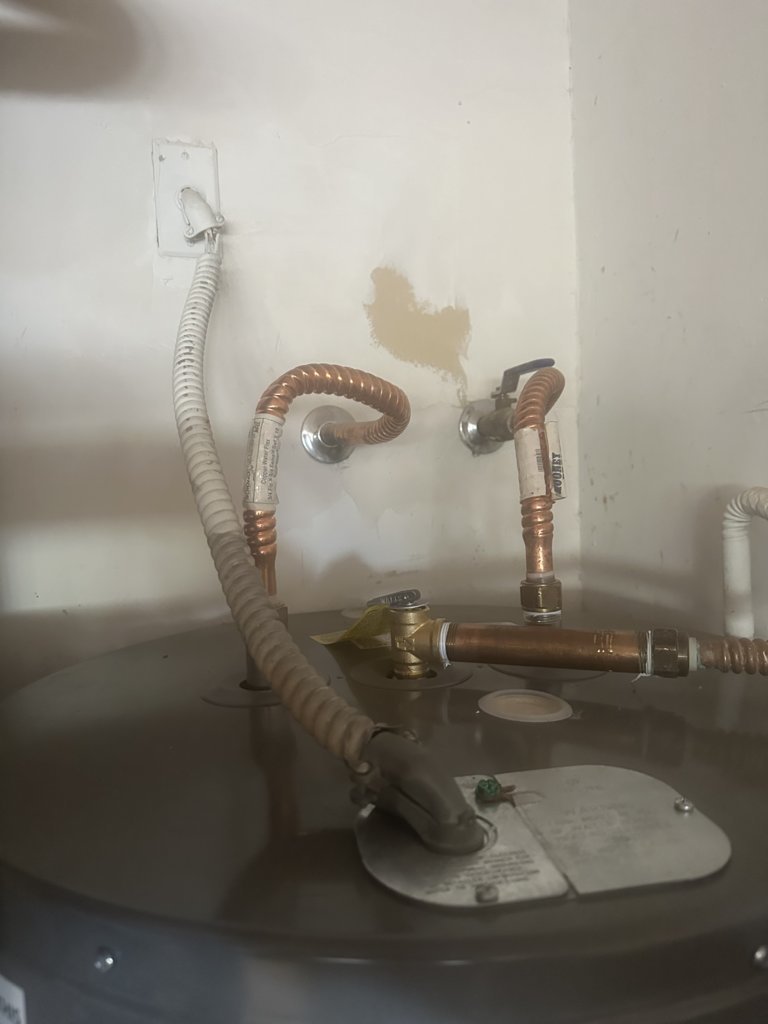

    I'd question if that would be up to code, if you care about that. I've never seen a water heater that isn't hardwired I bet theres some weird reason for it

    I can't speak for code, but I can stay that a plug and receptacle cost a lot more than a service disconnect switch, and most water heaters aren't portable, so for most people it seems silly to do anything other than hardwire it even if the code allows the option (again, not saying it does, I'm curious what someone who actually knows the code will say).

    I don’t see a disconnect switch anywhere so feels like a plug would give that option opposed to flipping the breaker like I did when I installed it.
    Trying to do a little research now but open to any input!
