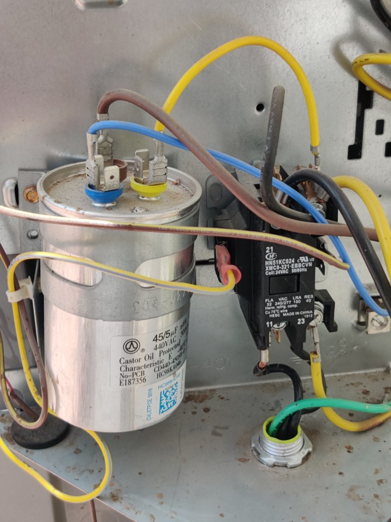

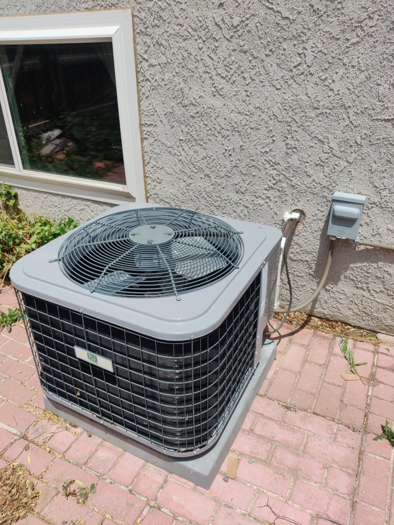

    @Sperrunner you're an AC Expert right? ours decided to stop working at some point last night.
    It's blown a fuse in the past so I checked those first and it has continuity. There's no frost or condensation on the insulated hard line which was another issue we've had in the past (happend when I tried using Merv 13 filters because I have awful allergies).
    Anything obvious I should check next?
    The furnace fan runs like it should but the squirrel cage outside does nothing
    The unit was installed in November of 2019 so it's not super old by any means and I change the filter every 3 months like clockwork

    When you try to turn it on does it hum outside like it wants to start or does it do nothing at all. it is very common for the capacitor to go out and then you’re outside unit wont work

    Are on a call for cooling. Does your contactor pull in outside? If not, you might have a bad thermostat or bad wiring or bad contactor. Pretty easy to check if you are familiar with them, voltmeter

    It's humming outside like it wants to start but the fan isn't spinning. Does that check out for a bad capacitor?
    I assume there's a correct way to discharge the capacitor that doesn't involve me getting sparked.

    My dad recommended manually spinning the fan and then flipping thermostat on to see if that would be enough to get it going and it worked so at least we have AC again for the moment.
    I think that's another nail in the coffin for the capacitor not functioning properly

    That's how I found out it was my starting capacitor - I moved the pulley to spin the motor and it fired up.
    Buuuuut, AC units are pulling way more current so :bananadead:

    Yeah that's why I wanted to make sure to remove the capacitor in a correct /safe manner.
    All though a trip to the ER is still cheaper than having that HVAC guys come out and take a look

    Yeah sounds like a bad capacitor. If you wanna discharge a capacitor just grab a screwdriver and touch the leads on the top together and they will be discharged
