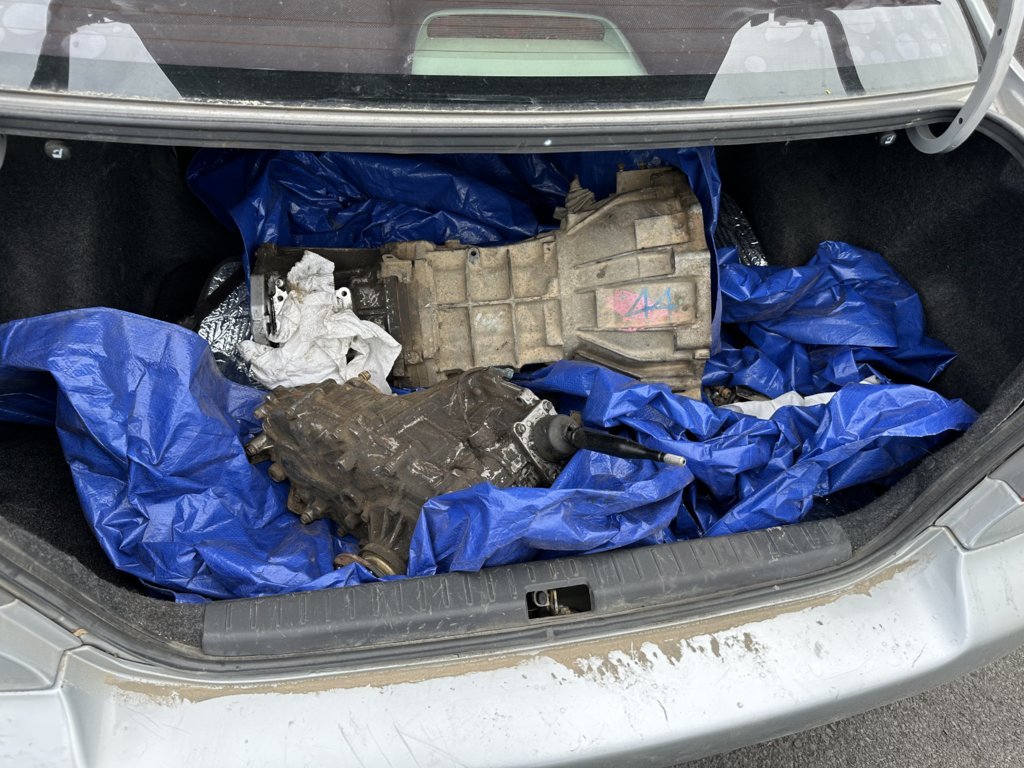

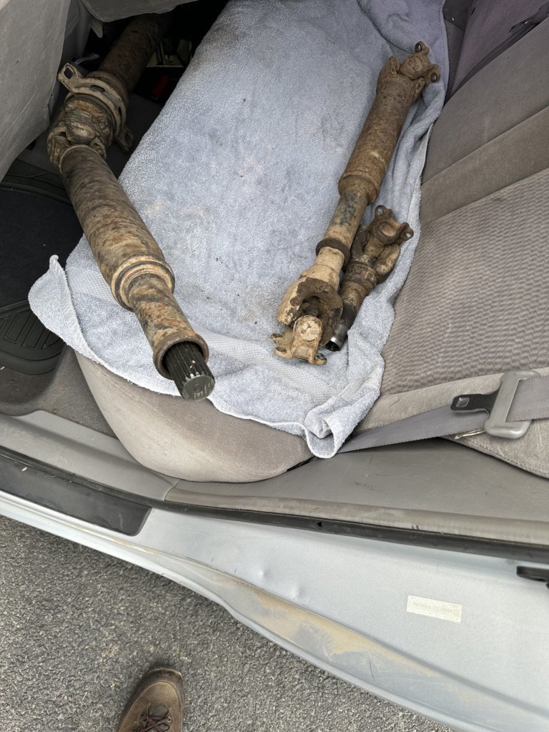

    thanks for the support haha. Here’s the pics of the trans and driveline I posted earlier from the 02 parts truck, just so you know I didn’t flake again lol

    I hope no one’s gonna tell me the trans or drivelines changed somehow after 01, surely those should be a direct fit I’d think

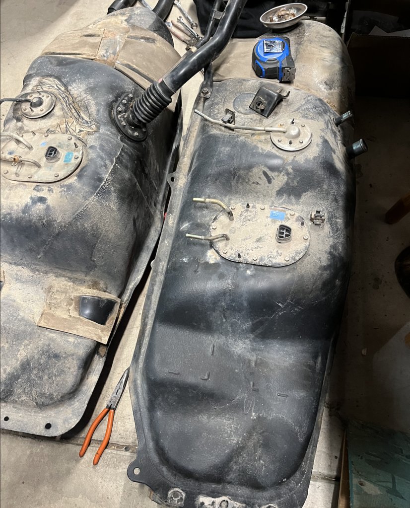

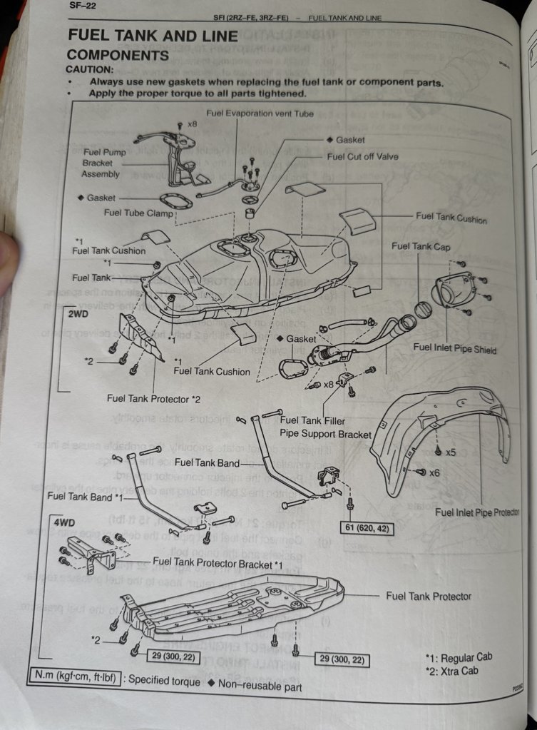

    @Ozark_RegCab I'm a bit late to the party but I do have some knowledge specific to fuel tanks. They're surprisingly fickle in terms of compatibility.
    As y'all have already talked about, 5-lug trucks had smaller tanks than 6-lugs. All 6-lugs have 18 gallon tanks (with gauges that read empty after around 15 gallons used), but not all 18 gallon tanks are interchangeable.
    See the annotations differentiating between "2WD", "4WD", "Regular Cab", and "Extra Cab". This is from my 1998 FSM, so Double Cab wasn't a thing yet.
    As y'all have also already talked about, the fuel line fittings changed from flare nuts to quick disconnects in 2001.
    At the same time, the filler neck changed from a bolt-on assembly with a gasket (similar to the fuel pump assembly) to a neck that slides over a barb on the tank. I think the fuel necks also vary with cab style, because the fuel door is in a different place relative to the tank, but this might be accounted for by differences in the tanks.

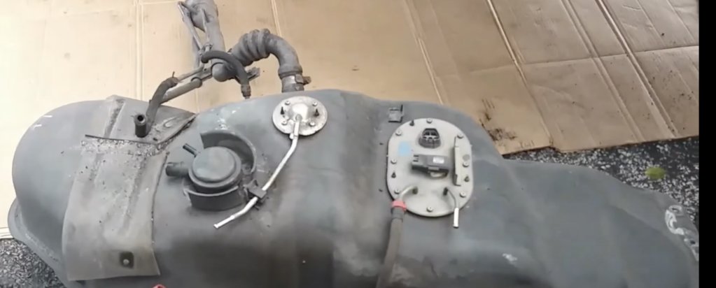

    The last change--moving the evap from the engine bay to the bed--actually happened in 2002. The relocated evap came with an additional vent valve on the tank, so you can't mix and match there. See picture below.
    Here's a pic of my '98 regular cab tank (left) next to '01 extra cab tank (right). I framed the photo poorly and lost the fittings on my tank, but there are soft fuel lines leading to the flare nut fitting.
    You can see the difference in filler necks, which is due to the difference in years. You can also see that all of the lines exiting the top of the tank are in slightly different locations--I'm not sure if that's because of different years, different body styles, or both.

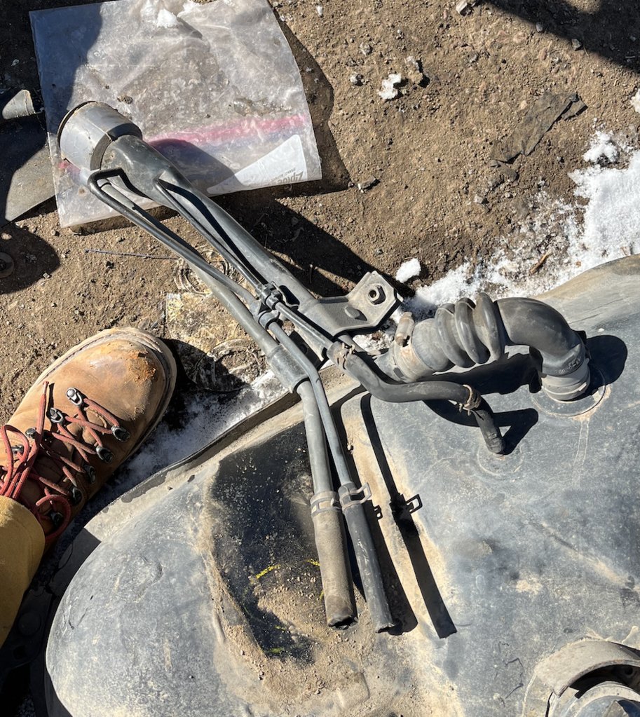

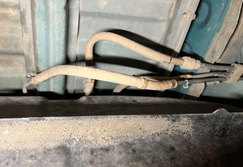

    Here are the lines above my '98 regular cab tanks:
    Here's an '02-04 tank (not sure of cab style) with the extra vent valve visible.
    The '02 filler neck also has more vent/return lines than earlier years.
