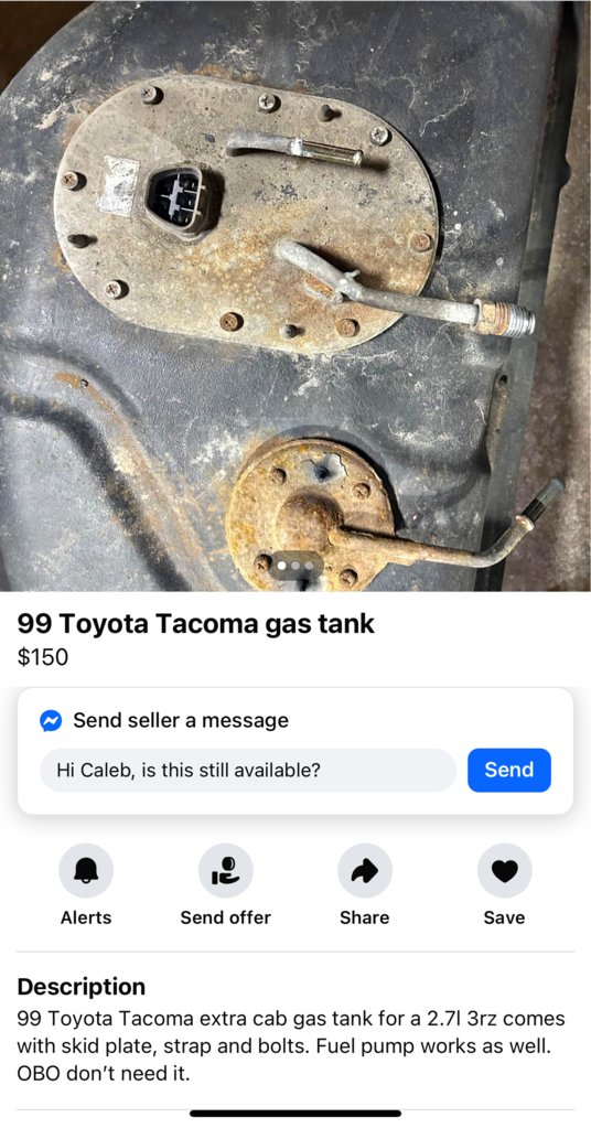

    Hm, there actually is a gas tank from a 99 2.7 extra cab in Rathdrum.

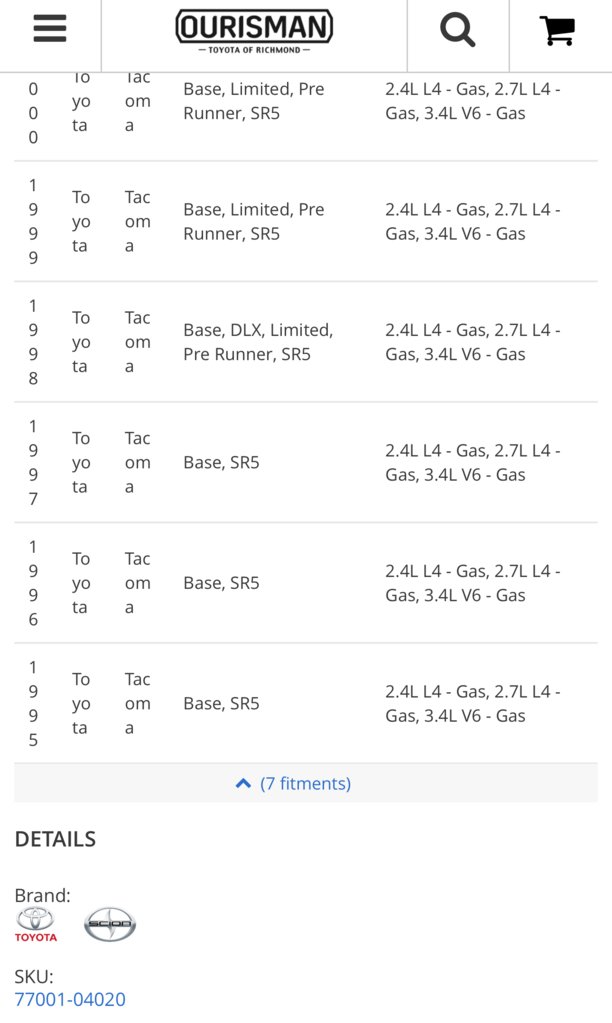

    I’m confused cause Ourisman has the same part no. for 2.4, 2.7, and 3.4 Tacomas from 95-01, so I don’t think that’s right.. it also doesn’t distinguish between extra and single cab. @6P4 do you know if the part number for your single cab is different than 77001-04020? That’s the one that came up when I entered my VIN. Thanks.

    toyodiy.com shows 77001-04010 for my truck.
    It also shows that 04020 is only used in extra cabs https://www.toyodiy.com/parts/xref?s=77001-04020&mU=on
