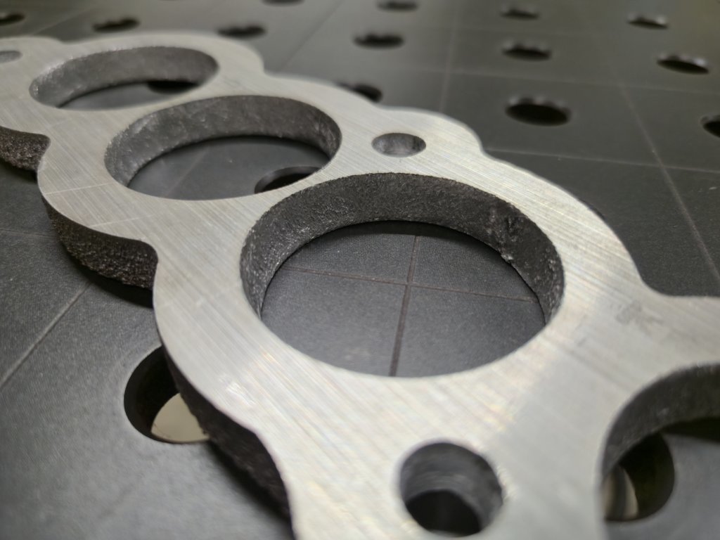

    that looks pretty good, I haven't cut AL very much much, but my edges always look like shit

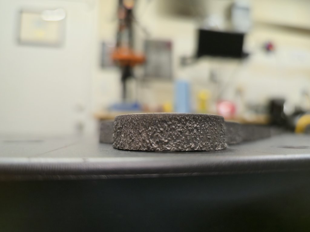

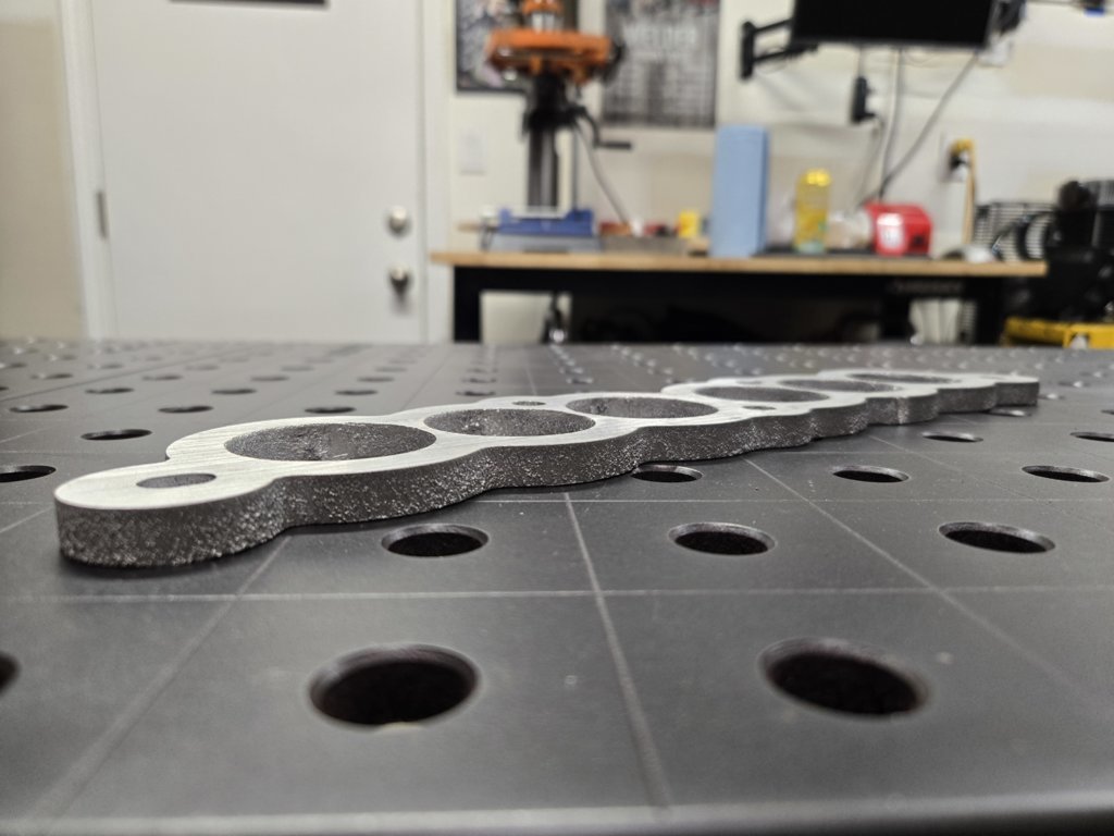

    4 run, 2 don't
    Thanks!
    It's actually my first time cutting 3/8" aluminum
    I tried getting some from one of my local metal shops but they insisted on only selling me by the sheet (4' x 8')
    So I ran this at 30ipm and 45amps
    Unless it's water jet or laser, it'll always be grainy. Though I wonder if different aluminum types will yield cleaner edges.

    I've had success with a short pierce delay but a long lead in to reduce spatter in that sense.
    thats about the same setting I use to cut 3/8, maxes out my machine!! and my edges still don't look even that good, I blame my air lol, not enough room in the garage for a refrigerated drier... and my Wife wants to get an oven to PC stuff

    I ran a 0.5 second pierce delay on this 3/8" aluminum.
    For 3/16" and below I run 0.1 second but that's all mild steel.
