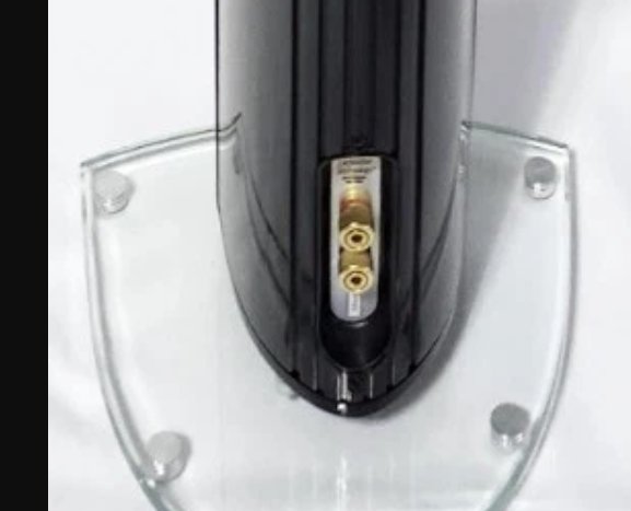

    Speaking of cables, it looks like these happen to come with wire included. But, if theres issues or if I end up with a different setup, are these inputs just regular old speaker wire with banana plugs attached?
    Also, whats the deal with a bunch of speakers having 2 sets of inputs right on top of eachother

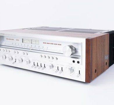

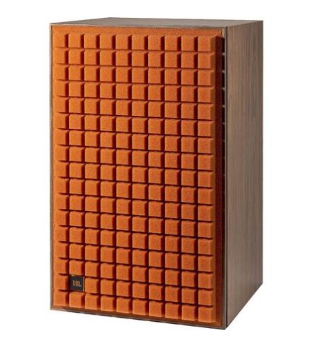

    I made a nice living in that business in the 70s when everybody was getting their first component system. Naturally, the professional clientele had to outdo each other with the biggest and most powerful system.
    In today's money a complete system ranged from $15,000 to $25,000 dollars.
    I remember a guy came in the store and said he wanted a BIG system for parties. He said "I want a lot of WATS and all of the KNOBS." Hell yeah! Actually, the SX1250 was hard to sell once someone figured out speaker efficiency.
    Life was simple when people spent their money on a Cutlass Supreme Brougham and a BIG sound system.
    Then I would get questioned and had to explain why that tweeter radiator didn't spin that the speakers they saw the band using at the club last weekend. Those would be a Leslie.
    Tractor trailer truck loads of JBL L100s and later 4311 Studio Monitors.

    Those look like 5-way binding posts that can accept spades, bare wire, and even banana plugs depending on your speaker wire type.
    When you see two sets of positives/negatives, it means the speaker supports being bi-amped.
    This means in most cases that the mid-range driver and tweeter are paired as "one channel" with the bass driver being it's own channel. The built-in crossover will ensure the bass driver doesn't play full-range sound and people will use their dedicated 7-channel amp to run a 5-channel setup with the fronts each receiving 2 channels of amplification.
    More clean, high-current power the speakers receive, the better they'll sound. It'll sound like a big difference really at higher volumes even.

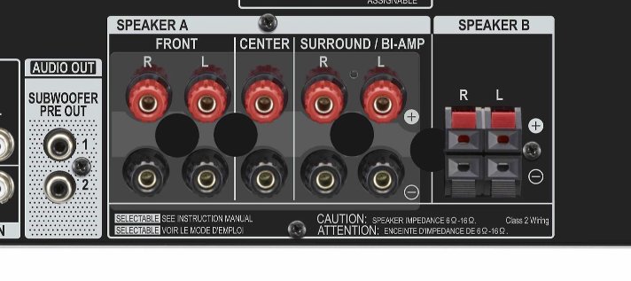

    Ok good to know, looks like the AVR has (less fancy) 5-way binding posts as well
    Last group of questions to bug you with, this is the outputs on my avr
    So the SW preouts, are those just regular old Aux?
    Looks like the surrounds can be Bi-amp, so like you were saying with the 7-channel to 5-channel, I could theoretically use this 5-channel amp as a 3-channel with the fronts receiving 2 channels each?
    And Speaker B, is that just for running 2-channel specifically? Or could I throw a couple speakers somewhere random and control them using this avr independently of the primary living room HT setup?

    Subwoofer pre-out is a dedicated channel for your subwoofer's input.
    Your AVR will allow you to tailor your subwoofer to better implement it with your speakers outside of whatever knobs or adjustments the subwoofer has. A real important one is phase, because an out of phase subwoofer will cancel out bass frequencies produced by your fronts/center.
    As for the bi-amp thing, just don't bother. Not with an AVR.
    If your Mythos speakers do have the ability to bi-amp, you could look into your AVR's manual and see how to properly wire/set that up but I would skip it in general.
    You'll want to make sure you have the "plates" that connect the two positives and two negatives on the speakers themselves.
    Sometimes people lose those, or most times they'll be dirty. Deoxit is great for cleaning such contacts.
    Edit: To add to the Speaker B part, yeah nicer AVR's will allow for separate room listening
