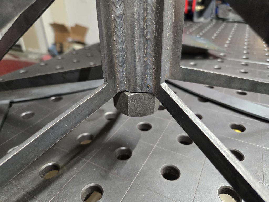

    Dang, is that one of the nuts?
    I've been holding off on that part, but really all I have to do is grind the nut down to weld it inside the tube.
    After which I just need to weld the other nut to the stool mount along with the ACME screw and she's done

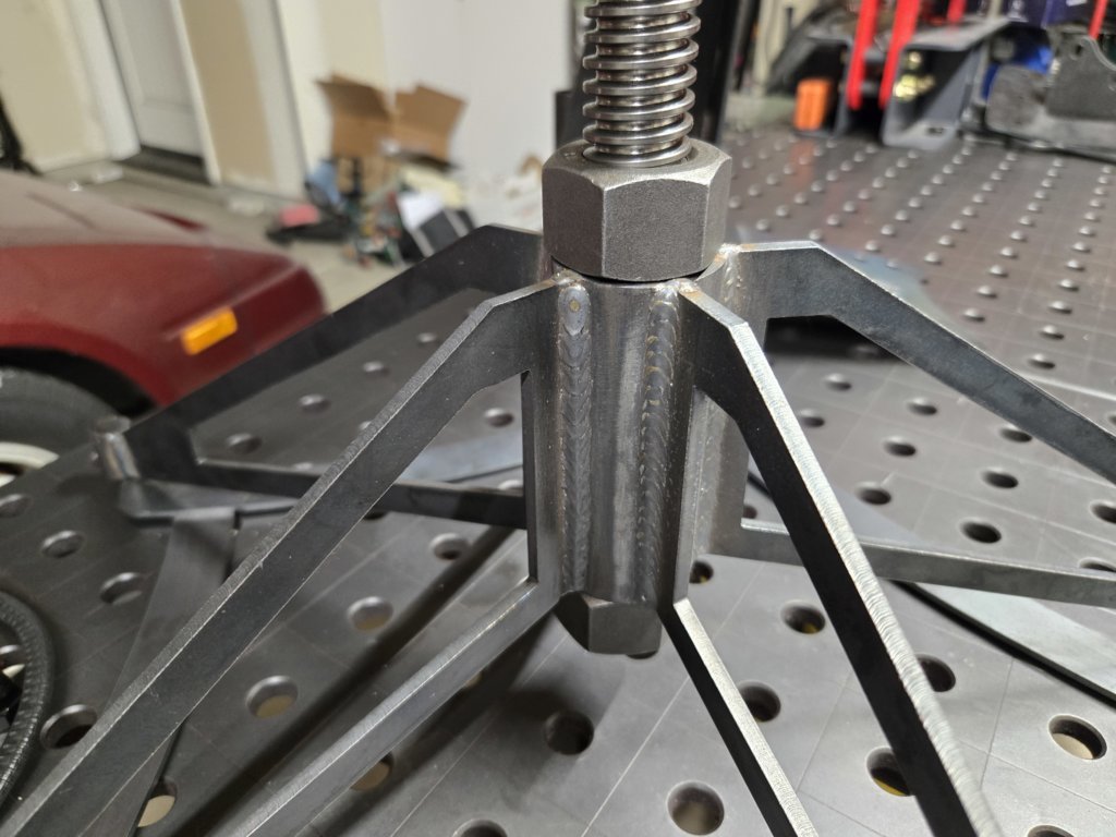

    Yup… kinda makes me wish I’d done a 1.75” tube instead of 1.5”… oh well, it’s done now. Wanted all of my components accounted for and test fit before I really started doing much.

    Why do you have to shave it down like that

    To fit it in the tube that all the legs attach to so it can be threaded, providing height adjustment via acme rod. I stuck the nut in one end and a sleeve in the rest so everything is supported nice and tight from every direction.
    As you know, I am going to be asking a lot of this stool…

    So that nut is the one the acme rod threads into? And its gonna get welded into the central tube, with a sleeve welded in to back it up

    Exactly

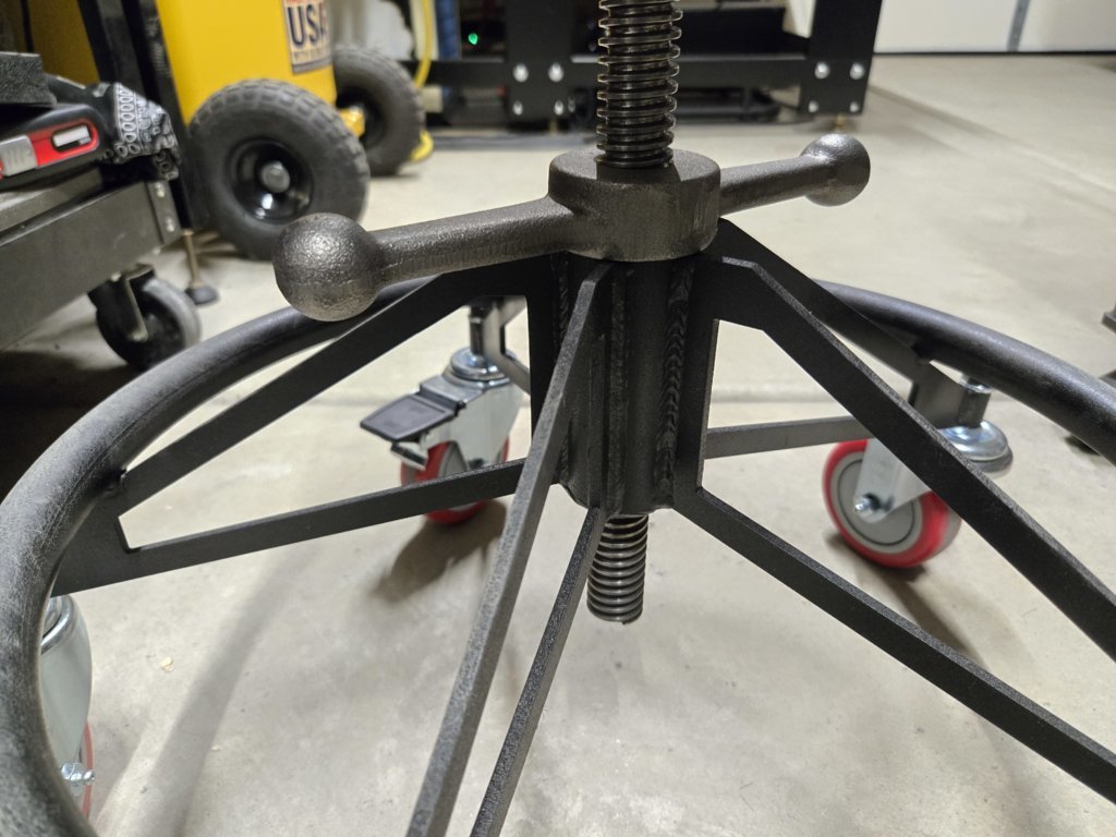

    This nut gets rounded to fit in the tube.
    He's adding additional support within the tube, and wants to use the center tube to provide more strength in the rod itself.
    Way I did mine is I use a handle as a locknut up top.
    In the case for this new one I'm making, it'll just use a plain nut.
    I didn't go with adding any extra support because ACME rod is strong as hell, and the height of the rod is kept to a minimum.

    Why not weld the nuts top and bottom? Still would adjust the height by spinning the seat

    If you want your stool to sit at a fixed position, sure

    Cuz that’s ugly and I’m tryina get laid
