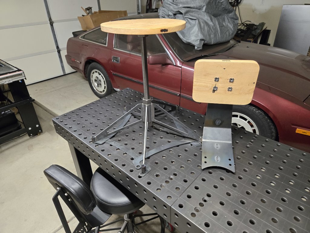

    It wouldn't be fixed, you could still spin the rod up and down. It would just be supported by two sets of threads instead of 1

    I won't ask how much you weigh :rofl:
    I'm 162 - 165lb so, my stool is rated for that much at least
    Other bigger guy on another forum is in the ~200lb region and it works well for him

    Still could insert them into the tube, but with 2 sets of threads with a sleeve inbetween them
    idk just ideas

    Ah, gotcha. IMO would be tough to align them just so, so it still threads through, specially with all the heat potentially distorting it

    Yeah you'd have to have the rod threaded into them to tack it

    [Tell me you're don't weld without telling me you don't weld] :luvya:
    It's already supported by two, one at the bottom inside the tube and one above the center tube as a locknut. That's two nuts the rod is threaded into.
    But if you weld both nuts, you are 99% going to cause the rod to bind leaving you in a fixed position
    Heat distorts, and with how thick the nuts are along with everything else, you really need to get it hot to burn it in properly
    The rod will bind up with both nuts welded

    As long as I don’t snap it in half I’ll let you know, so you can market it as tacotu3 rated

    Ah yeah I see what you mean, warpage could definitely lock it up
