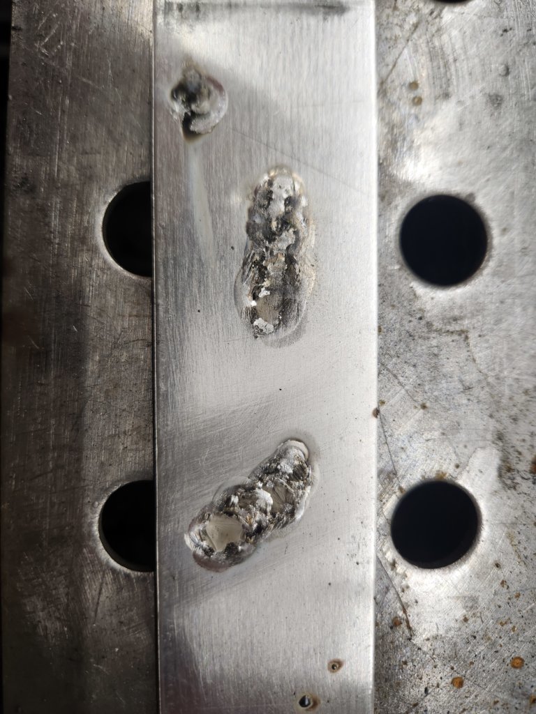

    yeah even just getting a puddle on clean material isn't working, seems like the %EN is set to minimal cleaning? and my dial does not change the weld visibly...
    I've tried 2%Lathanated (blue) and .8% thoriated (white) with basically same results, with balling and without... strangely the puddle looks fine immediately on striking the arc with a fresh grind on the tungsten (with flatted tip ~.050 on 3/32's with 30deg grind
    I'm ~10 years out of practice, but I know the basic steps lol.

    Dang
    Was gonna say I remember it being blue or gold but either of the two should work fine
    Pics of said welds at different balance settings?
    Not that I'd be able to offer much input but maybe it'll show us something you might be missing
    How's the tip look?

    Litterally bird shit.
    I didnt take any pics of the tungsten, and now have ground it. Ive been able to make a consistent ball or keep the tip barely balled, but the puddle formation looks like shit. It did look slightly better when i lowerd my gas flow, which was opposite of what i expected

    I also used fresh scotchbrite after the first test thinking my filler wasn't clean enough.... but this is 4043 into 6061 base

    Aaaaand....the leads are in the correct position lol
