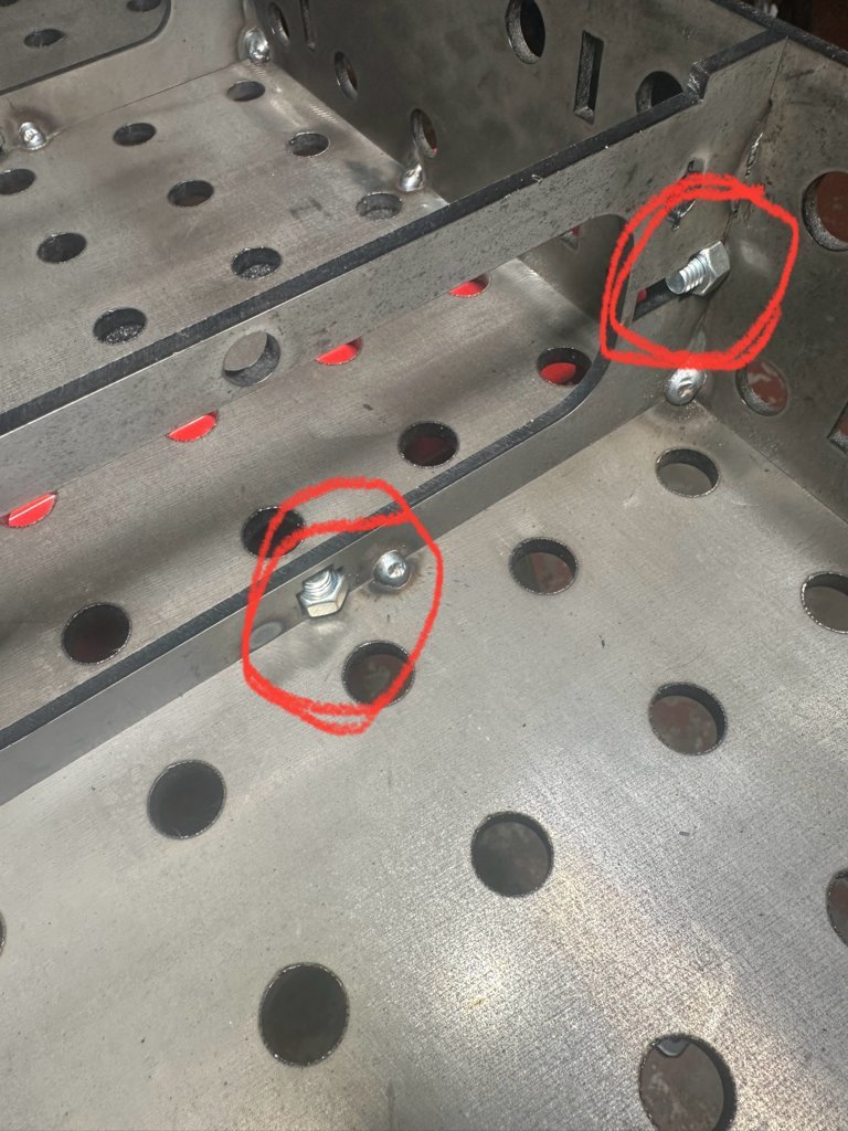

    @Kwikvette Ive got the option to tack in all the assembly nuts before I remove the bolts, so I’ve got yet another option of clamping things to the table. Do you think that’s worth the effort, or are the million existing holes more than enough? Ever wish you had a threaded option?

    I'm not following - you mean thread any of the many holes?
    Naw, never.
    Any and all fixtures have pins in them and you never want to take that option away from yourself. You can always make your own stop or plate or what have you and either thread it yourself, or weld a nut on top if you need something fixed in an odd fashion.

    To clarify, all the bolts that hold it together for assembly just fit into these capture slots. If I tack in the nuts before removing the bolts,, I’ll have a bunch of options on the top and sides to thread a bolt into. Separate option from the regular fixture holes
  18. Aug 18, 2025 at 7:10 PM
    Kwikvette
    Feb 27, 2019
    #284735
    82,383
    Fresno County
    4 run, 2 don't
    Ahh gotcha, that's a very smart design I dig it

    TACOTU3
    TACOTU3 Well-Known Member
    Jul 29, 2021
    #372633
    1,493
    2000 Xtracab V6 4x4 TRD
    Right!! That’s the reason I picked these guys! Adding some clamping force and allowing for some adjustability gives me a legitimate shot at decent flatness.
