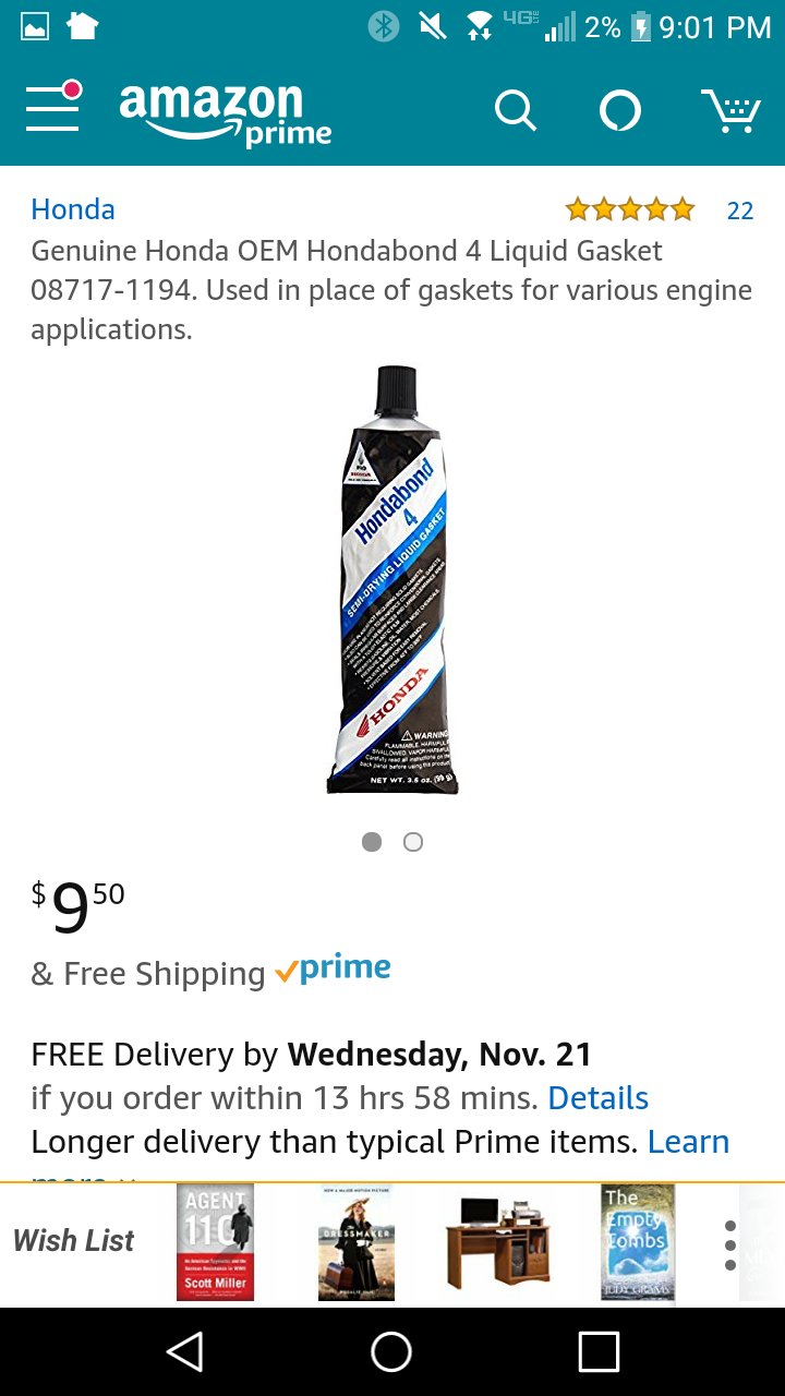

    Im seeing 9ft lbs on the valve cover bolts, that sound correct? Ill be able to wait an hour or more to start it as I plan to do this on my Christmas break. Rookie question, but I dont need to drain the oil to do it, do I?
