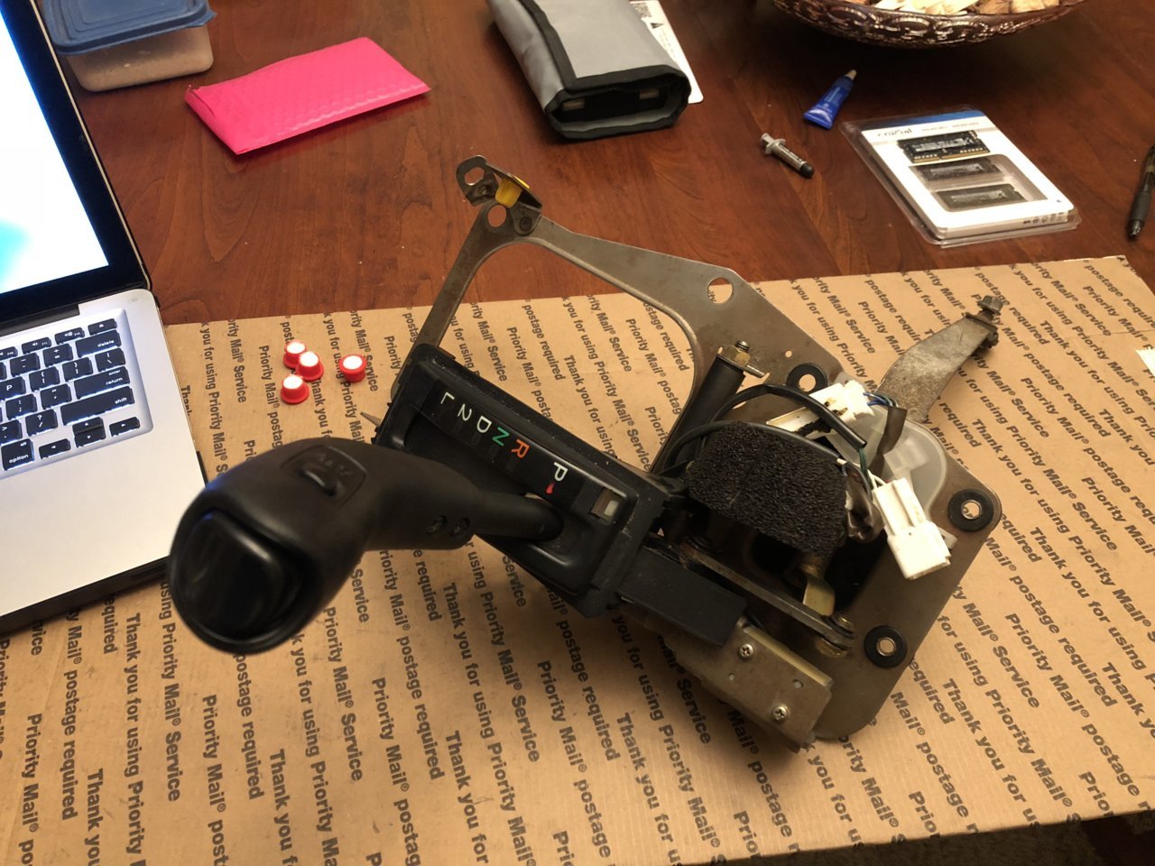

    It's easier with it out of the truck.

    It's less Tacoma and more mod

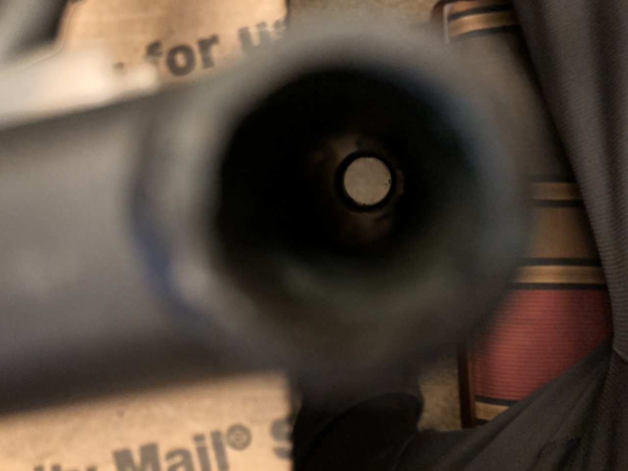

    Wow. There is no bushing left in this thing.
    As in I cannot even find remains of the bushing. The tube is hollow.

    Lol, the do wear out. My cruiser had them replaced and its like shifting a tank, no slop just big thuds into or past each gear.

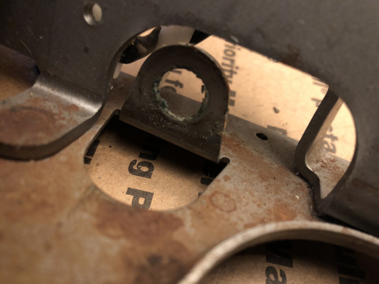

    No wonder it kept popping out of gear.
    The bushing is gone. As in it never existed.
    Or maybe this slight residue on the pin hole is whatever is left of the factory bushing.
    4Runner I pulled it from had like 300,000 miles on it.
