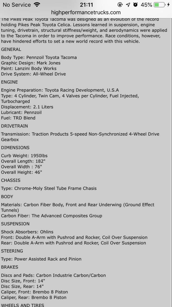

    It was a great engine. it was built for endurance. i believe it was originally for the Group s mr2 and when group s was scrapped ended up in a lemans car. Then in the pikes peak celica and taco
