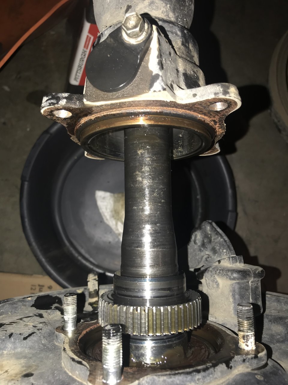

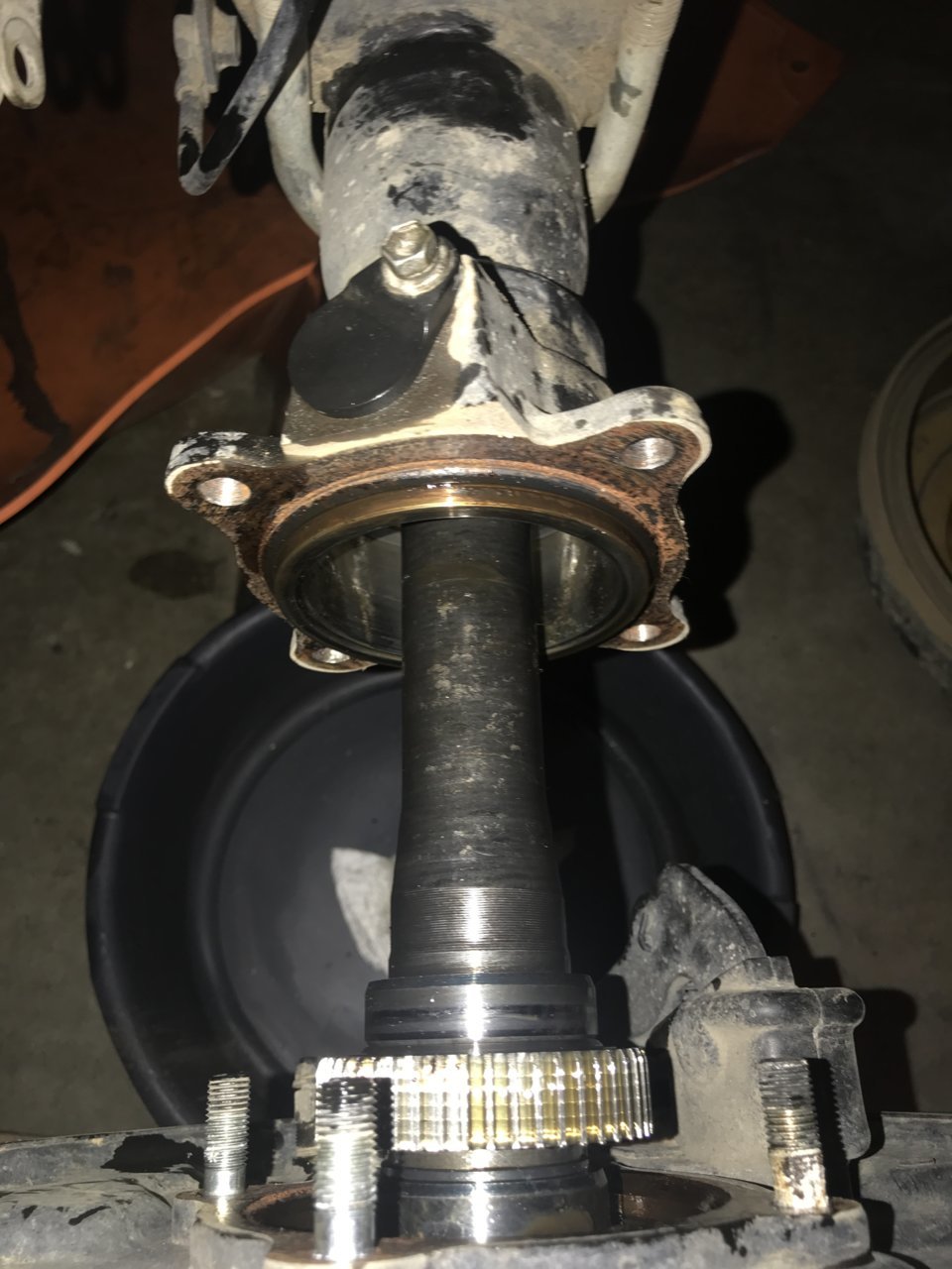

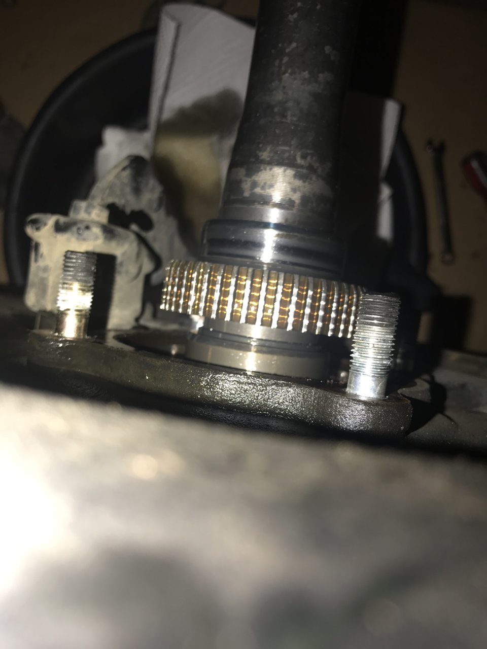

  12. Dec 10, 2018 at 10:36 PM
    BlackPearl
    BlackPearl Well-Known Member
    Apr 17, 2017
    #216527
    1,362
    Alex
    Toyota Tacoma TRD
    3” lift. Sway a ways 2.5 on 285 75 16 and much more
    I pulled out my rear axle and my 02 non abs tacoma and it has an abs tooth ring?
    Anyone come across this? Looks like someone capped off the sensor. I got a kit for the non abs. Can I jus install that and toss the abs ring tooth or do I need to get the abs kit?

    Do you have a elocker?

    All e-locker axles have the ABS tone ring.

    All e locker axles have the tone rimg even if the truck doesn’t have abs. The housing requires you to run the ring. You dont need the senors though

    You need the ABS ring to keep everything in the right place unless you can measure and make up for the missing width somehow.
    http://www.lowrangeoffroad.com/01-0...ra-ultimate-rear-wheel-bearing-kit-w-abs.html
