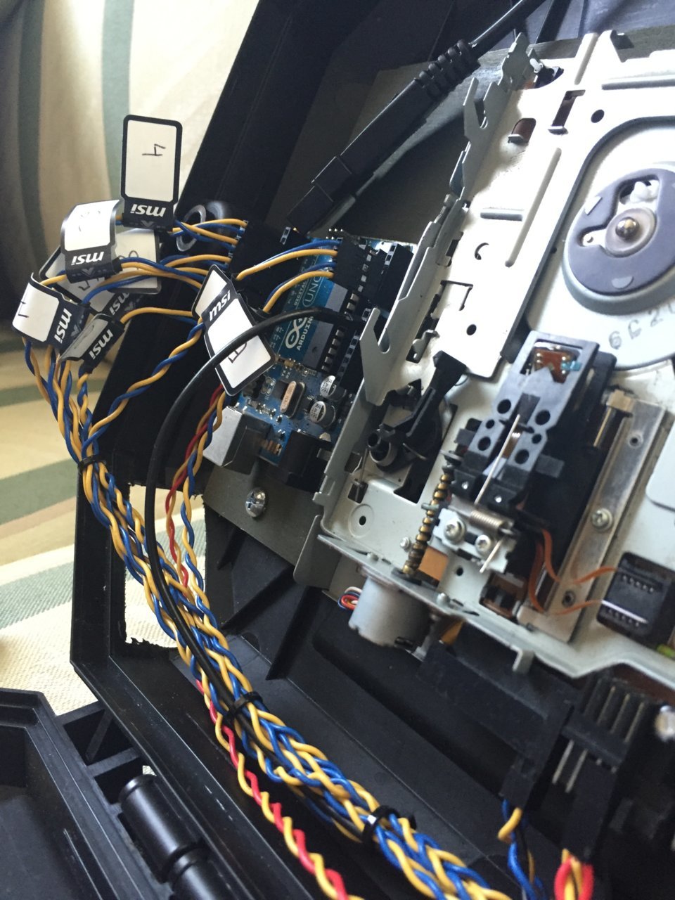

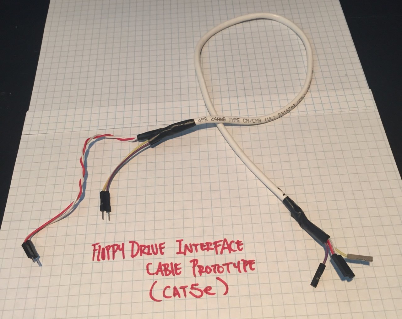

    CAT5 is the best cable ever. You can use it for damn well anything you want.
    You can use it to run HDMI, or integrated control systems, control remote equipment, or blah blah blah.

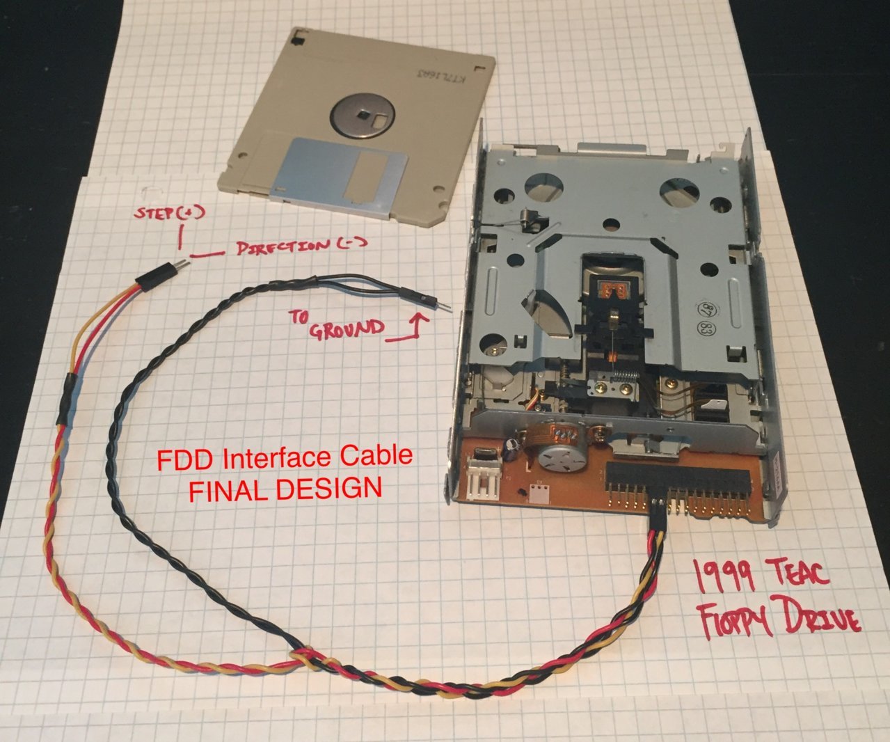

    I used some CAT5 to make a prototyping harness for my musical floppy drive array.
    Here’s what I ended up. I braided 24AWG stranded wires, and used DuPont connectors.

    Should have adapted the female side and used the pre assembled cat5 male/male rj45 cables as interconnects

    Oooh that’s smart. Haha.
    Those DuPont connectors worked pretty damn well. Exactly what I needed for my purposes.

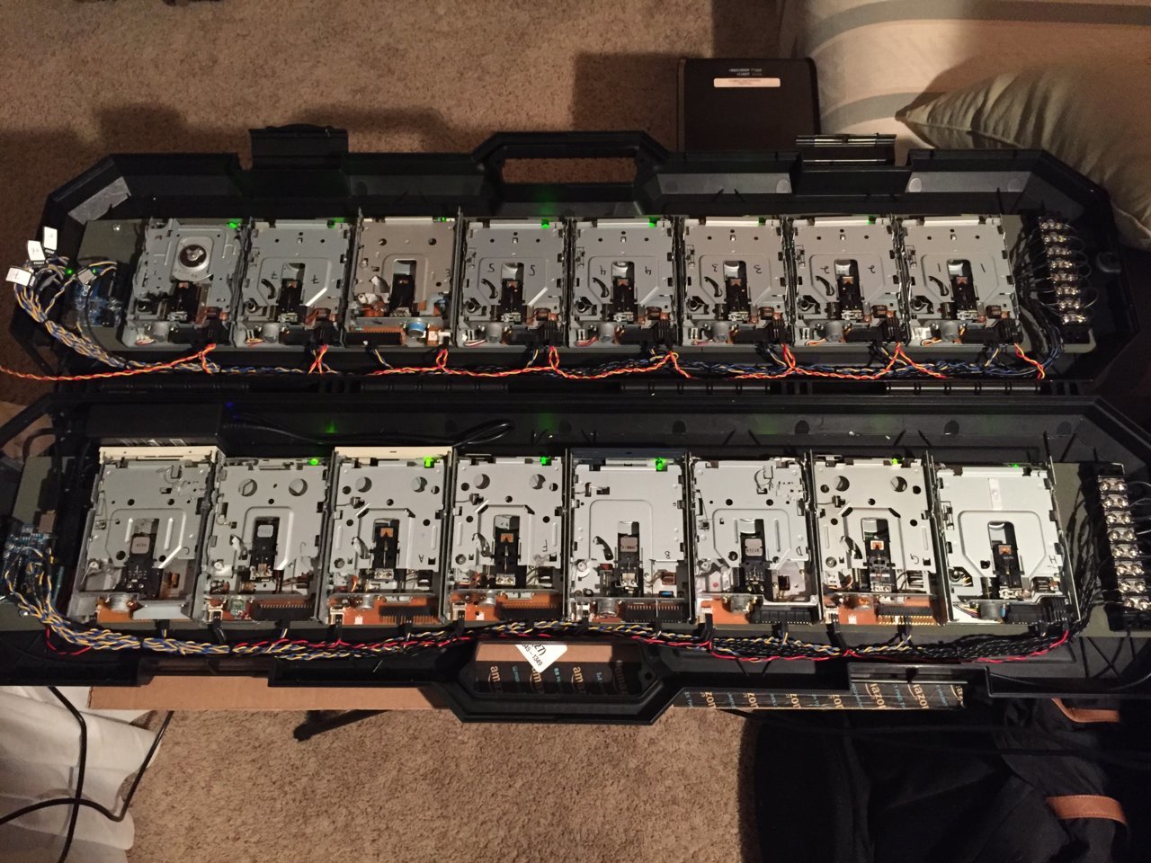

    Looks like a lot of it was Daisy chained, if they physically touch you can cheat and use pogopins or little spring contacts

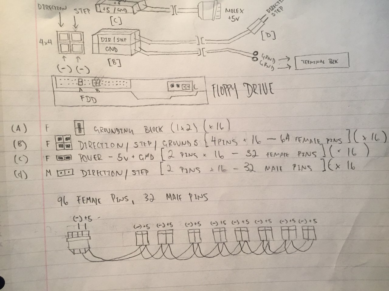

    Each floppy drive had two individual pins on the Arduino. One for the stepper motor Step instruction, and one for the Direction instruction. I had two Arduinos running eight floppy drives each to make a total of 16 to max out each track on the MIDI scale.
    Only thing daisychained is 5v rail power. Not proud of that harness, could’ve done better on it. My blue and yellow harness though, hnggggg.

    Yeah that one is tuff, haha. Braided cables look so beautiful. I could’ve saved a lot of wire and time by just running it straight with some zip ties, but that’s no fun.

    Yeah I'd just use ribbon cables for that

    I had a whole box of IDE/PATA cables I could've used.
    But it's ugly. Damn ugly. I brought this thing to fairs and shows and shit so I wanted it to look good.
    Walking into my high school with a rifle case probably wasn't the best idea in retrospect. The outside of it looks like a gun case, and the inside looks like a bomb. Haha.
