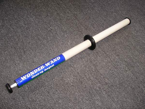

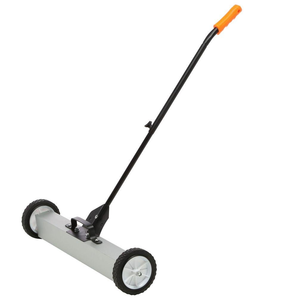

    Yeah dust collector shouldn't be used for metal. In my garage I get chips all over the place when machining. I just sweep up the bulk then use a shop vac to vacuum up the rest & off my machines. I like to use dry drywall/filter bags inside my shop vac, easy disposal, plus most of my chips are oily so they keep the shop vac clean.
    Another option if you have a wide open area is to use a magnet sweeper. They also make handheld magnet wands too. I'm sure I have way more problems with chips & metal shavings than you & I don't even use those. I have been wanting to get me a handheld magnet wand but of course those things only work on ferrous metals.
    HF sells them, not sure how good they are though. They also have a cheaper one for only $20 but doesn't have a release I think. buffalo-tools-specialty-hand-tools-mpsweep-64_.jpg Safety_magnets_01a_Wonder_Wand_600w.jpg

    When i was a kid and my grandpa had the roof redone he would pay me per nail I collected around the house. So i would walk around with a strong magnet attached to a string amd just wave it everywhere collecting nails that have fallen. Later on i found out about thT rolling one you pictured and i wish i had that instead lol
