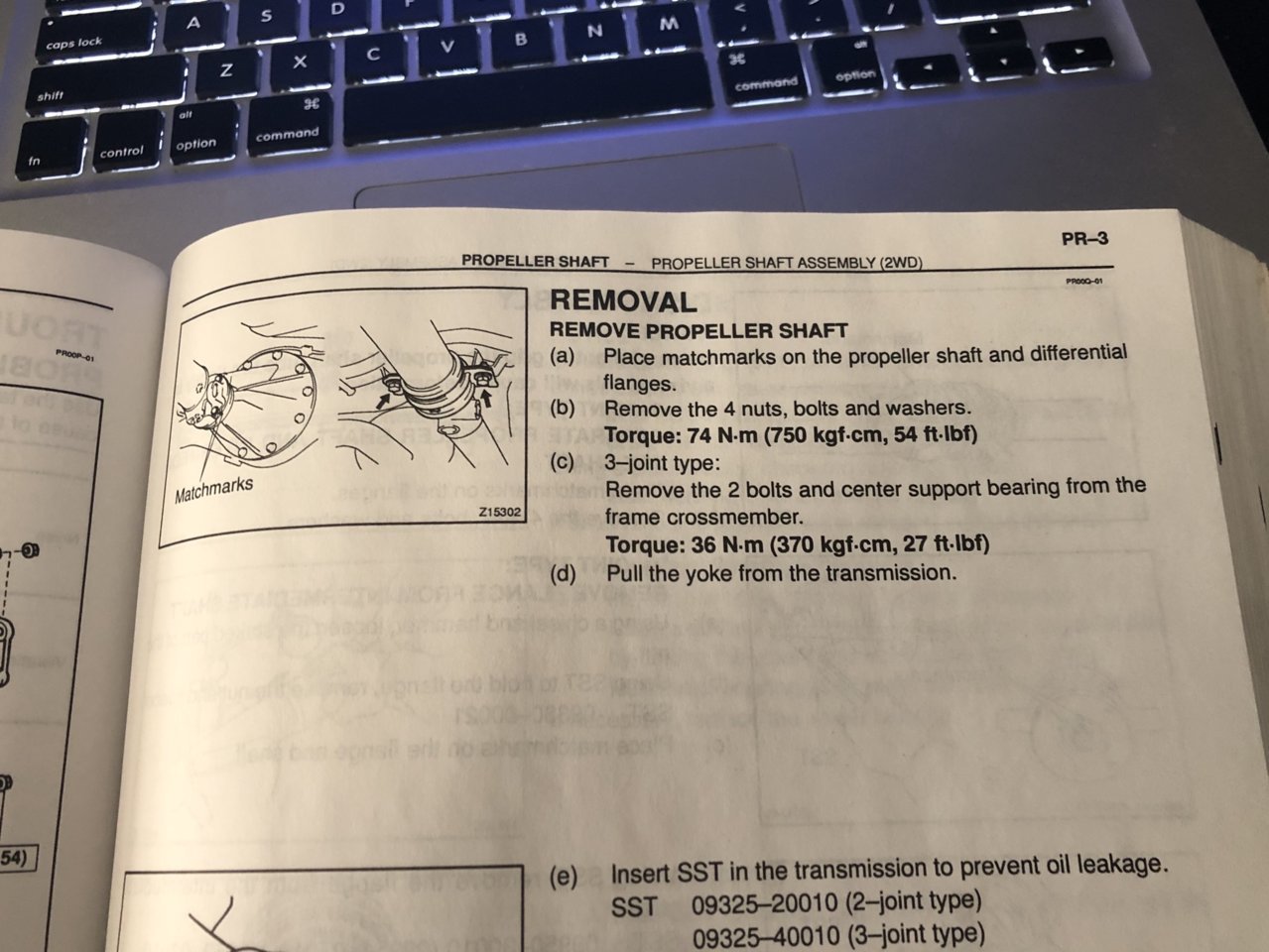

    Still sitting on my desk in SF, totally forgot.

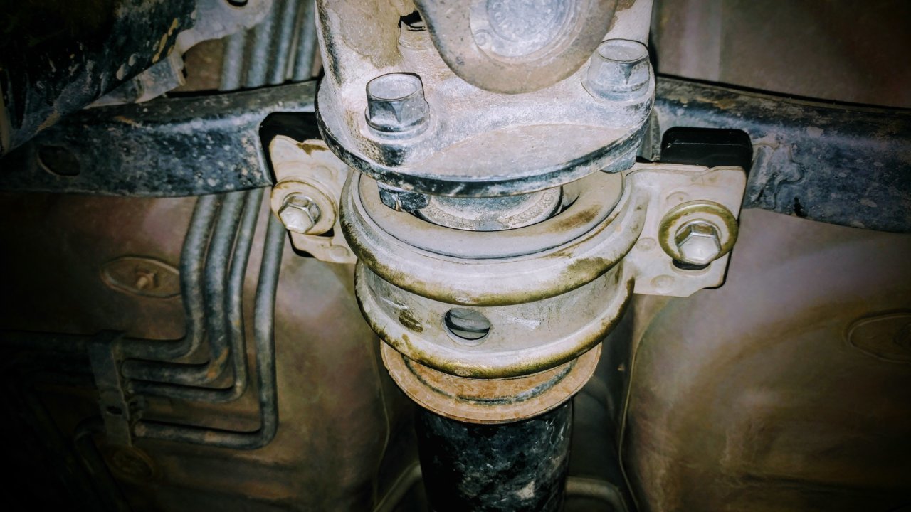

    2 ugga duggas. I dint torque em. Just tight with a ratchet plus some

    It's less Tacoma and more mod
    Tight, 25-30 is a good general for that size bolt into steel

    You nailed it. 27 ft/lbs

    Damn now that's service lol, thank you sir

    Glad I asked because I wouldve set the torque wrench to 85 ftlbs or so...felt like those bolts were on there a lot harder than 27 ftlbs but they we're probably just stuck a bit from never being removed before.
    Got my little carrier bearing spacers installed...didn't really have any issues but back when I was getting some bad clunks I thought this might be what was needed. Installed them anyway for good measure.
    They were being sold on Wheelers for 2nd gens but they fit our trucks too, same size bolt and hole anyway. Pretty simple just little rectangular 1/2" metal spacers

    Did you do the weird torque procedure for the carrier bearing but?

    No...should I? I didn't touch the carrier bearing really, just took the 2 bolts off (one on each side) one at a time and slid the spacer on.

    Oh I thought you replaced the bearing. Unless you took the main nut off, don't worry about it.
