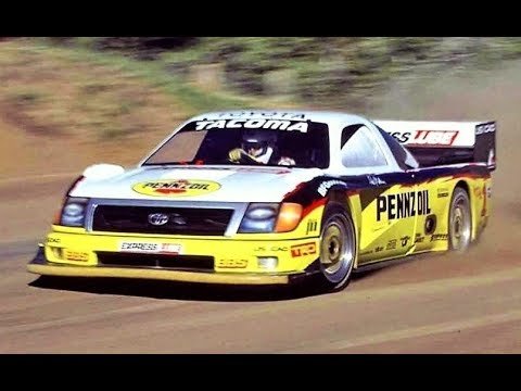

    Probably be a beast on pike peak

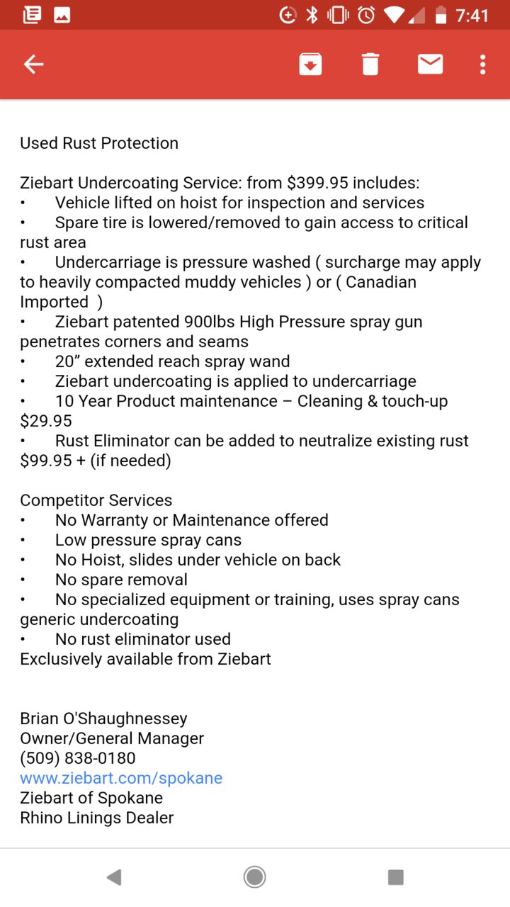

    They spray everything down the ad said and clean it up. Drop the spare tire and do the whole underneath. Sounds like a bunch of advertisement hype to me but who knows.

    You going to the Zibart at the beginning of division? Really you'd be better off cleaning your frame and fluid filming unless Ziebart has changed to a more oily type spray in recent years. Rubber undercoat is a recipe for disaster

    Be as cool as this

    I love how they stretched the ugliest frontend like a texture in a bad videogame to make it "a Toyota"

    Just shopping around. I know everyone's a fluid film fanatic. Toyota sprayed my frame way back in the day under the recall and there is still a little bit of it left. Is the rubber stuff that bad?

    Yeah it is never perfect and traps moisture behind it then rusts your frame faster. It's been crap since it was first brought about in the 1950s. It's a scam and I guarantee you the only reason that particular Ziebart is in buisness is because they do bed lining and there isn't enough salt in the area to be a problem. Find a place that does Krown coating or fluid film yourself. Hell even bar and chain oil and a spray wand is better than rubber undercoat.

    That front end so ugly that when dount media did a video about tacoas they went fro 95-97 to 01-04. Didn’t wanna show 98-00

    That's the ugliest Tacoma I've ever seen

    Probably The fastest tacoma you ever seen too

    My frames actually in pretty good shape, I just want to keep it that way.

    I’d just fluid film it once a year. Doesn’t take that long and supposedly does a good job?
    Atleast I hope so, it’s what I did on the 02

    If you stay in Spokane area there's not much to worry about, they mostly use sand and glycol. Only in certain sections of 195 and 90 do they ever use brine.
