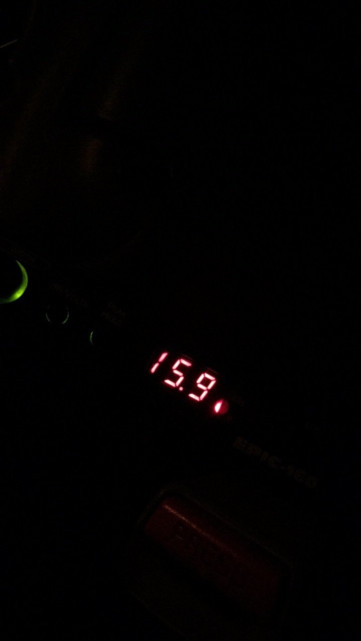

  16. Jan 18, 2019 at 7:52 PM
    taco71742
    taco71742 Well-Known Member
    Jul 8, 2017
    #223476
    317
    Daniel
    Woodstock GA
    04 Taco DC 4x4 5spd
    3" Toytec Boss Lift with External reservoir and adjusters Prerunner to 4x4 conversion Manual locking hubs 16x10 w/-38 offset 305/70r16 Toyo RT tire
    Anyone get 16 volts when you disconnect the battery then reconnect it?
    Forgot to mention that the ABS light flickers and the check engine light is on. Throws a p0031. Always has done this when I disconnect the battery btw
  17. Jan 18, 2019 at 7:54 PM
    zero4
    zero4 Metal Cutter
    Sep 10, 2006
    #31
    5,989
    Will
    SFV, CA
    01' DCab 3.4L TRD
    Donahoe CO, Donahoe Rear Resi, Deaver J59, 16" Pro Comp, 33" BFG AT, Hayden Trans Oil Cooler, Oil Filter Relocator, FM 40, ES Bushings, Beefed CB Drop, Deckplate, K&N Drop-In, DO Bed Bar, Cobra 75 WXST, Firestik Firefly, Philips D1R, Clarion Remote Start, Husky Liners
    Could just be that voltmeter. I've seen those things act funny sometimes. Have you verified with a real multi meter?
  18. Jan 18, 2019 at 7:56 PM
    taco71742
    Jul 8, 2017
    #223476
    317
    Daniel
    Woodstock GA
    04 Taco DC 4x4 5spd
    Not yet but you’re probably right
  19. Jan 18, 2019 at 8:00 PM
    cruiserguy
    cruiserguy Well-Known Member
    Jul 31, 2016
    #193416
    19,000
    Elijah
    SEKS
    2000 ext cab, 2.7L, auto, 4x4
    Ghost voltage? Put a meter on the battery posts
  20. Jan 18, 2019 at 8:01 PM
    Speedytech7
    Feb 20, 2014
    #123587
    58,276
    FCQM+VG Cheney, Washington
    It's less Tacoma and more mod
    Did you unplug the alternator sense wire. That'll make it shoot to almost 17v
