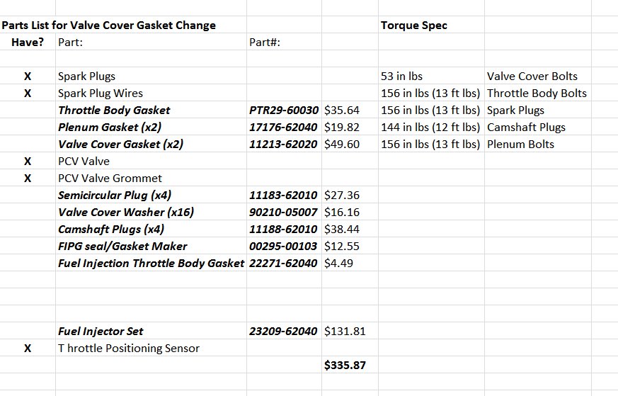

    Nasty leak on the passenger side VCG towards the rear. Had them replaced back in June of 2014. Driver side is fine, no leaks. Passenger side is bad. Saw someone mentioning checking the torque on the bolts and it was fine after re-torquing.
    Whats the consensus on re-torquing? Just replace them or cant hurt to re-torque as long as I'm careful.
    I was all set to order parts and take it back to the guy who did the work last time but now debating on going elsewhere.

    Yeah the rubber washers can shrink causing them to not hold the same clamping force. Use a torque wrench if you're not comfortable with snugging them up by feel, I believe the spec is 53 inch pounds.

    Try to retorque chances are that’s the only problem. Passenger side is the easier side to do. Shouldn’t take more than a couple hours if your slow

    Doing a search on this now and I just saw your post from October... lol.
    https://www.tacomaworld.com/threads/3-4-v6-valve-cover-leak.566177/page-2#post-18971190
    yep, 53 in lbs. I'll take a look in the morning.
    So far, based on Tim's vid and info here, I've spec'd this out using CamelBack online prices - already had some of these parts and
    as for the injectors figured might as well replace them since it'd be apart anyway.

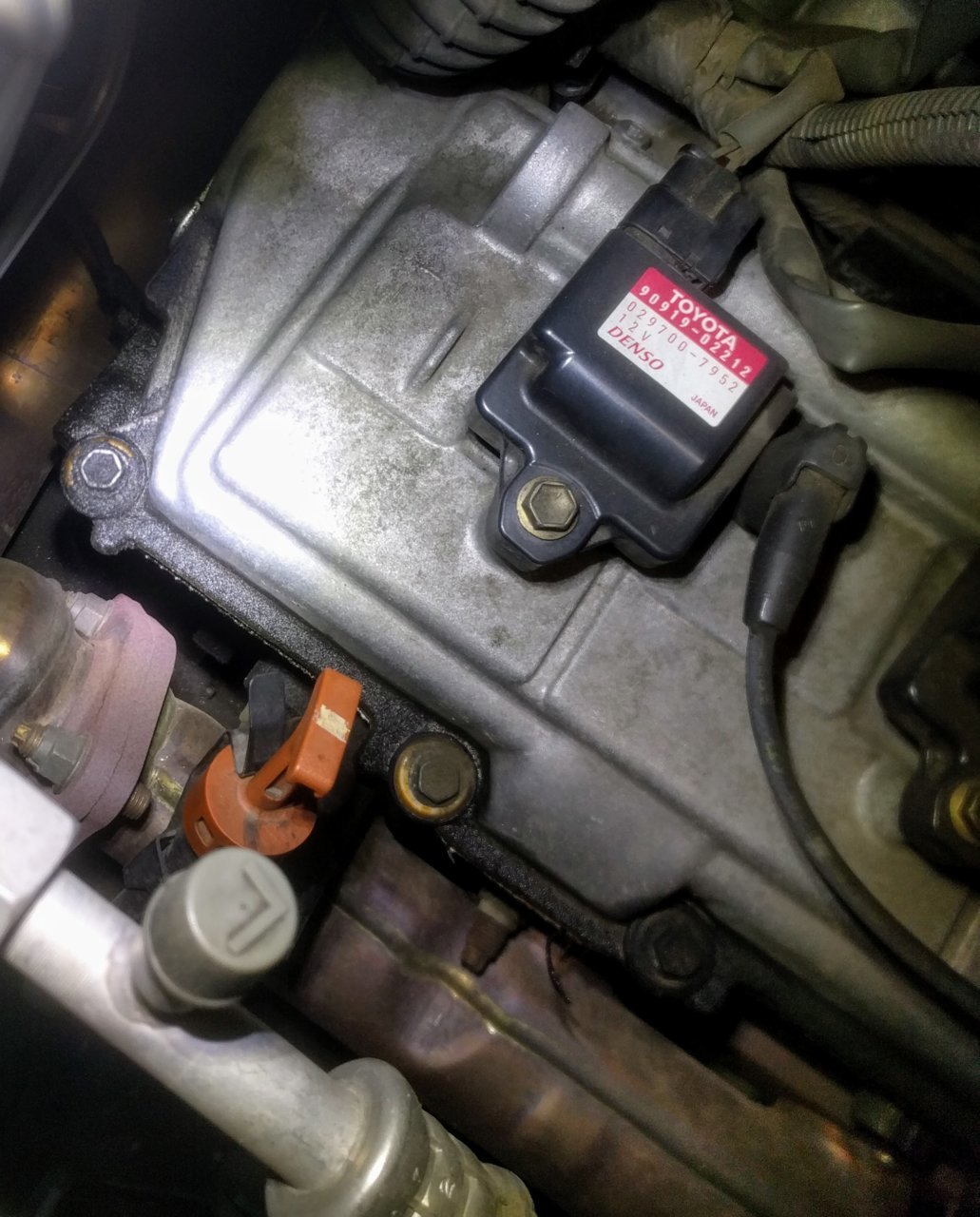

    Definitely and thanks for the info. Now just to figure out how many there are... Wonder if I just do those 3 visible in the picture if that would be enough or if everything has to come off and do all of them. The leaking seems to be just on that rear quarter.

    I think there's 16 total.

    Passenger side should be easy enough to retorque all of the bolts.
