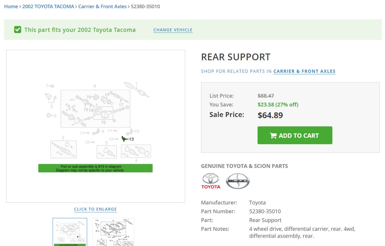

    FrenchTaco posted this in his thread and I was kind of using it as a reference even though he was working with an 03

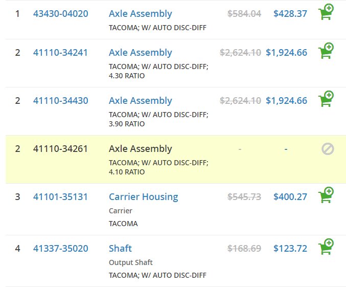

    I wonder just how many of the parts I could just order from gunny - within reason of course. Obviously I'm not going to drop 400 bones on a part I can source locally for less than half that.

    I wouldn’t buy any of that stuff new from Toyota. Everything but the seals, filters, and consumables will be significantly cheaper if you buy used. You’re looking at a total cost of $1,500 for parts versus $12,000.

    Even with my discount.. front diff alone is over 2 grand if you piece it all out
