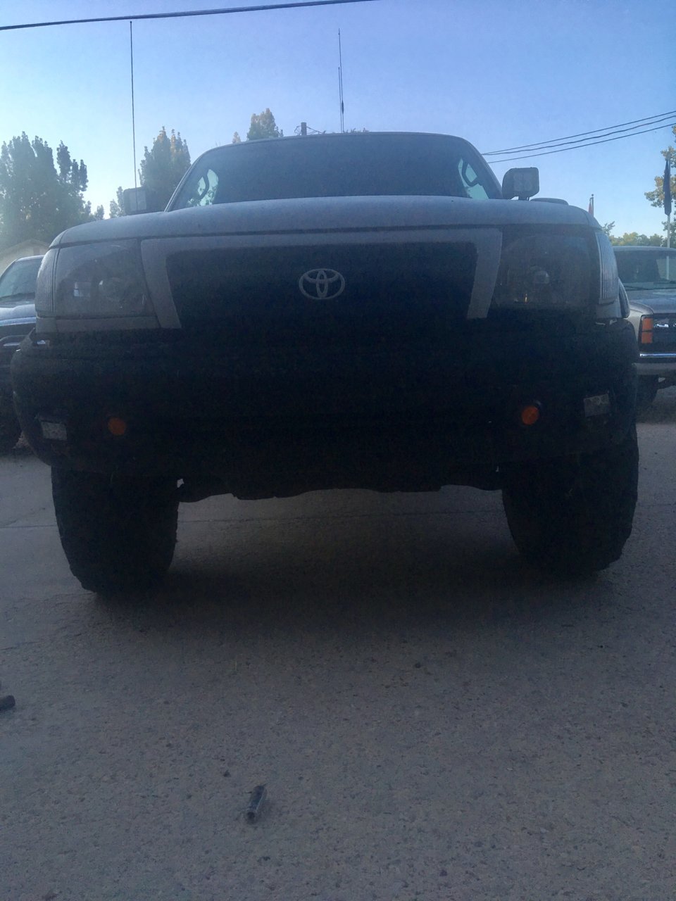

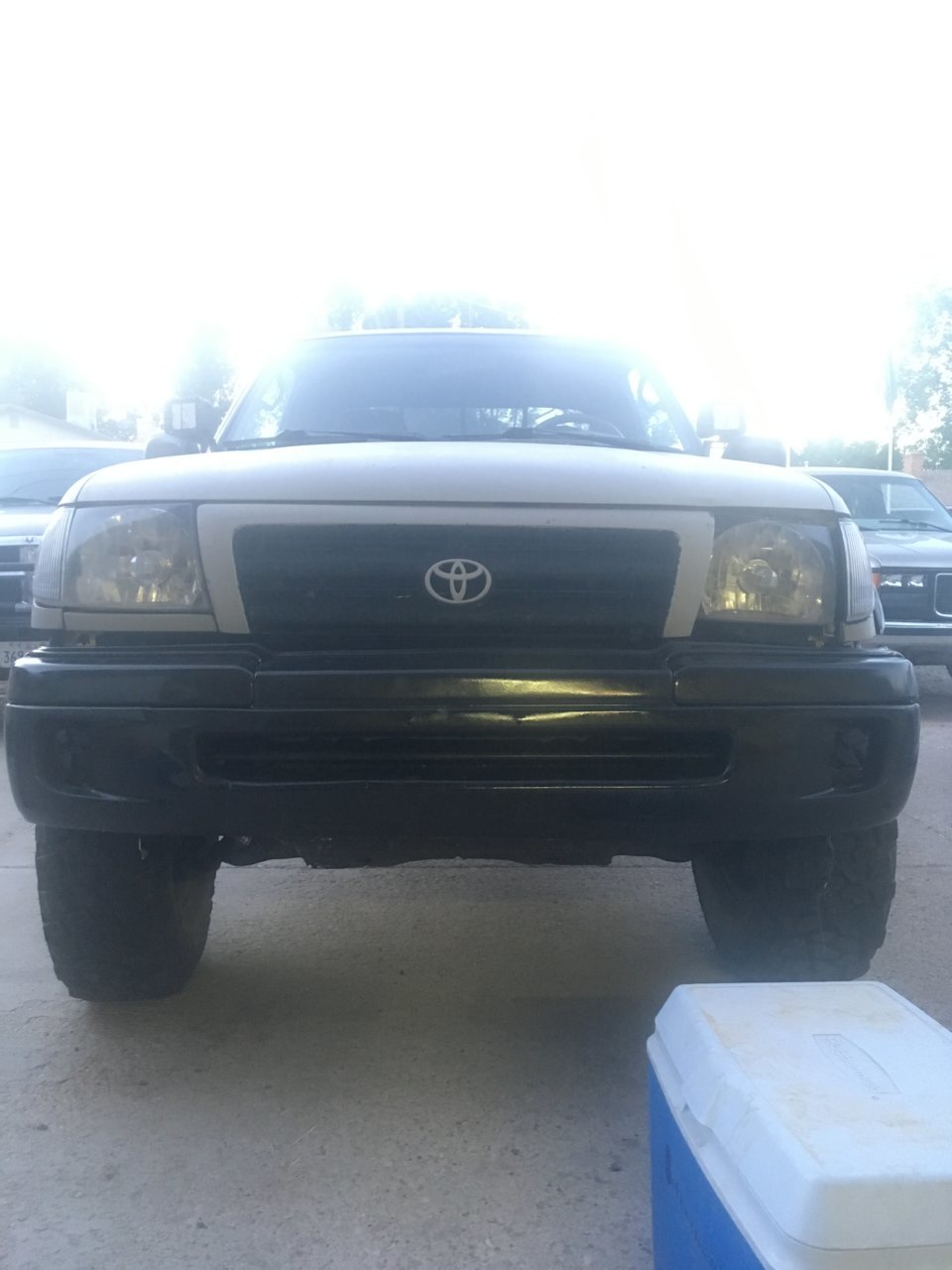

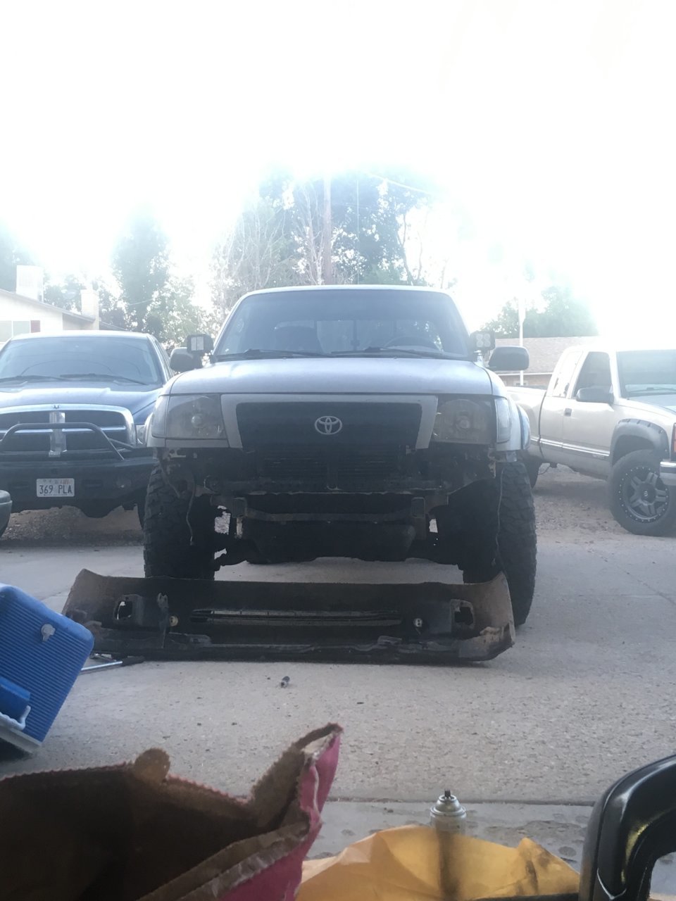

    Change my bumper, trying to get the blinkers to work, I think the bulbs way be bad. Will continue tomorrow.
    C6A9B8F5-2F93-4D98-AA05-529328F7D9DF.jpg B05BA7D0-6B0A-4273-825E-9E77D789196C.jpg75FFDB50-9519-43B6-A41E-81C3AD2BFDF5.jpg

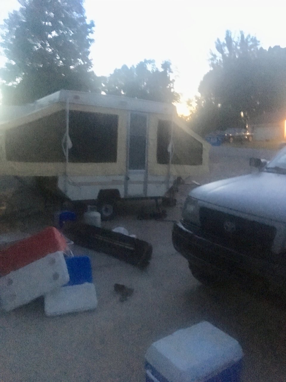

    Also finish flipping the axles on the ol’ race horse. (The Palimino Pony camper)
    (Potato Pic)

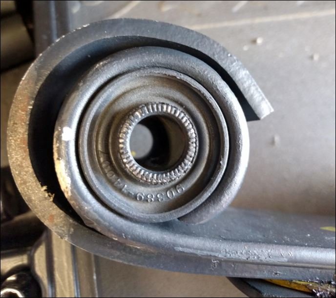

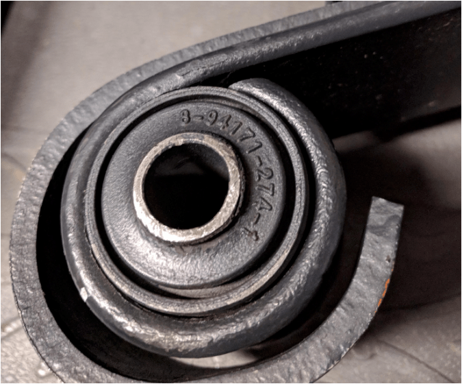

    yep, here is the other side of each -
    driver side and number is for a damn isuzu bushing - wtf?!
    8941712741 https://www.google.com/search?q=8941712741
    Passenger Side (same)

    Weird, I'll have to remember to look at mine tomorrow and see if I can make out the number on them. Mine are so coated in lubricant/grease though to get them to shut up I don't if I'll be able to read it.
    OME makes the greasable shackles but mine don't squeak from the shackles, they make tons of noise from the front hangar bolts. I've heard you can get greasable bolts for that too though.

    even if its compatible, kind of calls into question the whole dakar/ARB quality thing - or is this a wheeler's offroad thing? One side has a bushing made in Japan apparently universal with Honda/Isuzu and possibly Toyota while the Passenger side has a bushing made in germany?
    right, I have the OME shackles as well. I was reading this one and that is when I noticed the difference between the front bushings. The shackle side are the Wheeler's poly bushings which I believe are made by Daystar - not sure. Almost tempted now to leave the truck up on stands for a few more days and just do it right and order these - have to confirm compatibility though with the dakars. https://www.tacomaworld.com/threads/where-to-grease-spring-bushings.528561/#post-16891167
    Which grease did you use for the shackles and did you grease the front hangar bolt?

    None of my Dakar's have ever come with bushings, but I bet they just changed manufacturers mid way through. No biggie

    Yep I greased both using moly grease. I probably should have been more generous with it on the front hangar.
    I really wouldn't worry about those bushings being different so long as they fit well and are made of the same material I don't see an issue.
    I didn't go with the greasable shackles in the rear but I did get the yellow ARB bushings for them.

    Interesting. When I ordered the kit from Wheeler's, they mentioned on the full kit they were subbing out the OME yellow (all - even shocks) with their poly bushings due to numerous complaints of squeaking - something about the OME yellow bushings not having enough graphite (or was it teflon) in them. Can't remember.
    Thanks all. Will update when I receive a reply tomorrow from them on the difference in bushings.
