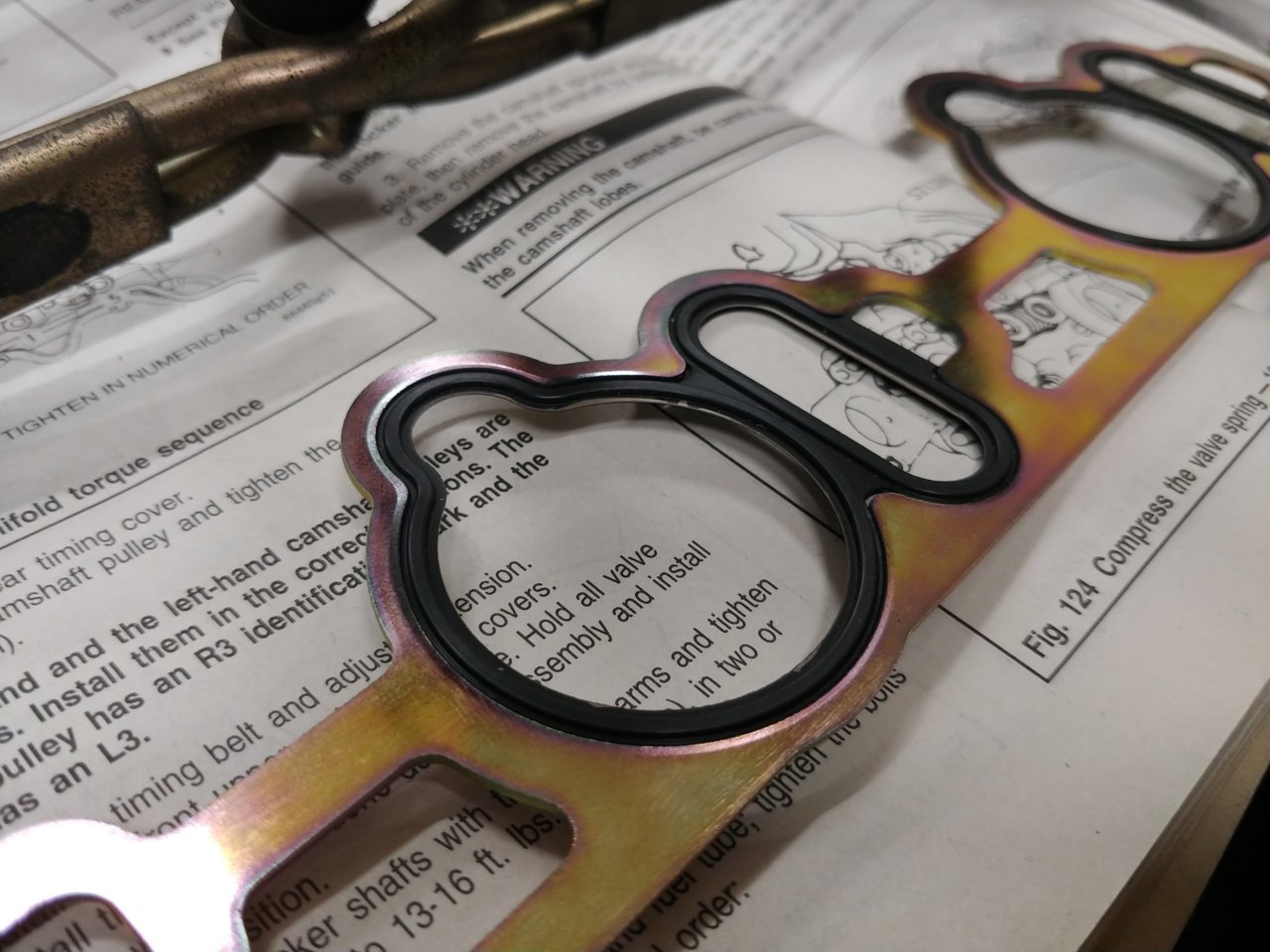

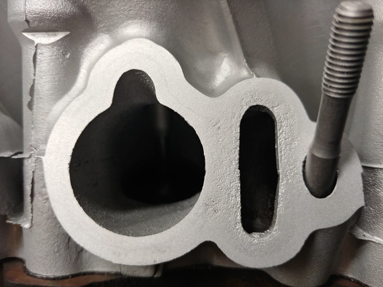

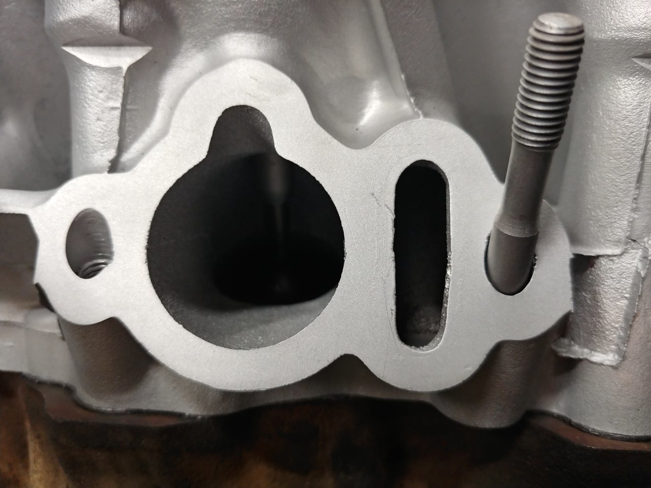

  10. Feb 7, 2019 at 9:56 PM
    Speedytech7
    Feb 20, 2014
    #123587
    58,414
    FCQM+VG Cheney, Washington
    It's less Tacoma and more mod
    Good port...
    Questionable port...
    Gasket in question...
  11. Feb 7, 2019 at 10:00 PM
    what road
    Jan 28, 2014
    #121762
    22,855
    Dallas
    Indiana
    2001 tacoma sr5 trd
    alot still need done
    Nice
  12. Feb 7, 2019 at 10:04 PM
    zero4
    zero4 Metal Cutter
    Sep 10, 2006
    #31
    5,989
    Will
    SFV, CA
    01' DCab 3.4L TRD
    Donahoe CO, Donahoe Rear Resi, Deaver J59, 16" Pro Comp, 33" BFG AT, Hayden Trans Oil Cooler, Oil Filter Relocator, FM 40, ES Bushings, Beefed CB Drop, Deckplate, K&N Drop-In, DO Bed Bar, Cobra 75 WXST, Firestik Firefly, Philips D1R, Clarion Remote Start, Husky Liners
    Oh in that case, that doesn't look too bad. I wouldn't even try filling in those pits. It would probably seal ok but I would add gray rtv, honda bond, or yamabond to those areas & call it a day.
    It's actually not uncommon to add some rtv to intake, oil, & water gaskets. I used to add it around coolant ports on intake manifolds even on new gaskets & good mating surfaces for insurance. I've always prefered the grey permatex or honda bond.
