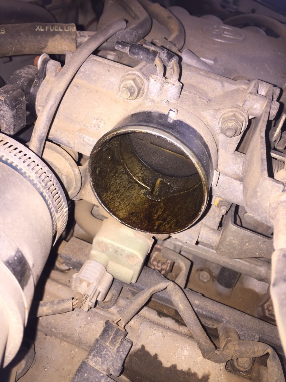

    Its the company truck
    Someone oiled their filter to much

    That's a lot of blow by. Catch can time!

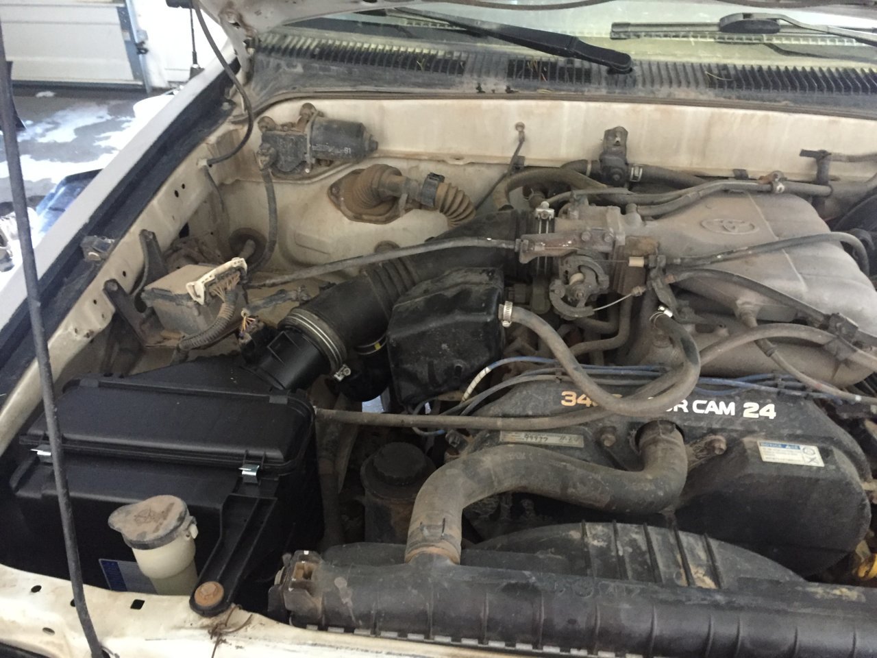

    That’s from the CAI oil
    Which is fixed till this box breaks 1054DAC8-E905-4AFF-B05B-5D0055B611E4.jpg

    Where you get the air box?

    Lol, yeah right.
    But really that's engine oil residue coming in through the PCV. You should probably take the throttle body off & clean it, then check periodically to see how bad of a blow by issue you have.

    @what road
    The one off Amazon

    Should also check if your PCV is stuck open. Judging by the way your TB looks I wouldn't be surprised if it is. PCVs are cheap, I would just replace it. Not something you want to leave neglected. Also check the PCV grommet while you're at it. The rubber gets hard & brittle. When it is you risk breaking it into pieces & you don't want any of it falling into the valvetrain unless you don't mind taking the valve cover off.
