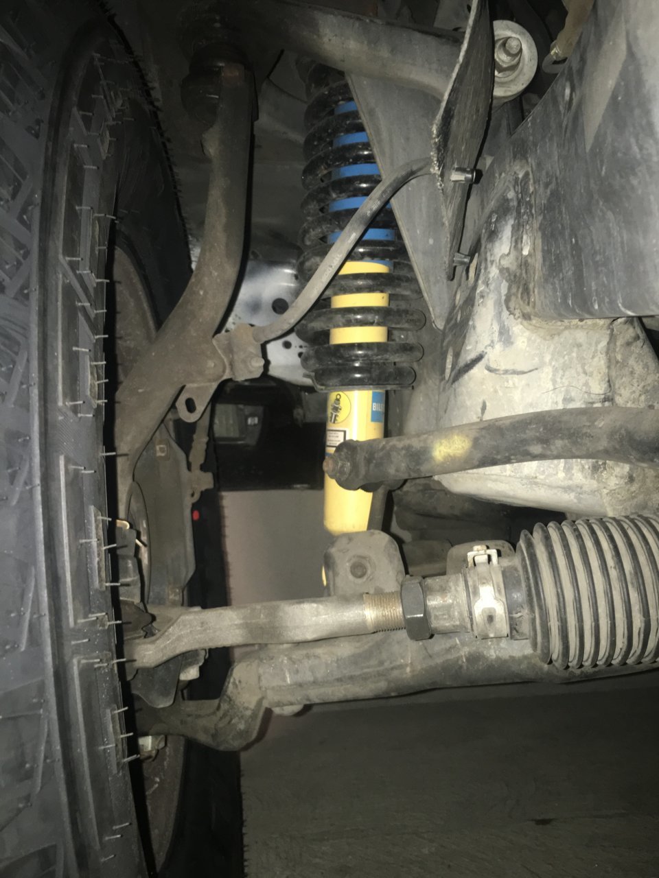

    If its upside down, it will preload the spring and lift the truck. Should be like this with the part the spring sits on closest to the bottom of the shock. 0720181352.jpg

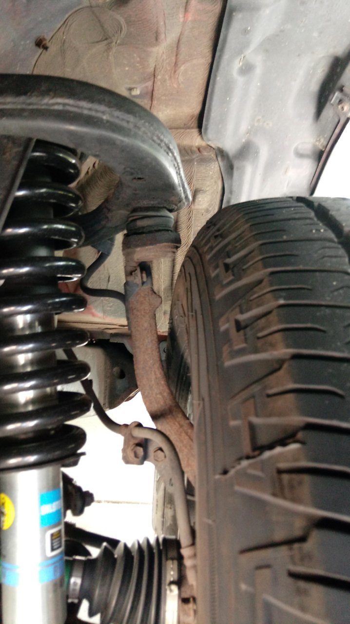

    6pm here I take night classes because fuck Socal traffic lol. Also here a pic of the drivers side. Passenger side looks the same.

    Seems like you have a bigger issue at hand. It appears you dont have any front drive axles. I would address that issue first. @Uphillshunter
    But your coils look ok.
