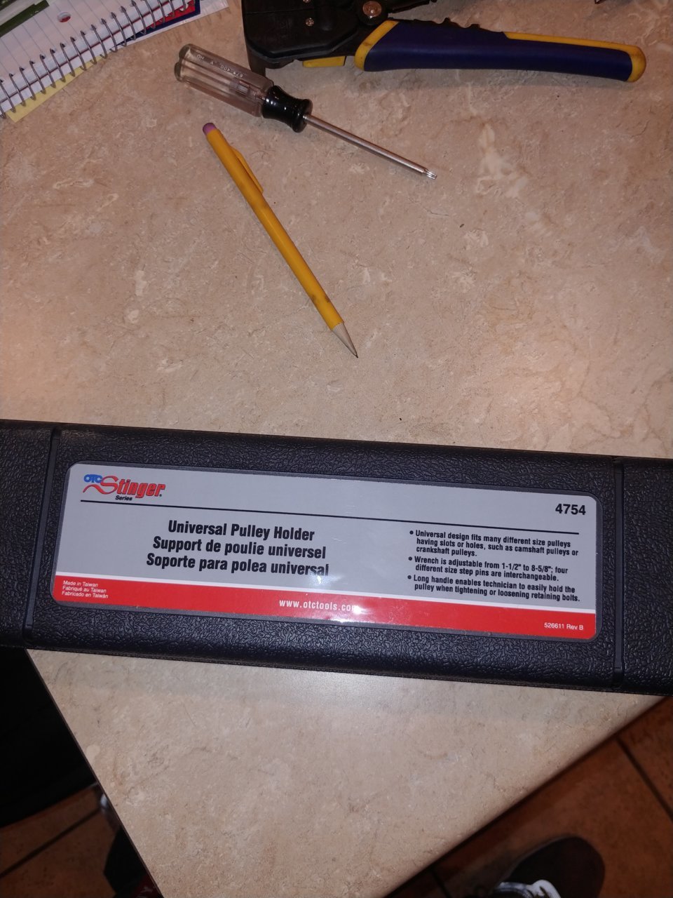

    It's less Tacoma and more mod

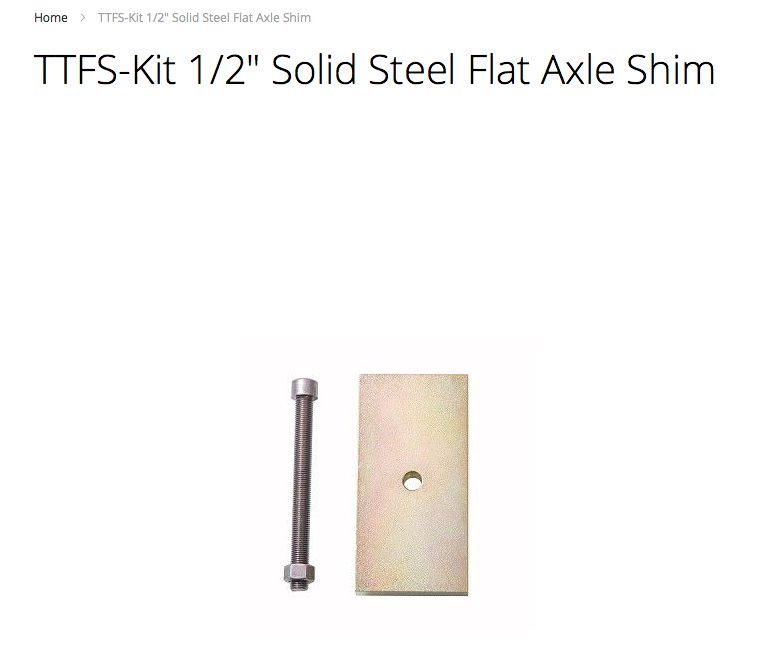

    Except the pins falls out through the bottom of the leaf pack. Gotta take the pack out lol.

    Gotta at least lower the axle away from the leafs enough to drop the pin out

    Guess its doable. May have to jack the other side up quite a bit. Definetly not a slide it in kinda job.

    yeah I'll just jack the one side up enough to raise the pack off the axle and pull the pin out. Gonna have to put it on the back burner tonight since we have a 4 day storm coming in this afternoon, woohoo

    The lean is starting to bug me a lot, it's not that noticeable when my tank is under 1/2 full but when I have a full tank it's a pretty noticeable lean. Weird cause I never had this issue with the Dakars or the stock leafs but these Expos like to lean on that side.
    Figured an extra leaf on one side would be kind of overkill so decided to see how this little .5" spacer works
