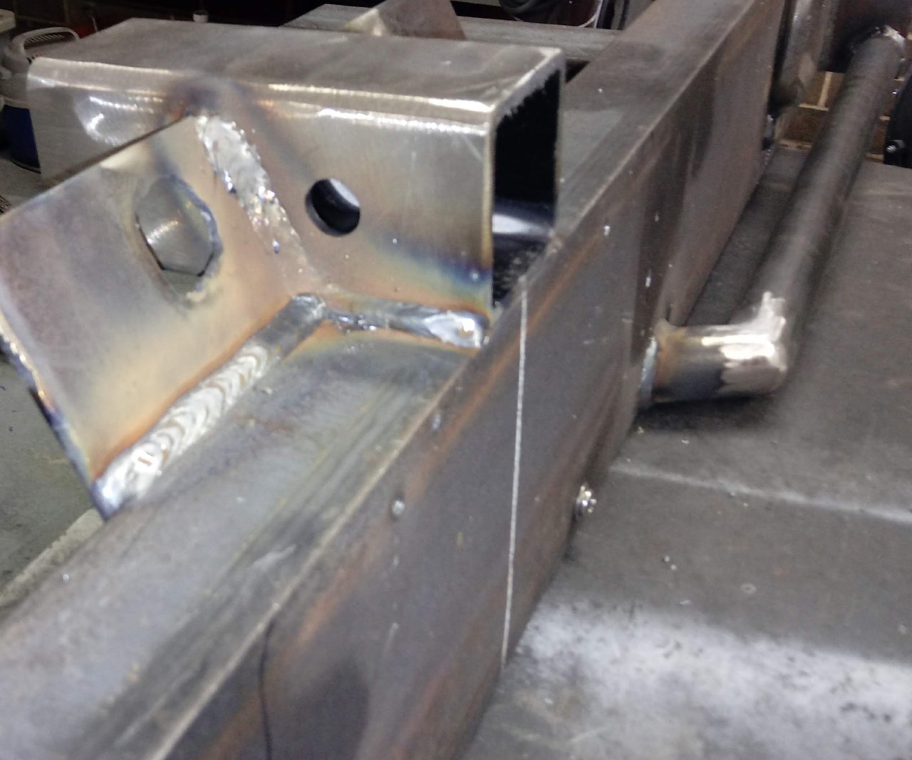

    Its an option most dont consider when building a rear bumper. Channel iron of any size is way cheaper than square or rectangular tubing, and has a thicker wall. I bought the channel from a steel dealer's overstock pile for pennies on the pound cause some guy with deep pockets ordered a pallet of it and never picked it up . All the extra trim pieces I got out of a scrap yard for less than $5. I was all in for $120 including paint. (Didnt include my dads tetanus shot, long story there). Built most of it at work over 2 thirty minute lunch breaks. 0527181446a.jpg

    Yeah mine uses 3"x1/4" angle straight off the frame for mounts. Uses stock bolt holes. 0525181422c.jpg

    Looks good. Is the hitch welded on rated the same as a normal tow hitch?

    Looks similar...mine was just the bumper though, welded to the existing bumper brackets where the stock bumper was cut off. Since yours has it's own brackets it looks definitely stronger.

    Lol. "Rated." Im a red neck with a welder, aint nobody got time for ratings. I wouldnt tow with it, but it holds a bike rack with 2 bikes just fine. All I ever planned on using it for. I did multiple passes at 24 volts (quite a bit) with the mig welder at work. 0525181056.jpg

    Figured it would be the same as any other aftermarket integrated hitch, just good enough for like a cargo rack or bike rack.

    Miguel

    16,481
