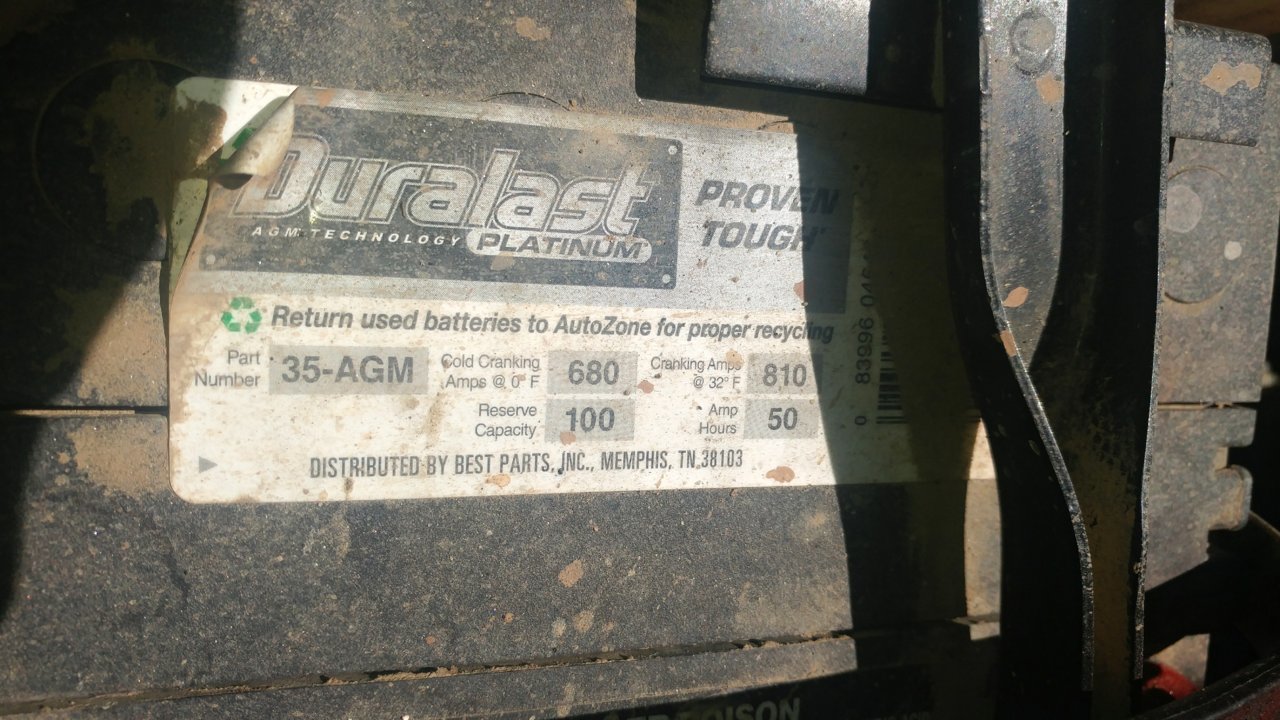

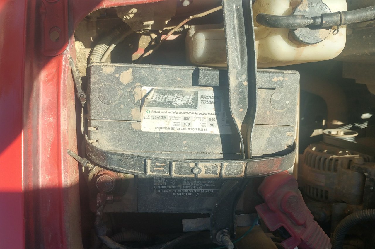

    Pardon the dirt
    I have the stock battery holder in place but it doesn't do crap, hence the zip ties holding it against the inside fender. Also as you can see the battery ground is missing as I pulled it off last night since it was barely holding on by a couple threads

    I mostly meant cabling. I have a battery the size of a can of spray paint that can start the truck so I doubt anything there is wrong, I think your battery other than fitting poorly is fine. But how does all your cabling look there's. A wire the goes starter to batt, one that goes alt to fuse block and fuse block to battery (there's a good way to bypass this and improve it), and there should be a ground from block to battery, and from fender to battery ground

    Yeah the other wires going to the terminal are for my lights on the roof, and there is still some wiring closer to the front of the truck that was for the electric fans back when I had those installed...the shop that put the stock fan back in didn't want to mess with the wiring from the e-fans so they left it in. Me not having any real confidence in working with electrical I just left in there as well, been meaning to take it out though.
    Yeah I forget what it's called but I want to get one of those standalone fuse boxes that you can run all of your aftermarket electronics through to clean up the engine bay.
    I'll try to get some measurements and a better pic of the cables for you today
