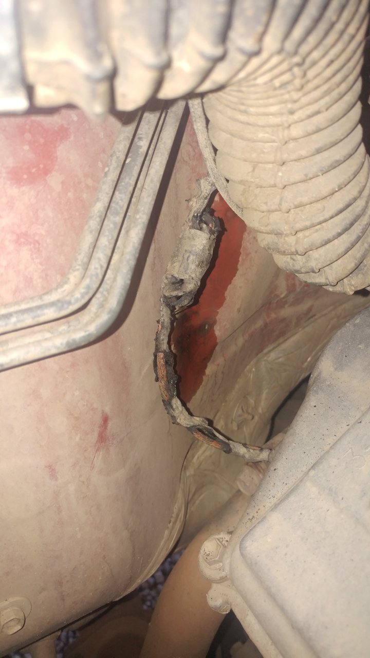

    Inspected my engine ground and found this...the wrap around the wires is toast but the wires look fine, should I just rewrap it or replace the ground wire? I assume the wrap is toast from the engine heat over time and not something abnormal...would it be ok to wrap in electrical tape or should I get something better capable of withstanding heat?

    That wire is donezo, chances are it is starting to corrode. You can re wrap it for now. But might be wise to think about making a new one. Your ECU likes to ground partially through that. How did it melt? Also I, can remake that too

    Could it have something to do with the my battery terminal hitting the bracket? Probably happened a couple dozen times yesterday on the trail. I just figured it was from the engine heat since its so close to the back of the block. Likely the original ground wire from 04.

    It's ain't from engine heat, but if you have bad grounds elsewhere and it is forced to pass more current than it should it'll melt its casing. Looks like what happened here. My 22 year old Taco and 25 year old cruiser haven't had that happen from age yet and they're right over the exhaust manifold. I'd check your main ground ASAP and part of it could be from the short but I doubt it since the battery bracket was acting as ground for that

    I wonder if it's because my battery ground has been bad for so long (may have even been unattached for quite some time as I discovered yesterday). I'm putting a new battery ground on now as we speak hopefully that takes care of it. I'll rewrap the engine ground for now and PM you about getting a new one made.
