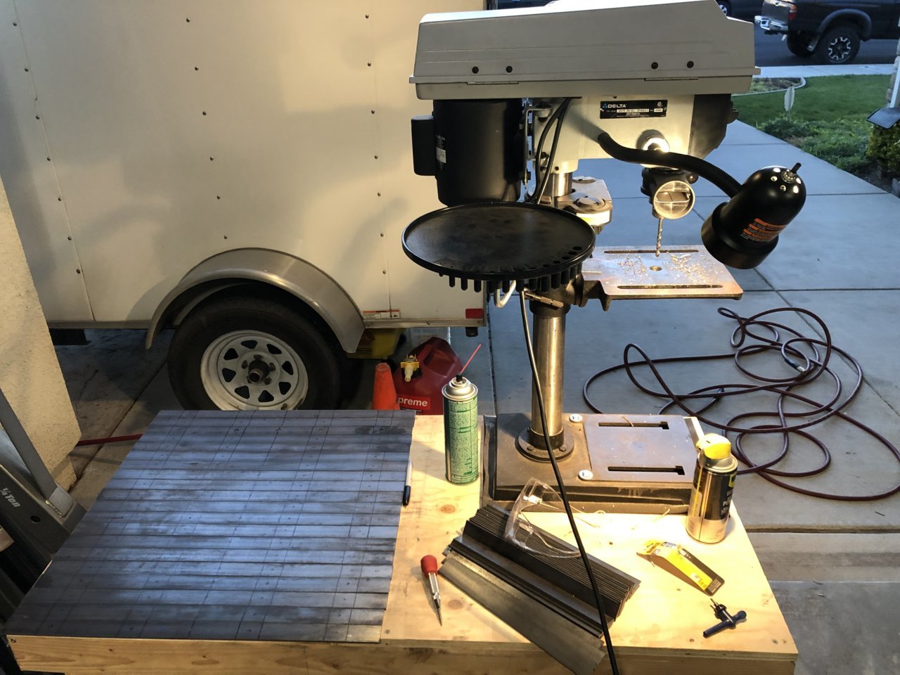

    Cool, I’ll keep doing it then. I’m making brackets today.

    I have an older Delta one, probably a step up from the Harbor Freight ones.

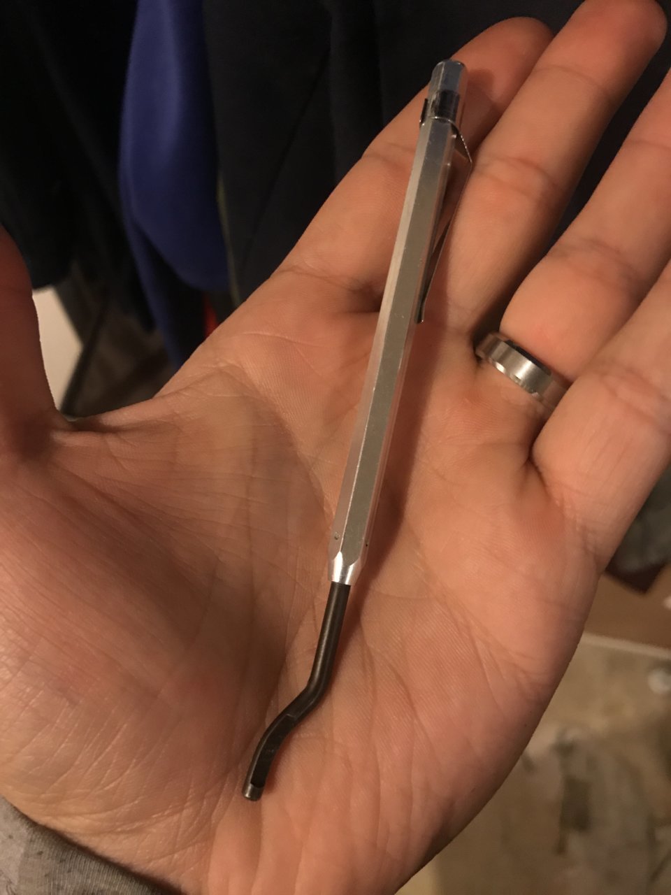

    Is there a bit you can buy to clean up the burs on a hole? I’ve seen it used on restoration videos but I don’t know what it’s called.

    Chamfer

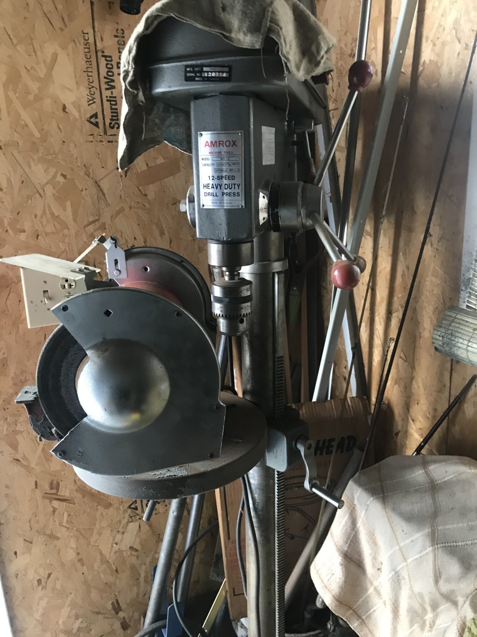

    Here's my drill press. :)

    A deburing tool? Like this?
    I use this for copper pipes

    Yeah I see that now. A step up indeed.

    I have something like that just slightly bigger and all mechanical

    Would I use that on a drill press, or is that something I would need like a handheld drill or mill for?

    Still made in China. Oh well. I bought it from the same guy I got my air compressor from, luckily that one is made in the USA.

    Either.

    Does speed matter here? I can’t really adjust the speed on my press.

    Jeez all I’m doing is cutting holes in 1/8 flat stock. I don’t need a huge press.
