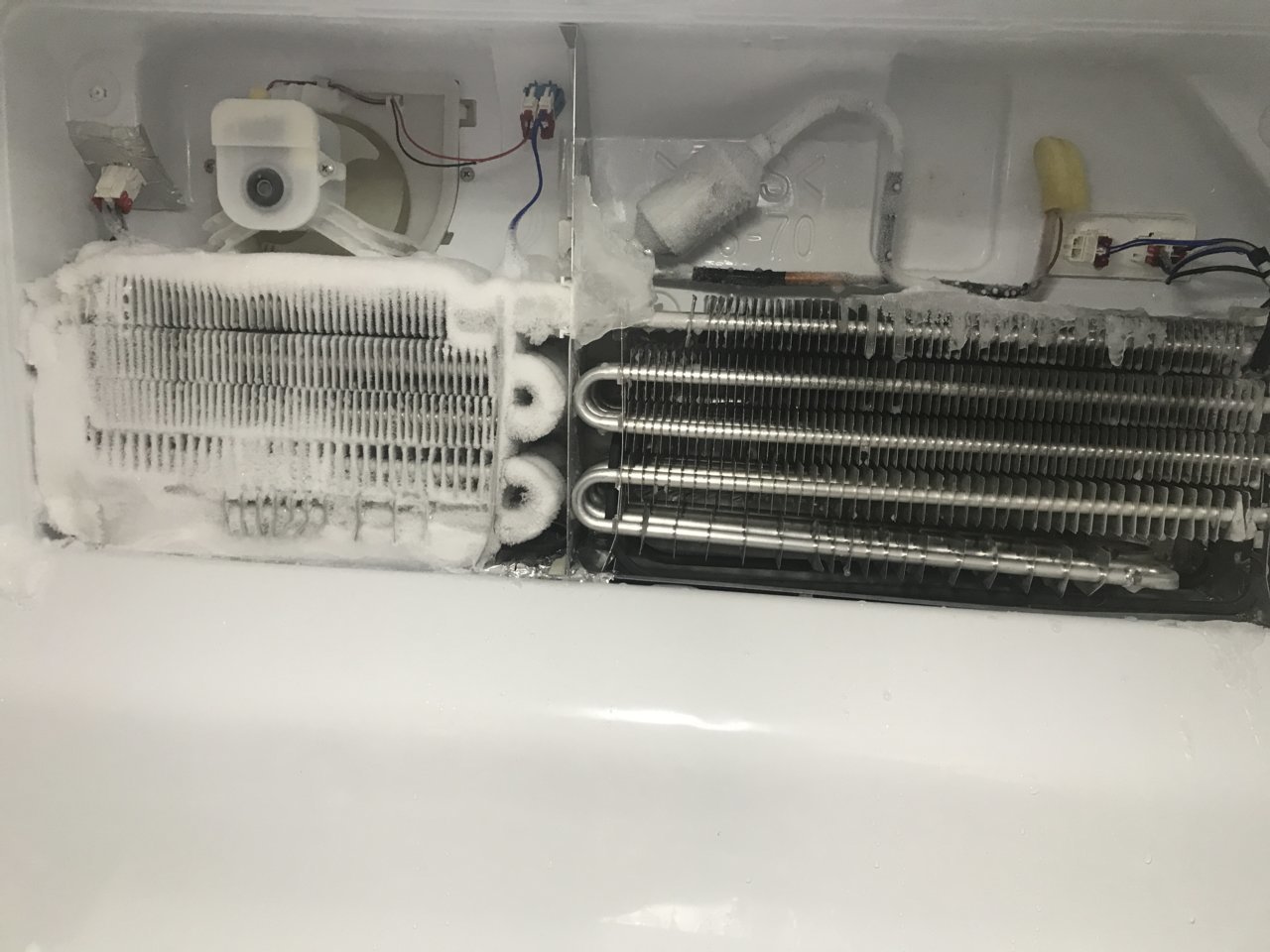

    The left side heater doesn’t kick on, right side heater works fine. And its not actually a duel evap, they just are pretending this single evap is a duel evap

    There isnt even a return air from the FF to the FZ. It just all pumps into the FF and stays there

    FF to warm. Ice build up on left side of evap coil.
    Pulled cover, left was iced up, forced defrost tested good. Replaced boards
