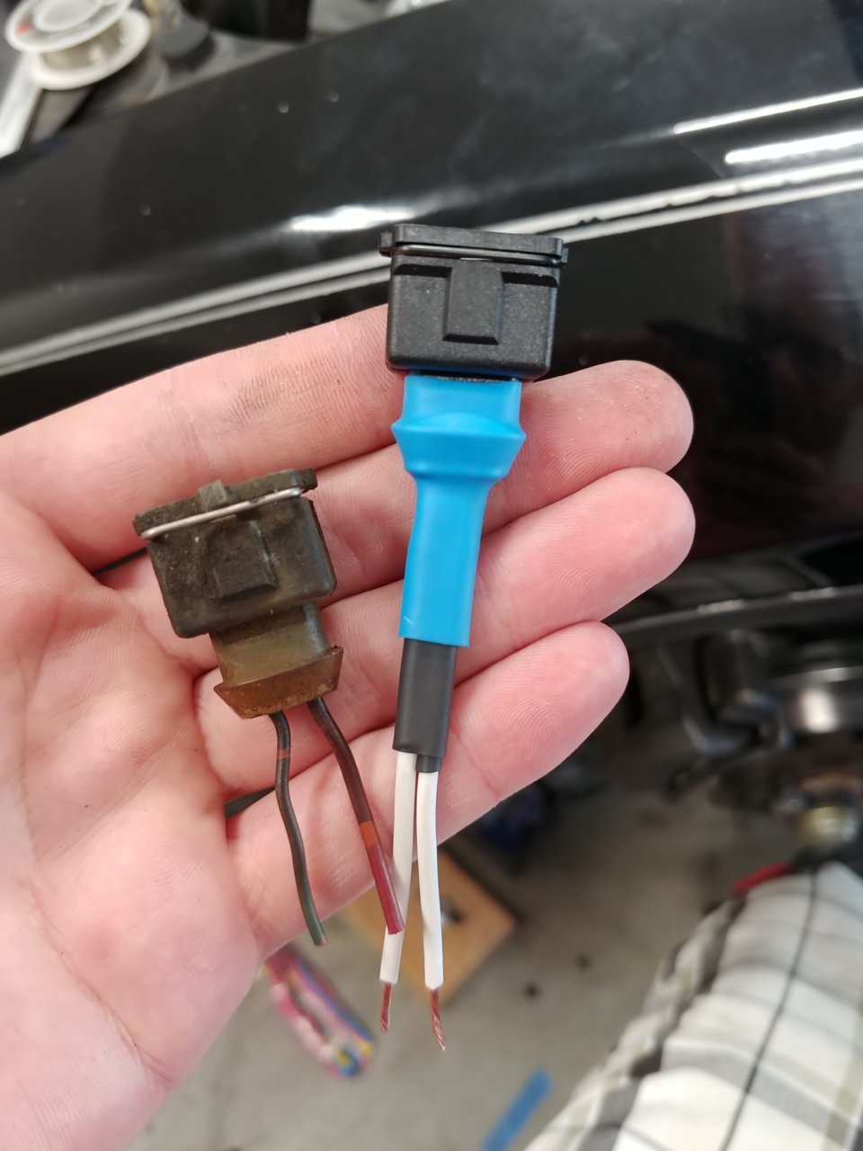

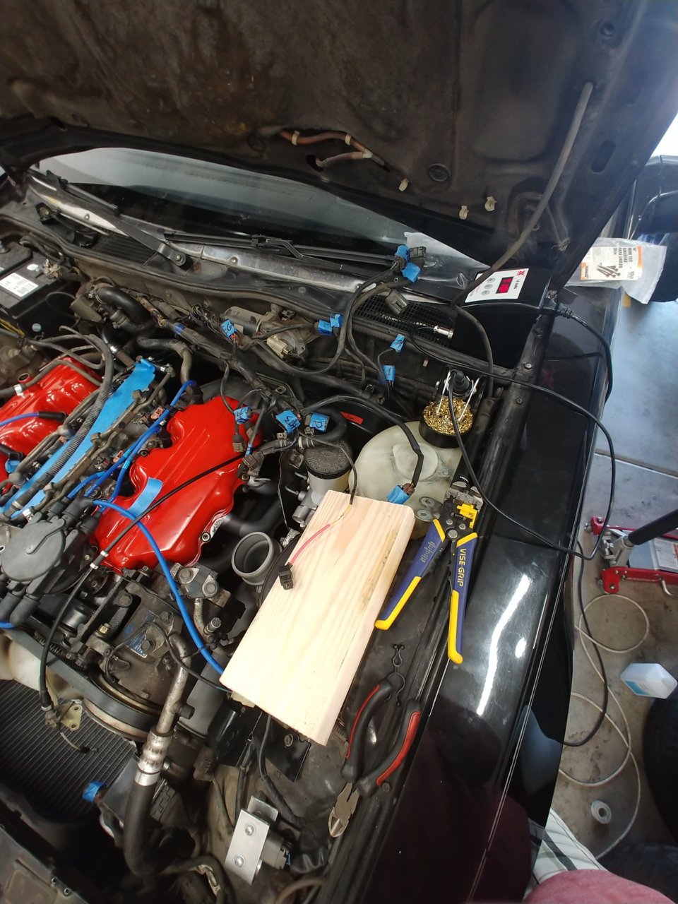

    Hoping to fire it tonight, the fuel injector harness is kinda crusty so I'm putting new connectors on.15534601698511973608185374452168.jpg

    So fuel injection but dizzy ignition?
    Running Board Man likes this.
  9. Mar 24, 2019 at 1:54 PM
    Speedytech7
    Feb 20, 2014
    #123587
    58,367
    FCQM+VG Cheney, Washington
    It's less Tacoma and more mod
    Yeah, it's a full MPFI system, super modern for 1984. It's basically unchanged up to 1998 or so

    It's a pretty solid system, not too many sensors to break. Cam and crank position are derived through an optical pickup in the dizzy base. The throttle position is only to determine the idle point, the cold weather idle up is controlled much like the engine thermostat and closes high idle when it's warm. The fueling system is fully tunable, so you can mess with it all you want and the computer runs out of turning range somewhere around 700hp. The MAF is the most breakable thing and it hides out of the path of heat which is smart, even the engine temp probe goes into a blind hole in the head so it never gets coolant fouled. Has a fuel temp sensor too but bear as I can tell in the tuning software it doesn't do anything.
