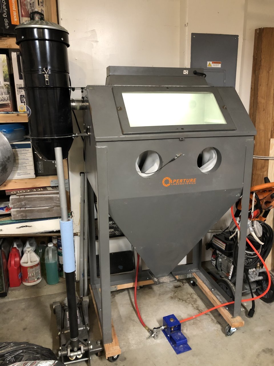

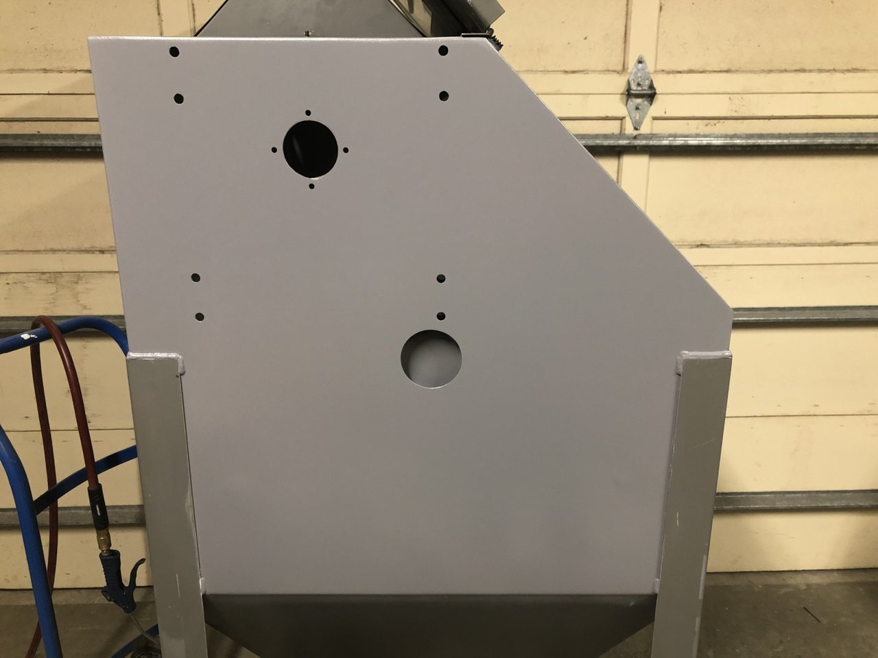

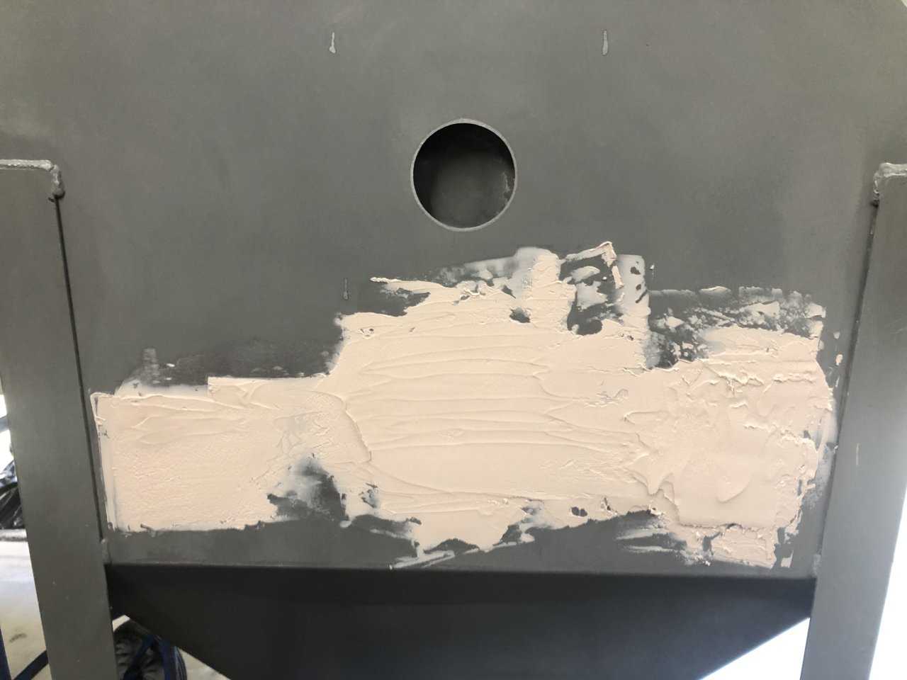

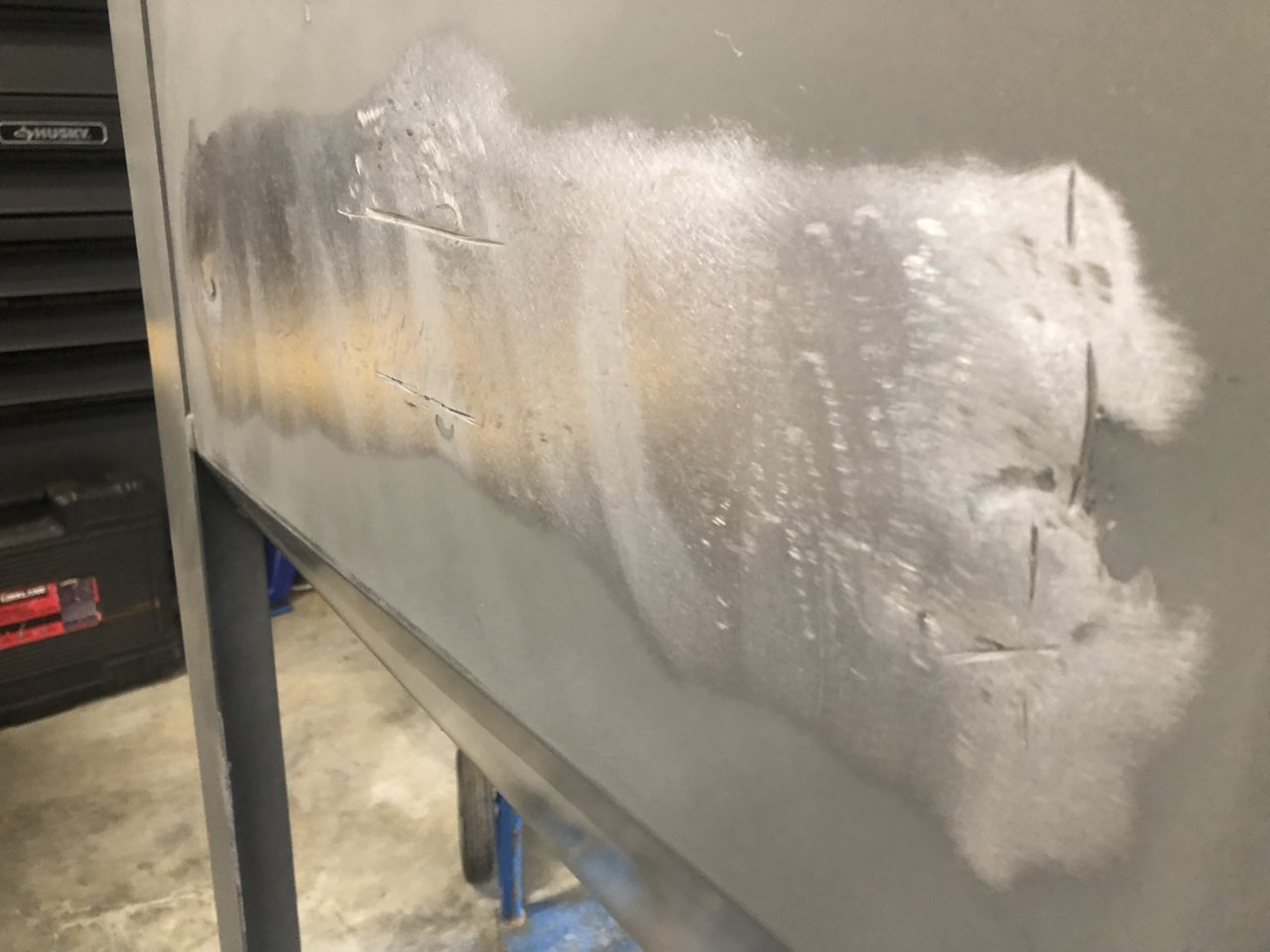

    @koditten

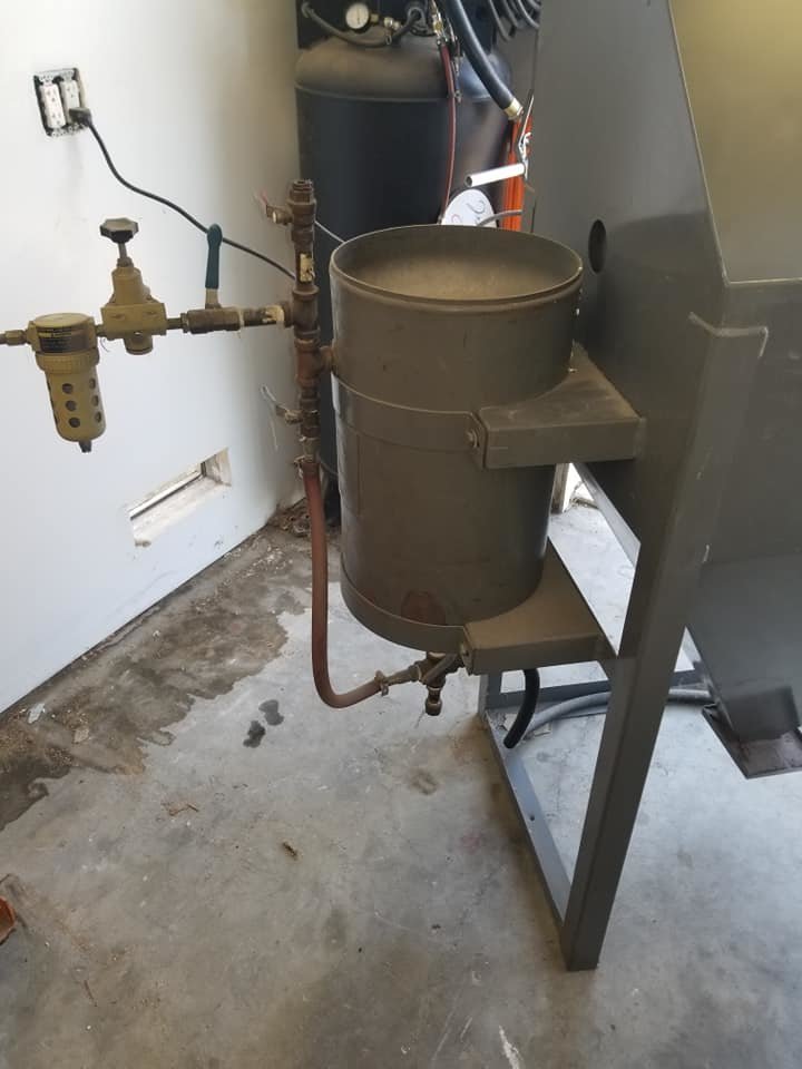

    I gave up and cut the pressure pot off my cabinet. I got a hold of the Econoline Manual and apparently the pressure pot setup needed something like 30 SCFM @ 90 PSI which I can only dream of ever having with my 12 SCFM @ 90 PSI.

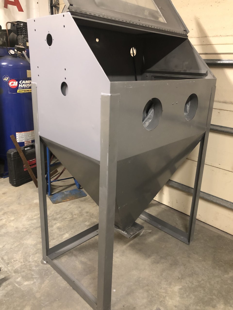

    A lot has changed with that cabinet since I last asked you about it. Bought a Skat Blast pickup tube, then quickly realized the media would pool up on one side and not mix properly. So I attached a industrial grain silo aggregate vibrator motor to the bottom of the funnel which basically liquifies the glass bead media I use making it blast way more efficiently. Hooked up that vibrator motor to a router variable speed controller.
    Then I realized the cabinet liked to shock my arms when I touched it during blasting, so I grounded it directly to the ground plane on my house subpanel in conjunction with an anti-static wristband I wear while using it.

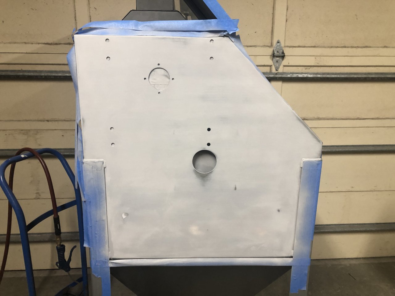

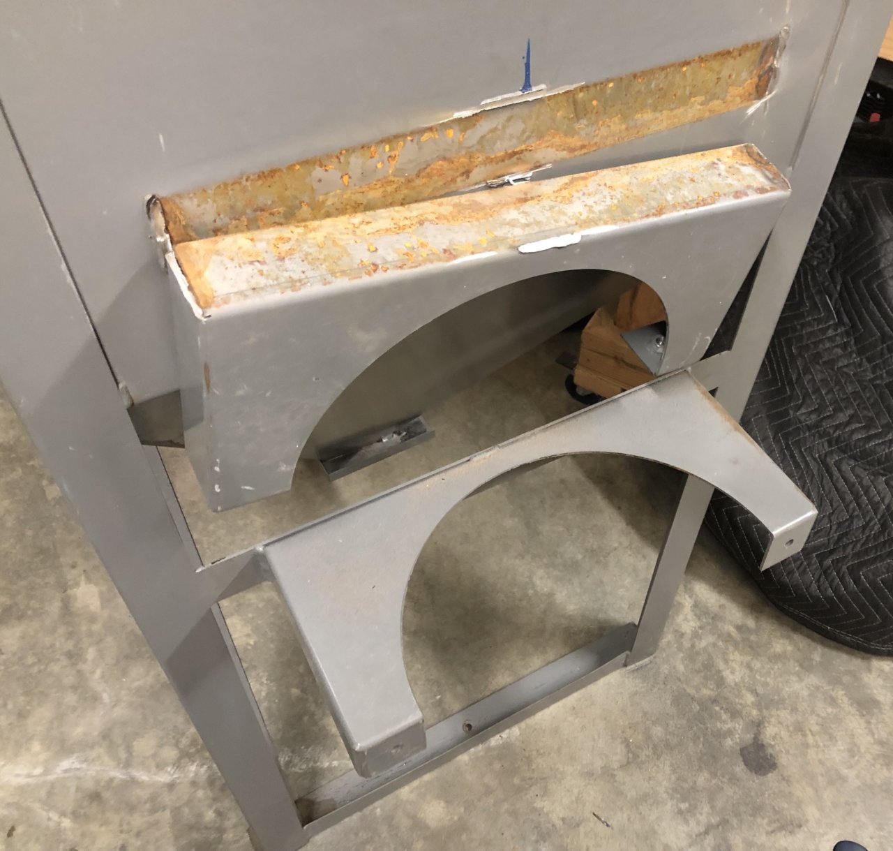

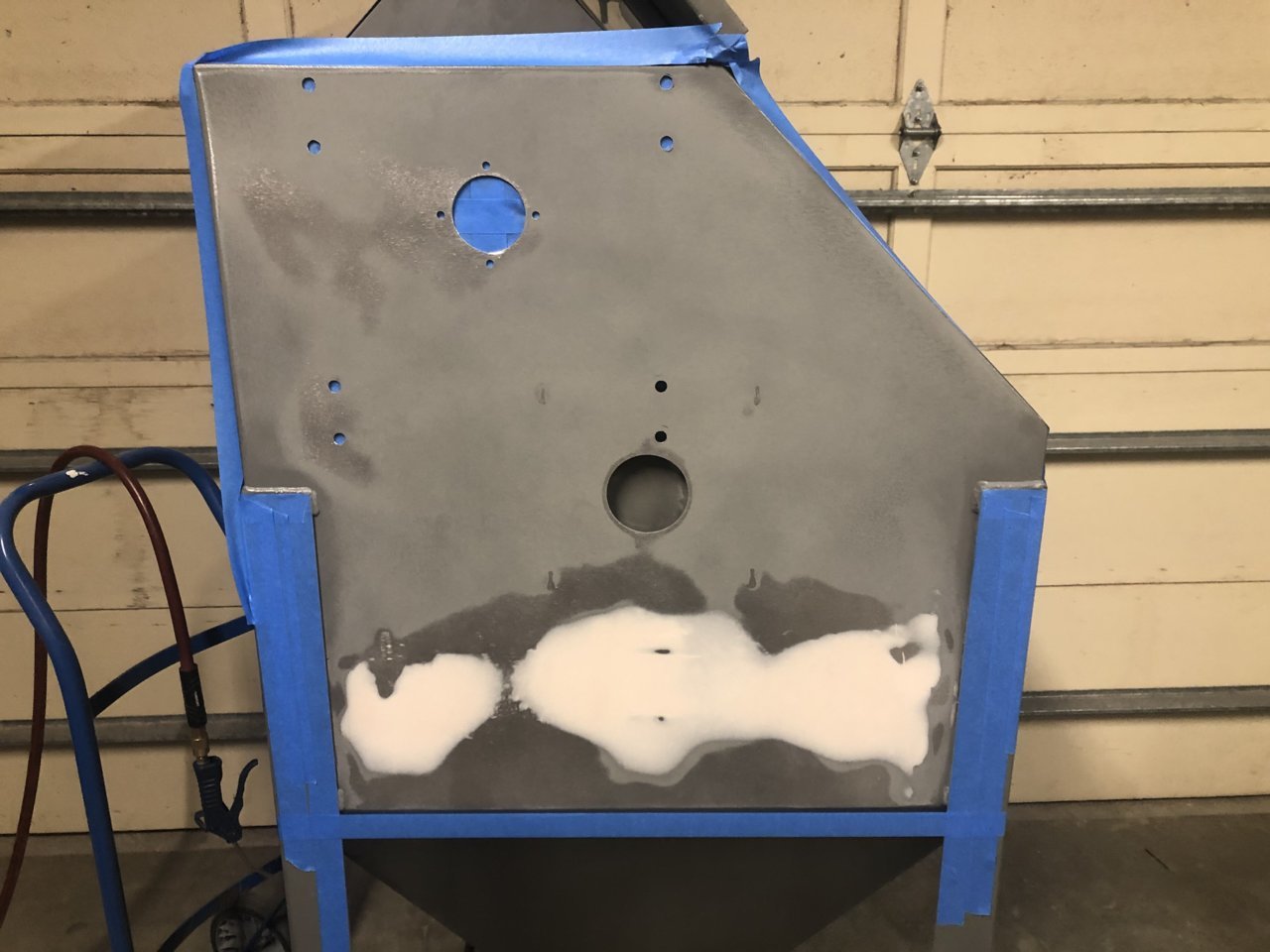

    I also ditched the bulky shop vac and cyclonic dust separator and attached an Eastwood dust collector to the side of it along with a foot pedal. Built a shoddy frame for it so I can move it around easier too.

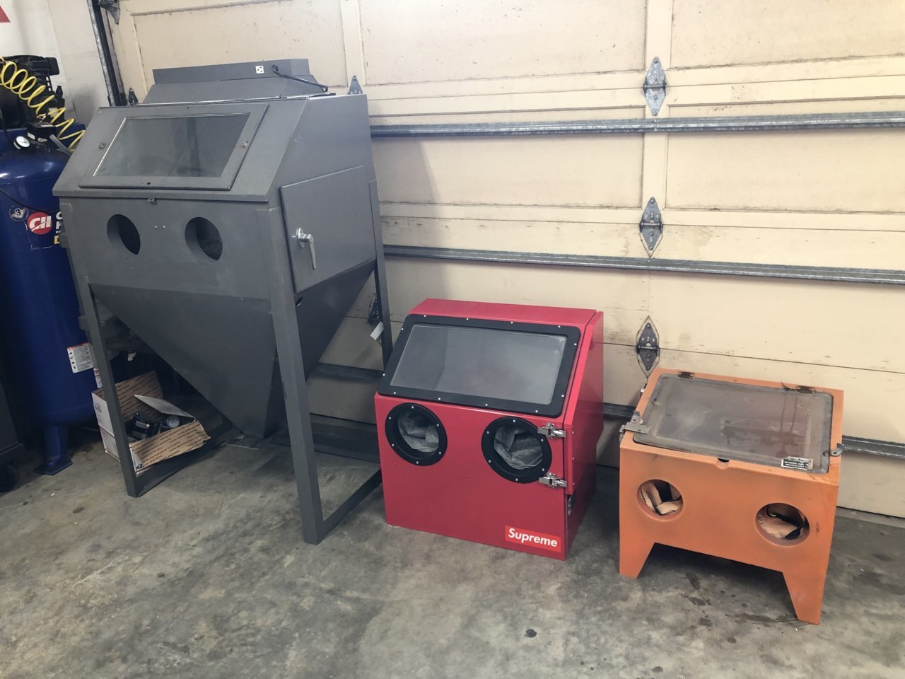

    Here's the evolution of my blast cabinets.
