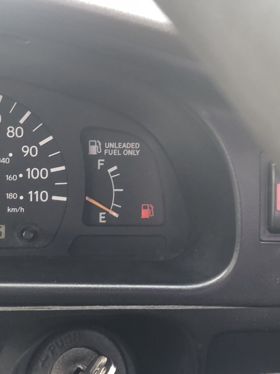

    Speaking of which I think I need a new iacv I've cleaned it 5 times now and still high revs

    No check engine light?

    Nope

    I’d say I have an extra you could have. But uh. The reason I have it is because it just redlines every time you turn the car on.

    Yea I idle 2500

    Might as well trade in for a 3rd gen.
