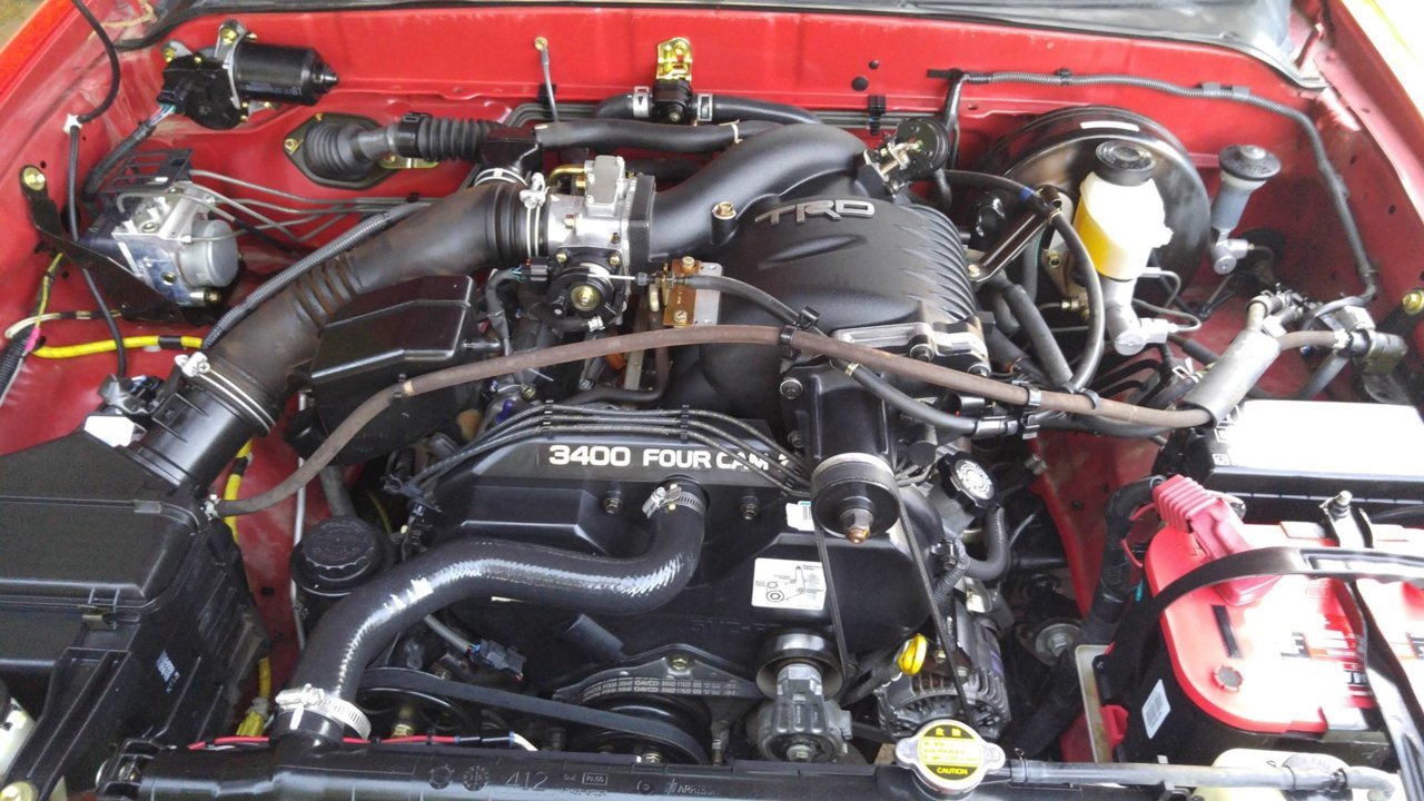

    I’ve noticed that you don’t have that big mounting bracket, and the first GEN gray supercharger does, yet I have the second GEN black supercharger. do I even need that bracket?

    You should just change your tension pully. It looks like you have a new SC on a old setup

    You have a different dynamic tensioner than I do. You need to reroute your belt to the diagram that you have on your truck

    His isn’t dynamic. Its fixed. So when the belt stretches his shit slips. Thats why they went to the dynamic one

    So if it’s an old set up do I even need that bracket anymore ( The one that basically goes to my crankshaft pulley)

    Mind the red circle
