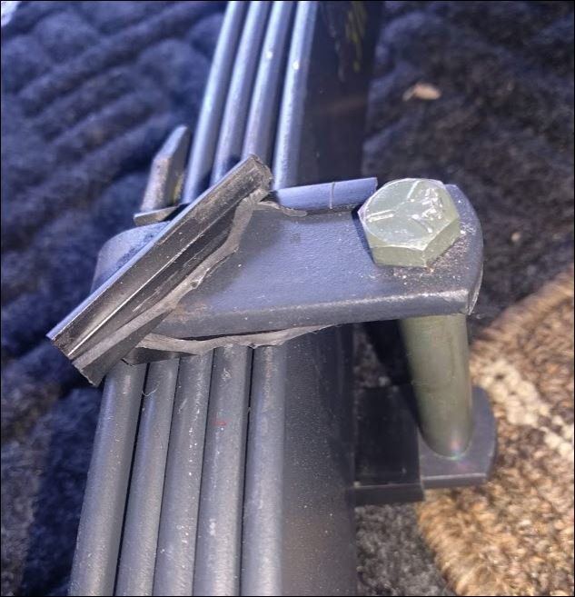

    Wheeler's replied and said they were dropping some in the mail. All good. @eon_blue I know you posted about issues with yours (spring clips - inserts), did you torque them down or just leave the clips finger tight?

    We talking about the spring clamps with the long cylindrical washers between them? Those I torqued down so that they were just over hand tight (so they wouldn't come loose on me while driving/off roading). My initial mistake was over-tightening them which caused the leafs to bind up, so you don't want them too tight. But not so loose that the bolts are going to come loose on you.

    see - thats weird too. I don't have a sleeve over those bolts. these, right?

    the trick is, do it right the first time. junk those cheap ass stock front bushings and replace them with ES bushings, junk those yellow OME bushings as well and replace them. Those inserts are just prone to breaking from what I've seen across the forum.
