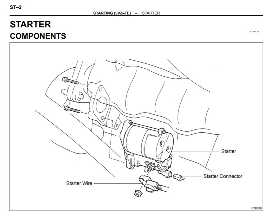

    pfft. I just looked it up - look at this poo. like its going to be this easy. what about all that crap in front of it.
    E30325[QUOTED] and cruiserguy like this.

    02 3.4 DC TRD PreRunner 4WD SWAP
    thats because your stuff shrunk. it was underwater.

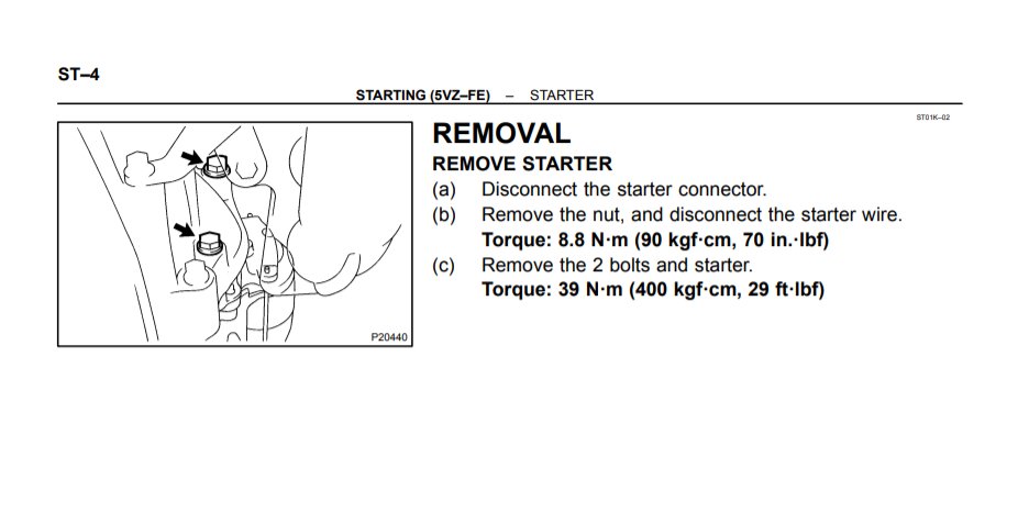

    2000 ext cab, 2.7L, auto, 4x4
    Lol that looks more like instructions out of a Haynes or Chiltons manual:rofl:

    Here's the 'component' view hahaha
    E30325 likes this.

    Lol I love when you are fighting something trying to get it out, so you look it up. “Oh it just says remove it, that sounds easy enough”
