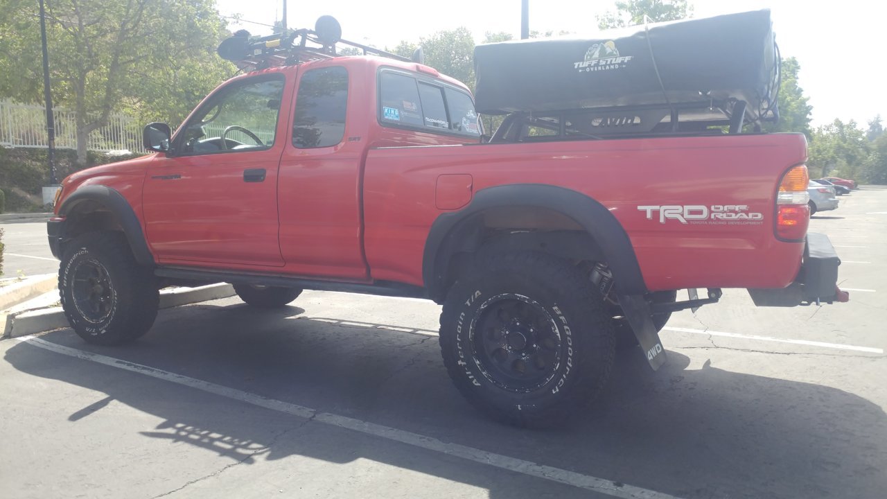

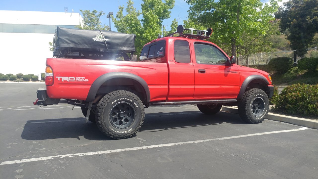

    alright well...on the drive into work this morning I heard next to none of the same sounds I was hearing last night immediately after the install. I can't help but wonder if maybe the leaf packs had to settle a bit after being disassembled and the new leafs added to them. All bolts are tight, nothing is loose...leaf packs are both centered in place on the axles (my first though was maybe the center pin popped out of place on the axle, but they're lined up). I dunno, weird but it seems to be okay now.

    Maybe just check every so many miles just to make sure but yeah maybe it was just settling.

    oh yeah definitely, I learned that the hard way after the Dakar install last time...was out on a trail kept hearing this "pop pop pop CRACK pop CRACK pop pop". Couldn't figure it out (should've looked harder) on the trail but when I got home after a 1 hour freeway drive, I saw that my front hangar bolt was holding on by just a few threads and I could remove it by hand. Coulda been way worse...it's the one that's right up against the gas tank so it's more difficult to get a torque wrench on it.

    yeah it was a lot easier this time around because I got my exhaust chopped at the axle a few weeks ago.
    Oh and I ended up removing the leaf packs to get the AALs in...no idea how you do it with them on, there was absolutely no room to work with in there. And with the axle under the packs (center pin sitting in it's hole on top of the axle), I couldn't get them to separate for the life of me unless I just took them off completely. Was way easier to pull them off and getting them back on was 10x easier this time around. At any rate, it all worked out lol.

    It was weird, with the hangar and shackle bolts still attached the bottom of the center pin didn't went to pop out of the axle. And if I was going to remove those bolts I figured I might as well just take the springs out and install the AAL on my sawhorses. Was pretty easy once I got that figured out. I'm sore as hell today though....doing leaf springs always makes muscles hurt that I didn't know I had, lol.
    Truck is sitting about a half inch higher than it was before, time will tell if it holds weight the way I need it to. It'll be better, that's for sure.
