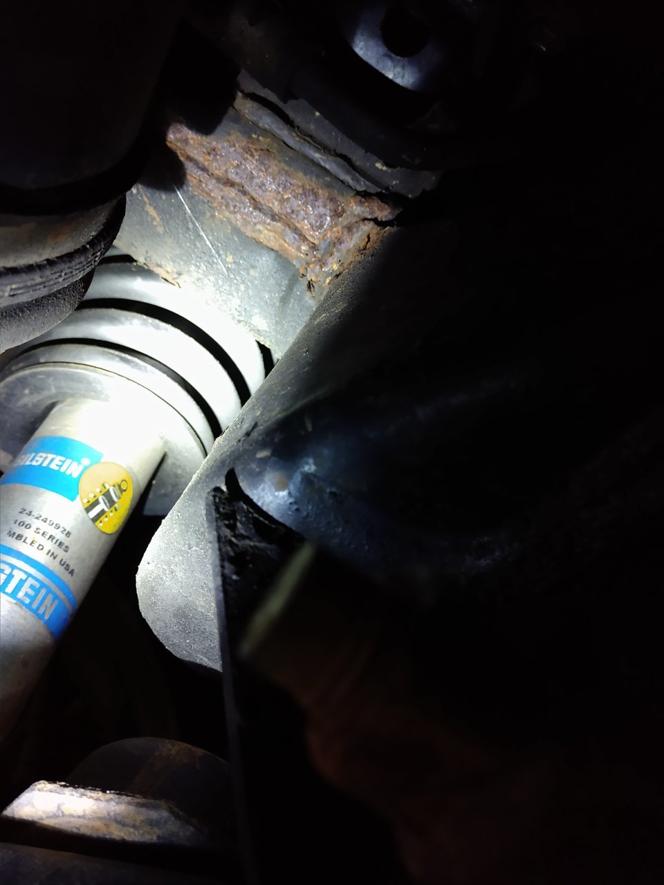

    Never seen that before. Right between the drivers CV and front crossmember. IMG_20190417_181548547.jpg

    What’re we looking at here

    the orange scaly stuff

    The one spot where its real hard to get at with a sprayer.

    frame warranty?? Being an '04, there's still a chance. Check your in-service date.

    I couldnt get a screwdriver to bust through with a hammer and it made a "good" sound when I was tapping it. Hosed it down real good with Fluid Film so only time will tell. Out of service date is this October. My thought is cause its right where all the suspension is, and along the seem it may be thicker material there.

    When you check yours, youll see that getting anything other than a screwdriver up there is pretty hard to do. If it was easier, I would wire wheel it in a heartbeat.

    That sounds like broken bushing or bolt under torqued.

    Right between the bump stops.

    Hopefully it's the bushing then because the bolt is definitely torqued, 117ft lbs according to the main eye specs

    I would take it to Toyota before you spray anything over it and see what they say, who knows you may end up getting a new frame before the deadline.
    Is it the actual frame or a part of the front cross member? Can't really tell from the pic

    The frame. Ill take it in next oil change I guess. Fluid film can be washed off with a hose sprayer.
